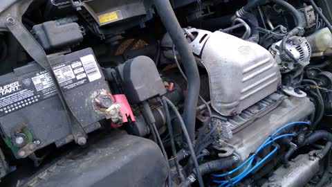

How do I replace the camshaft position sensor on the car listed above? It has code of p0340 faulty camshaft sensor. The car shut off coming down road and will not start. I know sensor location but cannot get to remove it. Thank you for helping.
Jun 4, 2020 at 5:37 AM

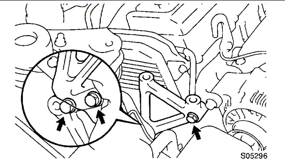

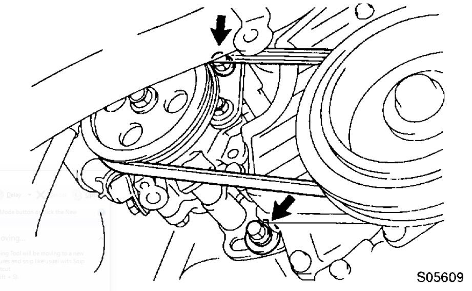

4. REMOVE PS PUMP DRIVE BELT
Loosen the 2 bolts, and remove the drive belt.

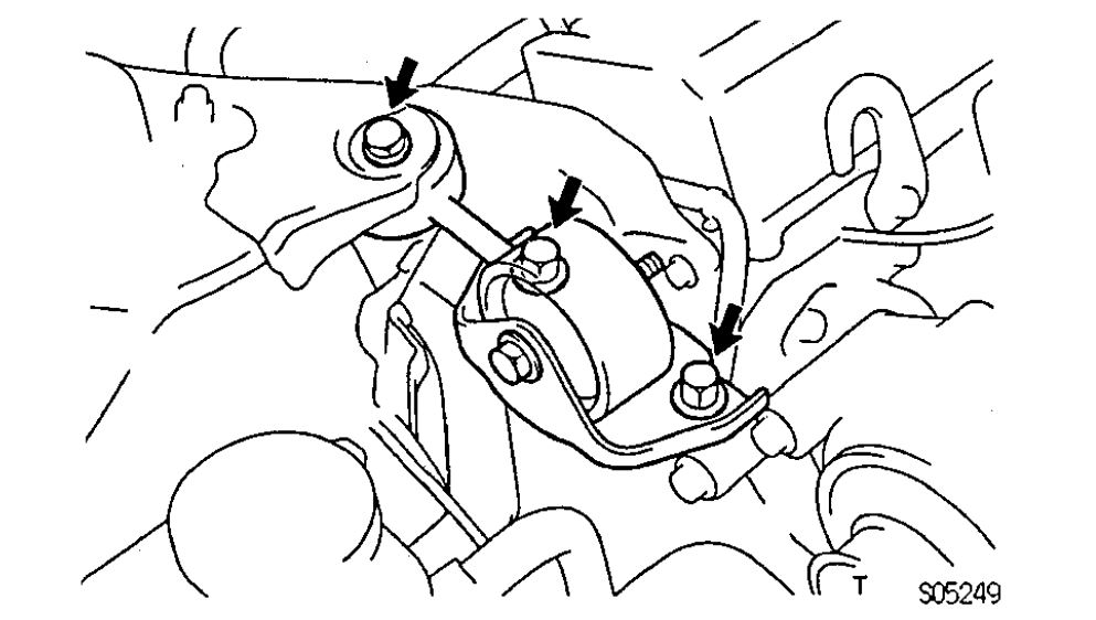

7. REMOVE NO.2 RH ENGINE MOUNTING BRACKET
Remove the 3 bolts and mounting bracket.

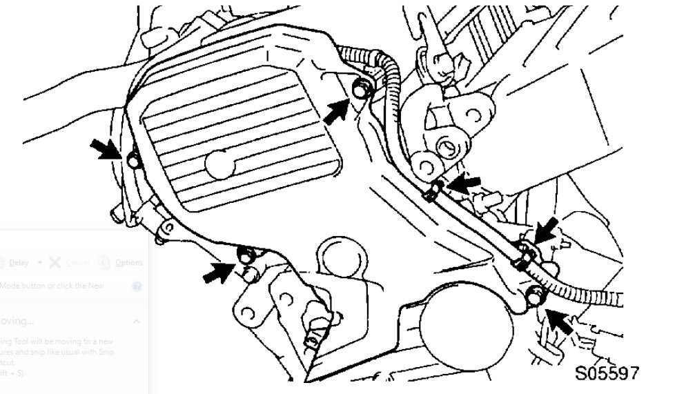

9. REMOVE NO.2 TIMING BELT COVER
a. Disconnect the 2 engine wire clamps from the timing belt cover.
b. Remove the 4 bolts and timing belt cover.

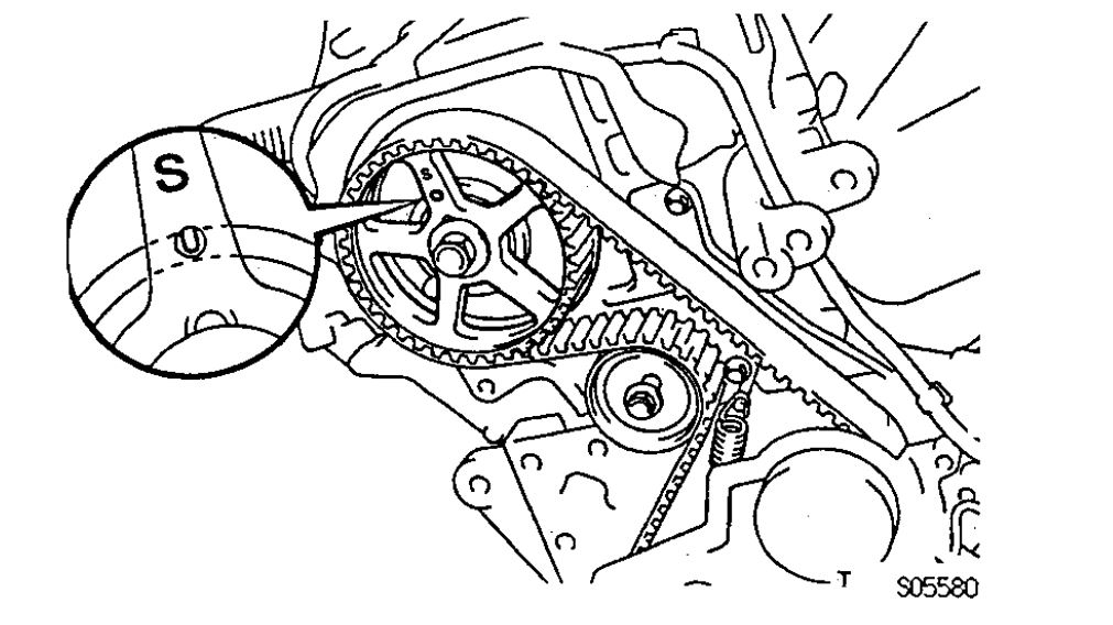

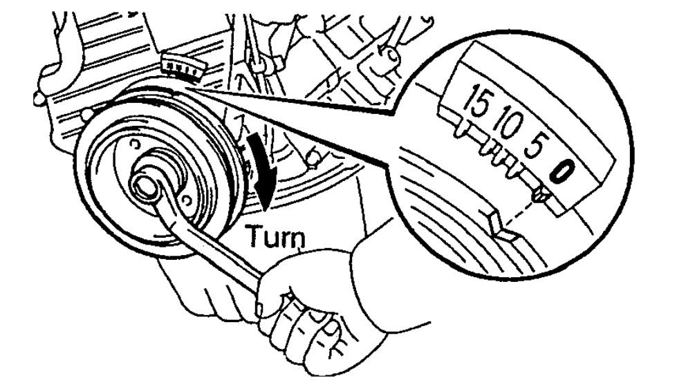

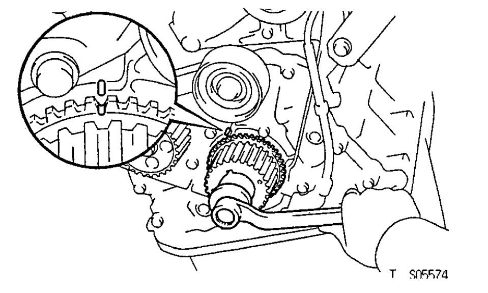

10. SET NO.1 CYLINDER TO TDC/COMPRESSION
a. Turn the crankshaft pulley, and align its groove with timing mark "0" of the No.1 timing belt cover.
Timing Belt/Camshaft Align Marks
b. Check that the hole of the camshaft timing pulley is aligned with the timing mark of the bearing cap. If not, turn the crankshaft 1 revolution (360°).

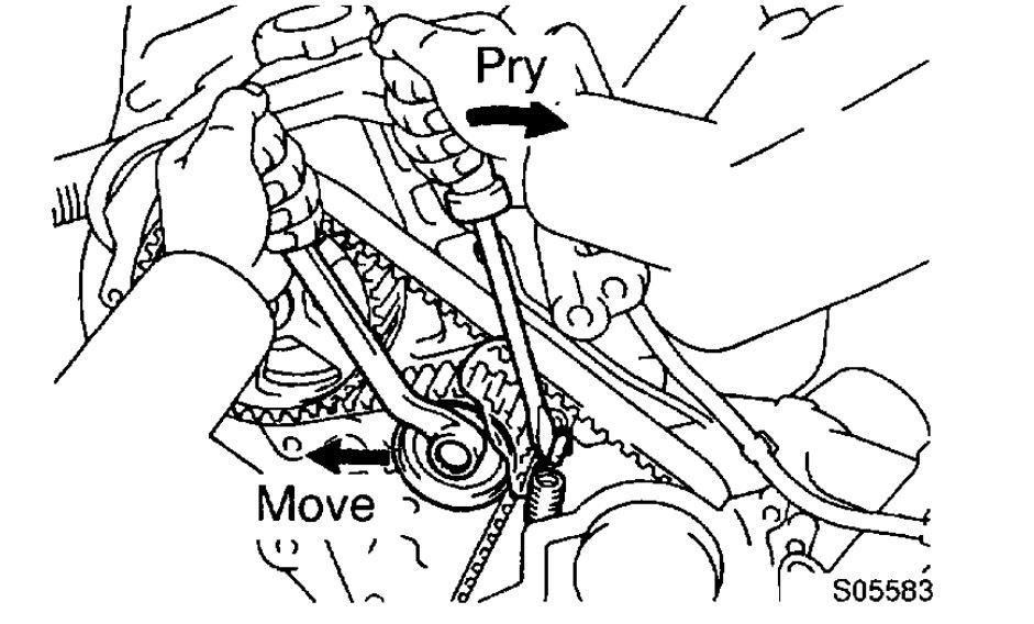

11. REMOVE TIMING BELT FROM CAMSHAFT TIMING PULLEY
HINT: When re-using timing belt: Affix the matching marks on the timing belt and the camshaft timing pulley, and the timing belt and the No.1 timing belt cover.
a. Loosen the mounting bolt of the No.1 idler pulley, and shift the pulley toward the left as far as it will go, and temporarily tighten it.
b. Remove the timing belt from the camshaft timing pulley.

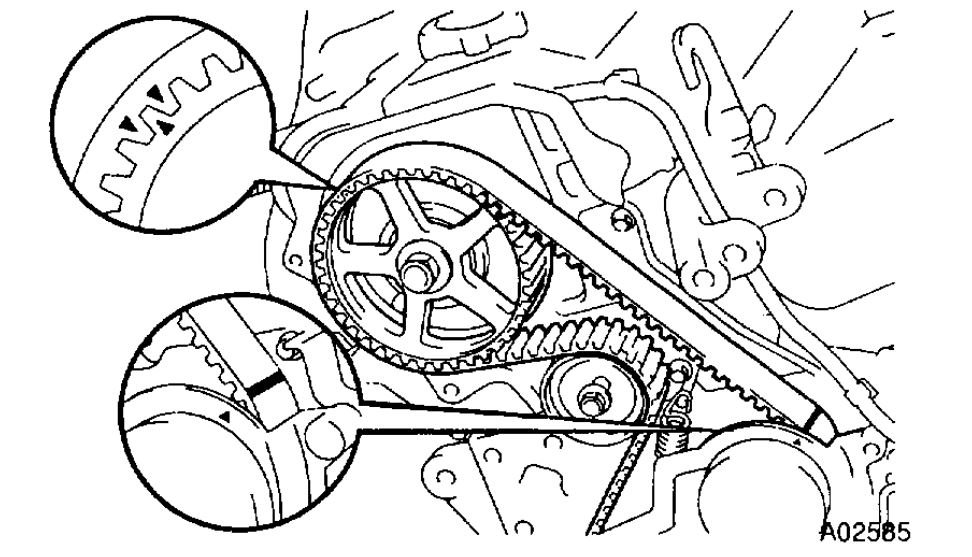

HINT: When re-using timing belt: After loosing the crankshaft pulley bolt and matching the notch of the crankshaft pulley with the "0" of the timing mark of No.1 timing belt cover, check that matching mark meets.
When matchmark is misaligned clockwise: If the matchmark does not align, align as follows:
1. Align the matchmark by pulling the timing belt up on the water pump pulley side while turning the crankshaft pulley counterclockwise.
2. After aligning the matchmark, hold the timing belt. And turn the crankshaft pulley clockwise, and align its groove with timing mark "0" of the No.1 timing belt cover.
When matchmark is misaligned counterclockwise: If the matchmark does not align, align as follows:
1. Align the matchmark by pulling the timing belt up on the No.1 idler pulley side while turning the crankshaft pulley clockwise.
2. After aligning the matchmark, hold the timing belt. And turn the crankshaft pulley counterclockwise, and align its groove with timing mark "0" of the No. timing belt cover.
