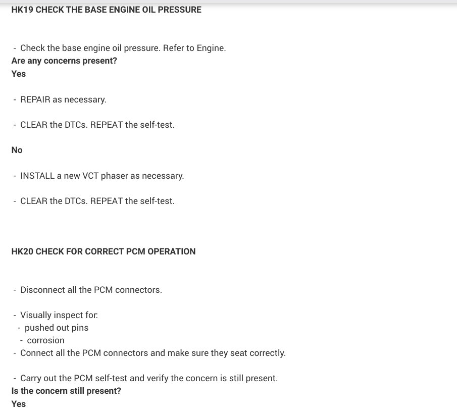

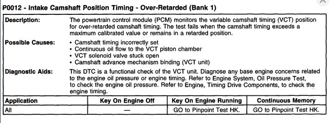

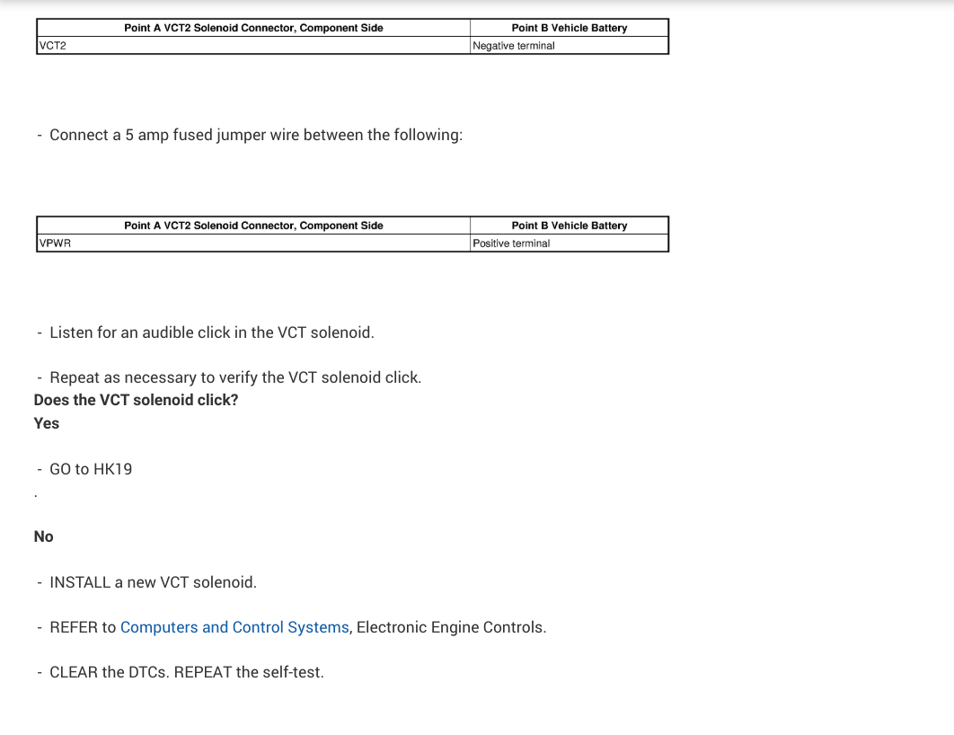

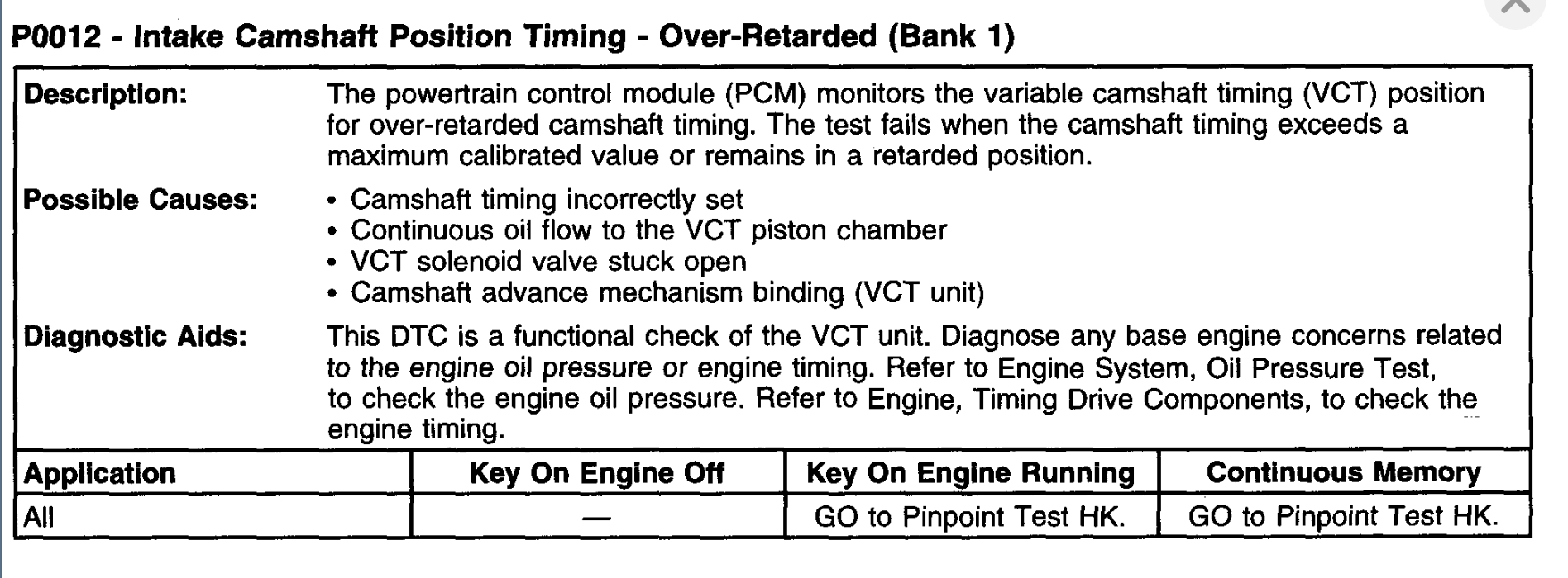

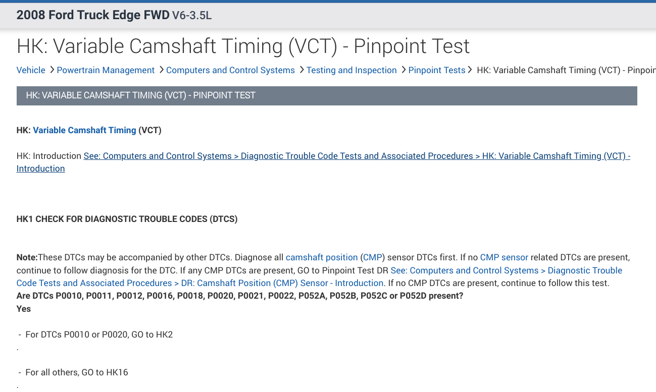

So my code is PO0012 for camshaft position sensor over retarded for bank 1. So in my car I have two. Does it matter which bank you change out?
Dec 14, 2019 at 5:55 PM
SCGRANTURISMO
  • 4,897 POSTS

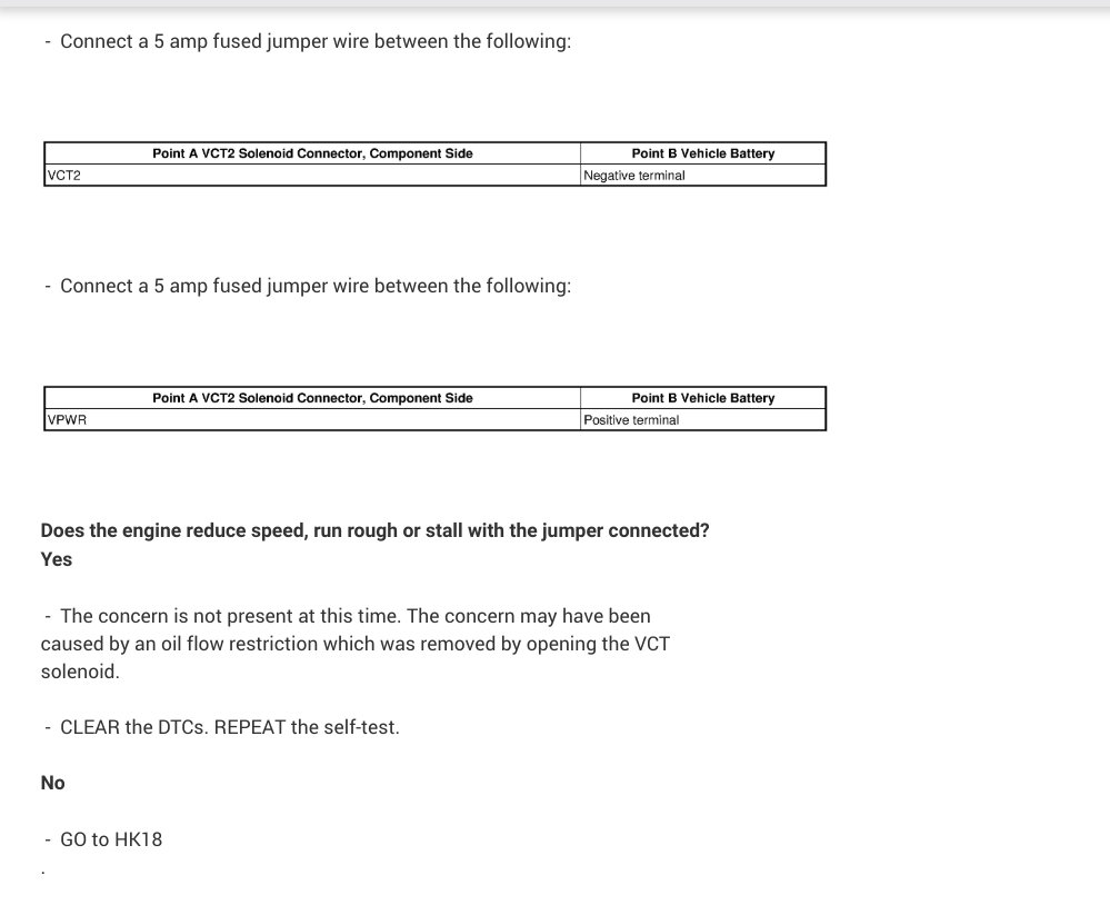

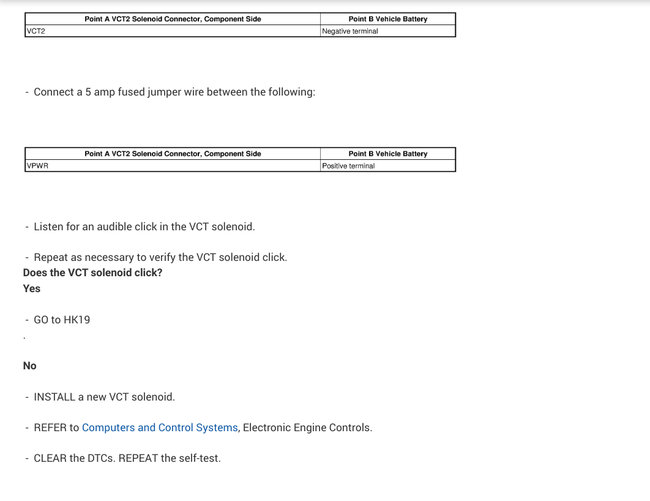

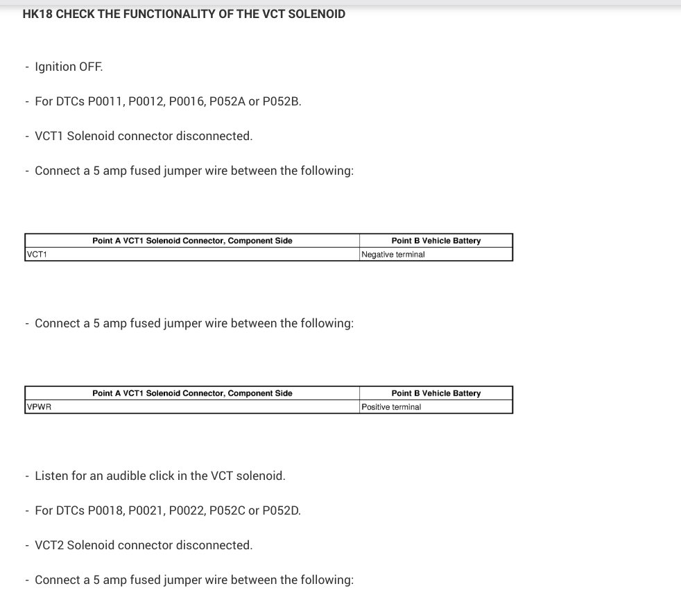

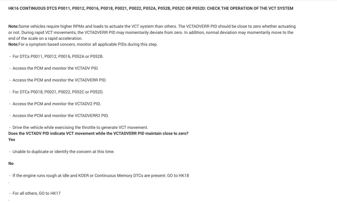

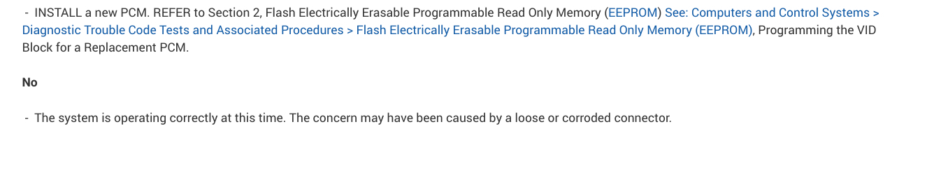

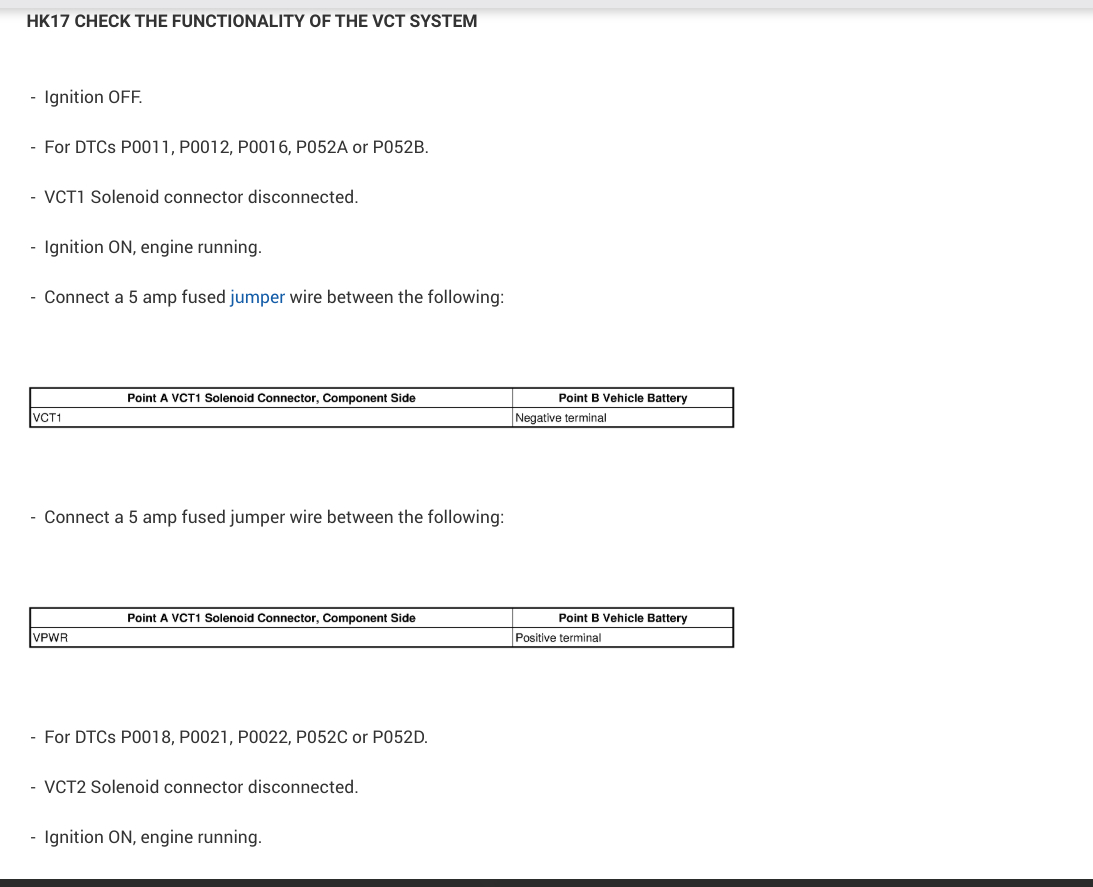

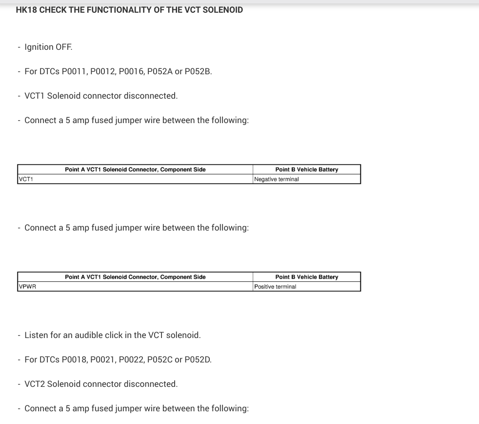

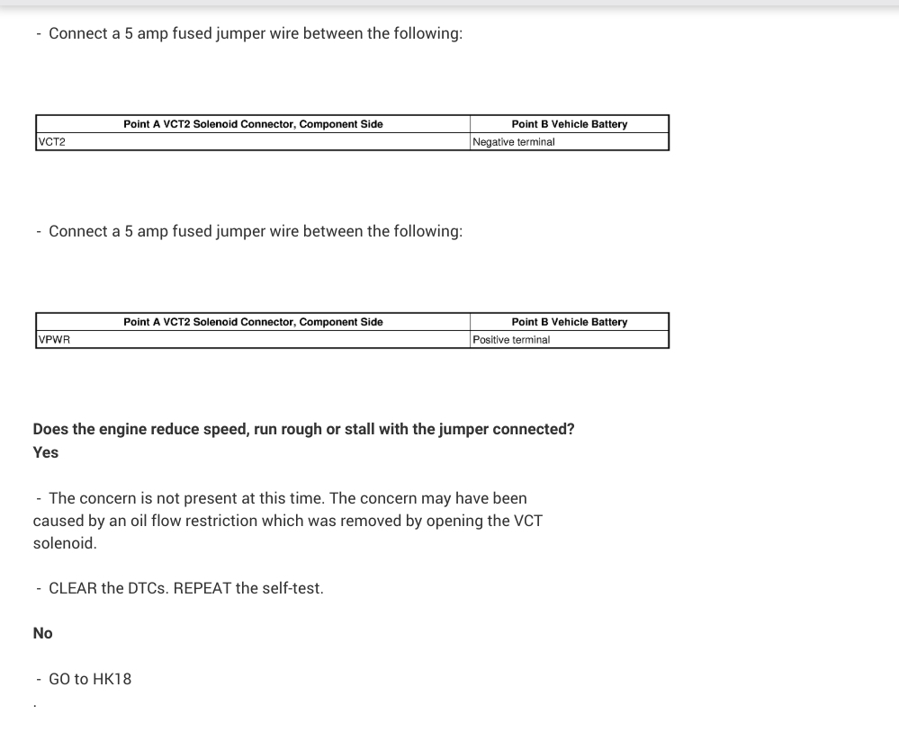

In the diagrams down below I have included the diagnostic troubleshooting flowchart from the vehicle manufacturer for your vehicle for Direct Trouble Code [DTC] P0012. This troubleshooting flowchart will call for the use of a code reader capable of reading live data PIDS. Please go through this guide and get back to us with what you are able to find out.
Thanks,
Alex
2CarPros
