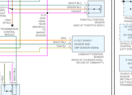

Camshaft position sensor pigtail, wiring diagram needed?
1999 PLYMOUTH BREEZE
217,138 MILES • 2.0L • 4 CYL • 2WD • AUTOMATIC
CNICHOLLS21
I had to change the pigtail to the camshaft position sensor, and i do not know what the new colors go, or how to hook up the 3 wires?
Apr 14, 2023 at 4:23 PM
  • 55,399 POSTS

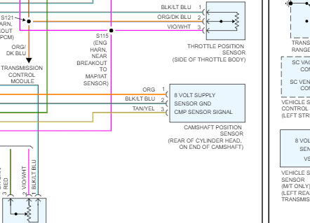

Here are the wiring configurations for the camshaft position sensor as you have requested. Check out the images (below). Please let us know if you need anything else to get the problem fixed.
