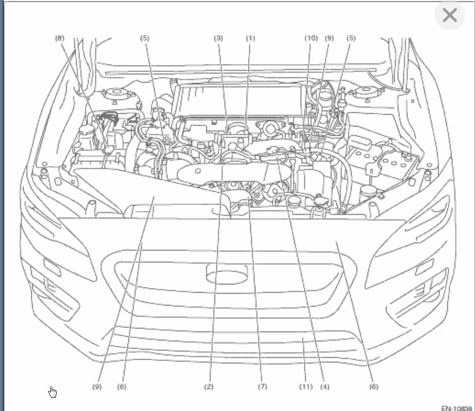

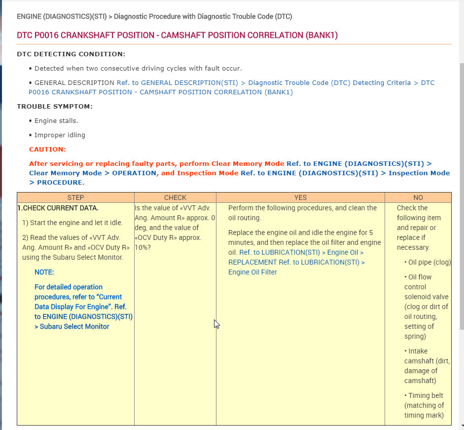

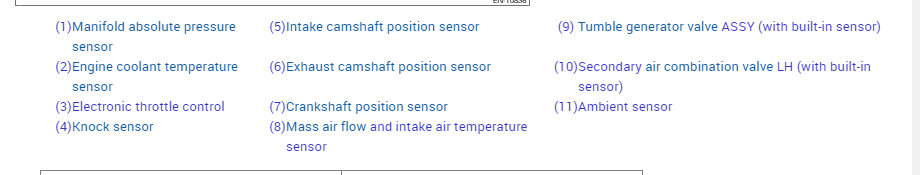

I've got P0016 with check engine light on and want to replace them. Not sure where they located. How many are them ? Thanks for your help.
Aug 29, 2020 at 3:23 PM
I attached the info. This is a code for bank 1 so you are going to be looking at the intake sensor. I also attached the location so let us know if you need more info. Thanks
