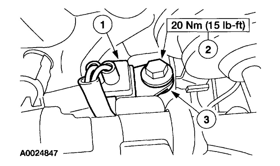

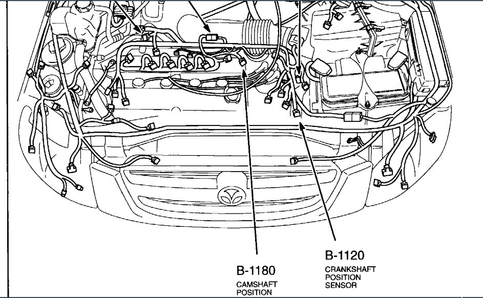

I can't find the camshaft sensor location.

Hello again,
You had for the crank sensor on the other post but now you have the cam sensor.
I attached the location and pictures for you.
1. Remove the camshaft position (CMP) sensor.
1. Disconnect the electrical connector.
2. Remove the bolt.
3. Remove the sensor.
2. To install, reverse the removal procedure.
