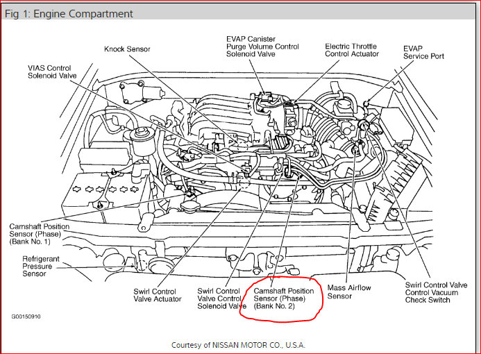

i checked an error code for P0021 and found it was the camshaft positioning sensor for bank 2. I have ordered the part but I am not quite sure where it is located at. I have had many people tell me different locations and want to make sure i pull the right one.

I have attached a picture for you and circled it in red. Hope this helps and thanks for using 2CarPros. Check out the diagrams (Below). Please let us know if you need anything else to get the problem fixed.
