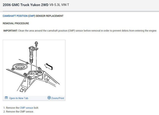

Where is the Camshaft position sensor located?
2011 GMC YUKON
218,856 MILES • 5.3L • V8 • 4WD • AUTOMATIC
CASHOUT123

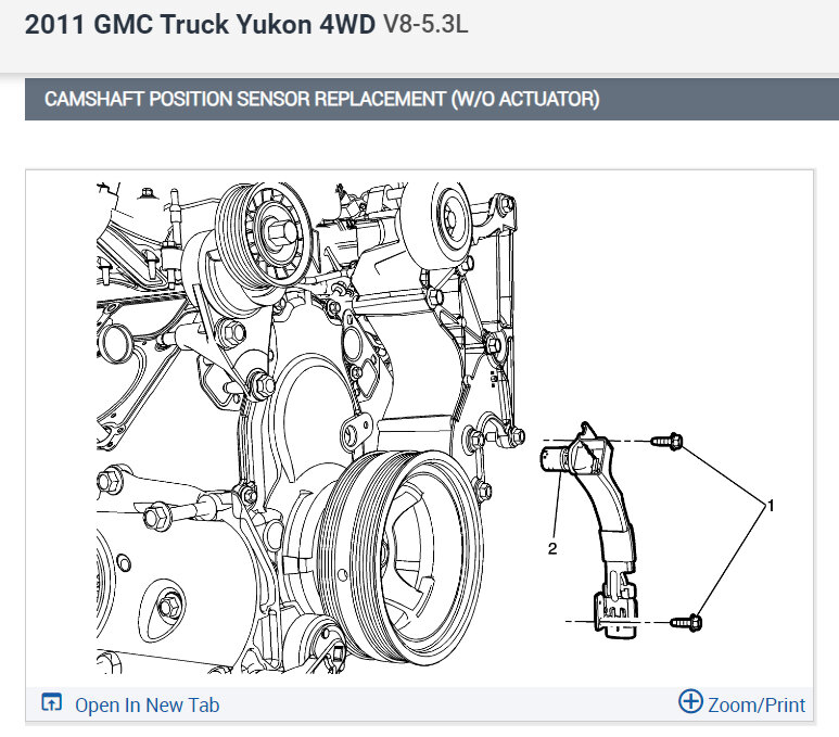

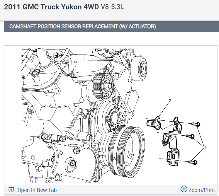

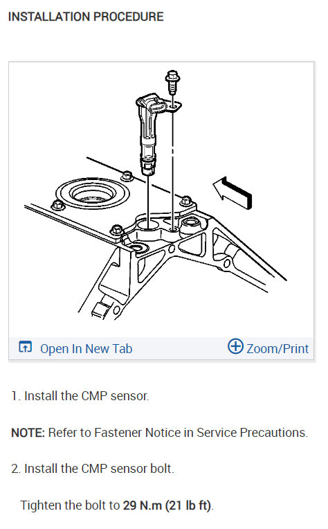

I'm wondering if maybe my truck had the engine replaced before. I bought it with one from a different vehicle because when I removed the camshaft sensor at the back of the block next to the oil sending unit, it looked completely different than all the YouTube tutorials I have watched. The replacement part from AutoZone doesn't even fit or line up to bolt in. Nor do they have one that even looks the same as the one I pulled out.
Apr 8, 2024 at 10:56 AM
  • 54,832 POSTS

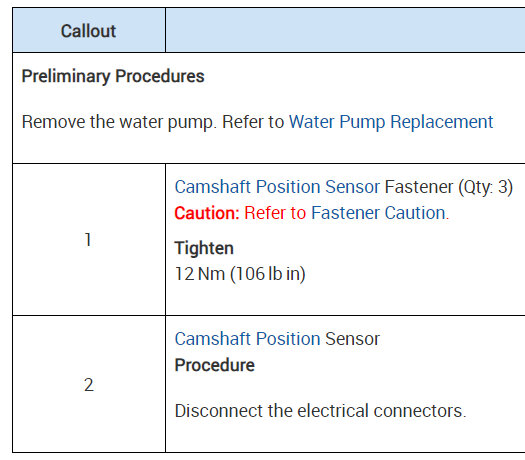

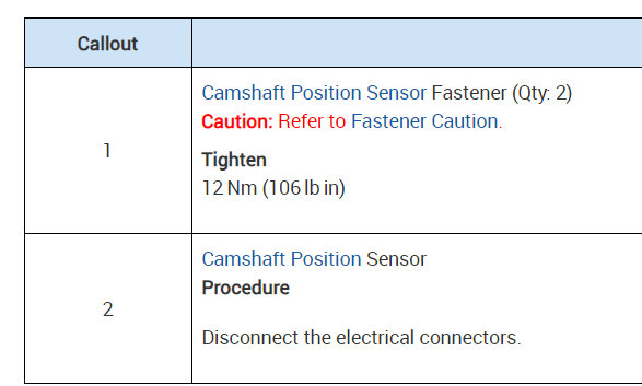

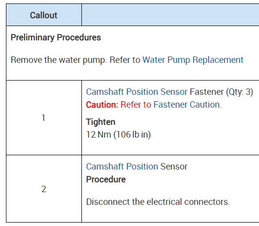

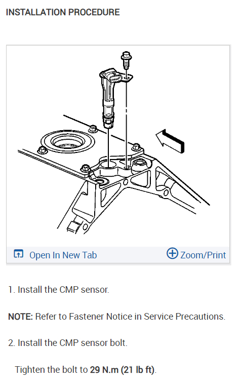

It seems like you have an older engine, here is the location of the camshaft sensor of a 2006 Yukon and the engine that is in a 2011 5.3-liter engine. Check out the images (below). Let us know if you need anything else.
