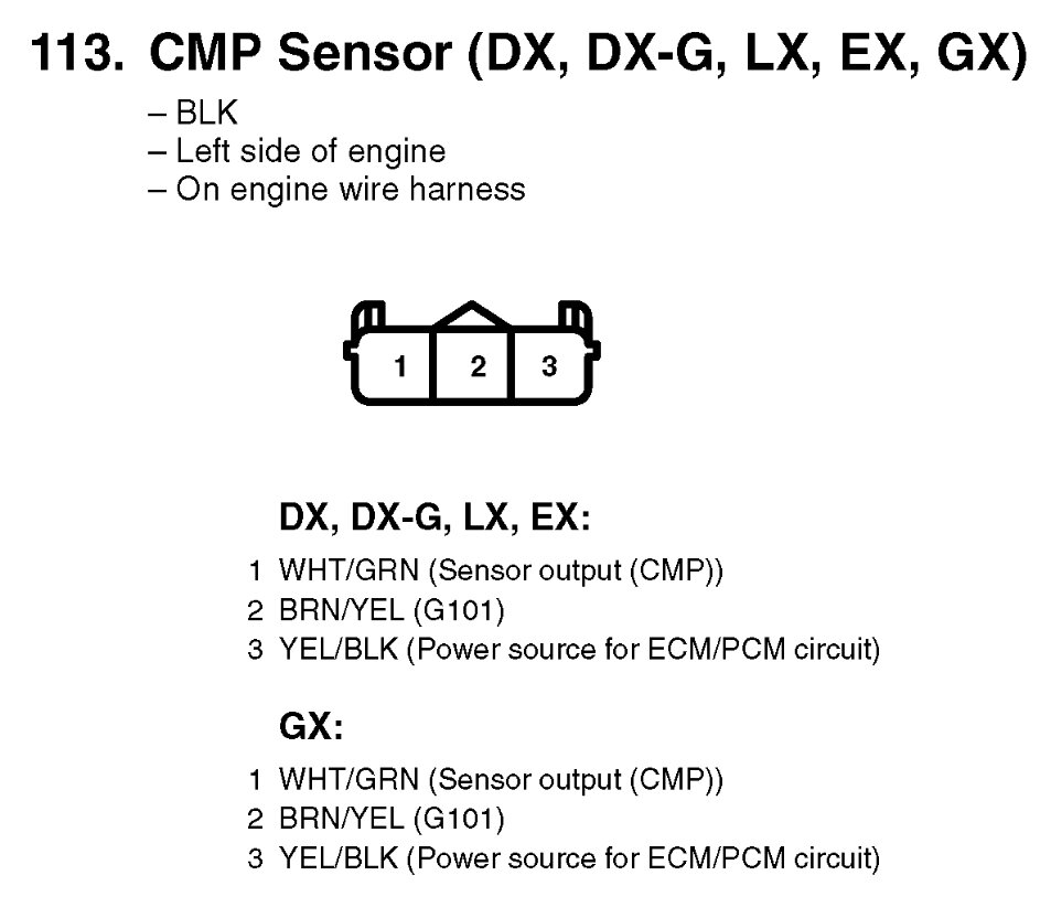

I mistakenly broke the harness wire plug of my camshaft position sensor while trying to change the sensor, I need the combination and color guide.

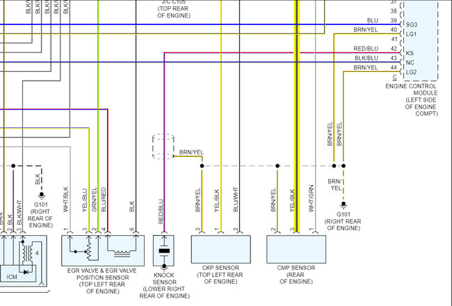

Hello, here is the harness plug for the cam sensor, plus the wiring diagrams for it. The highlighted wire Pin 3 is the power feed wire. There should be 12volts with the Key On.
