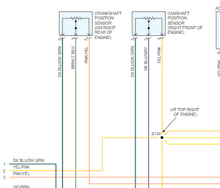

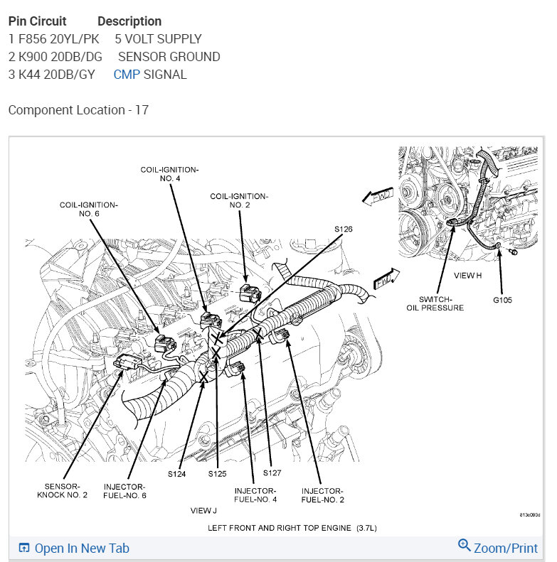

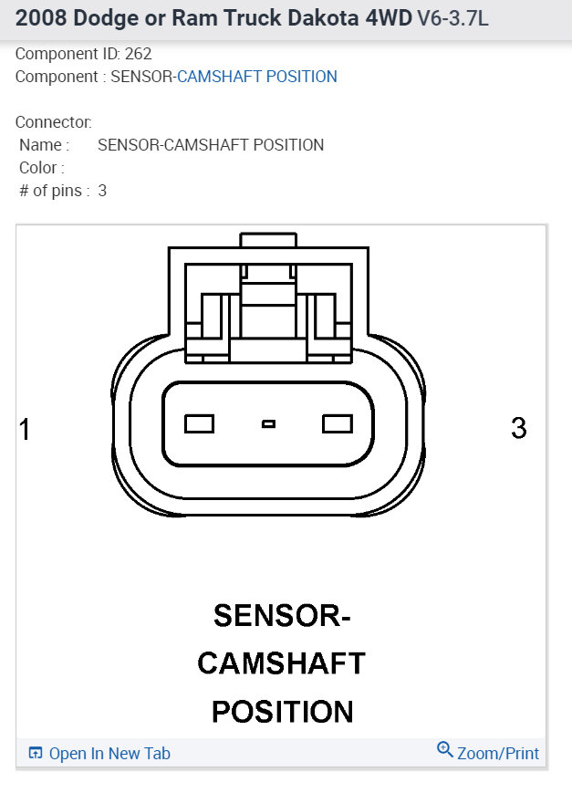

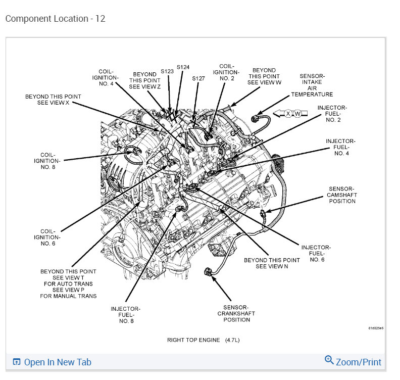

Trying to rewire my camshaft position sensor I was wondering what are the color of the wires to the connector and what position they go to on the pins.
Sep 12, 2023 at 1:48 PM
  • 55,399 POSTS
Engine size? Here is the information for the 3.6 liter v6. Check out the images (below). Please let us know if you need anything else to get the problem fixed.
