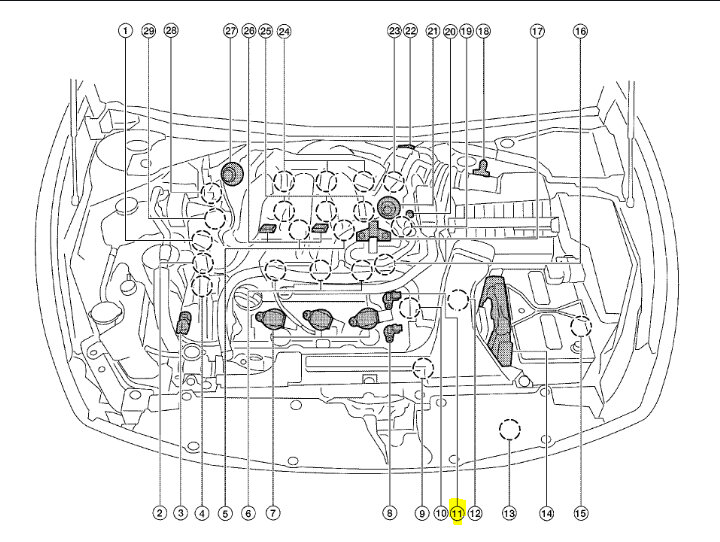

Where is the Camshaft position sensor bank 2 located?
2012 NISSAN MAXIMA
160,000 MILES
IRIAHMICHELLE
Hello, I’m trying to see where the camshaft position sensor Bank 2 is located.
Jul 5, 2023 at 8:49 PM
  • 110,194 POSTS

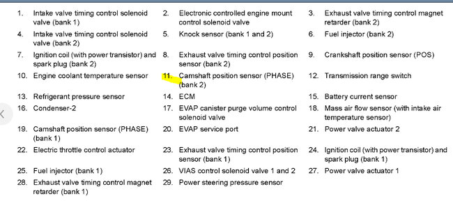

The bank two camshaft position sensor is located at the top rear valve cover on the cover closest to the radiator (front).
I attached two pics below. In pic 1, I circled the bank 2 sensor. Pic 2 provides the legend of the other items shown in the pic.
