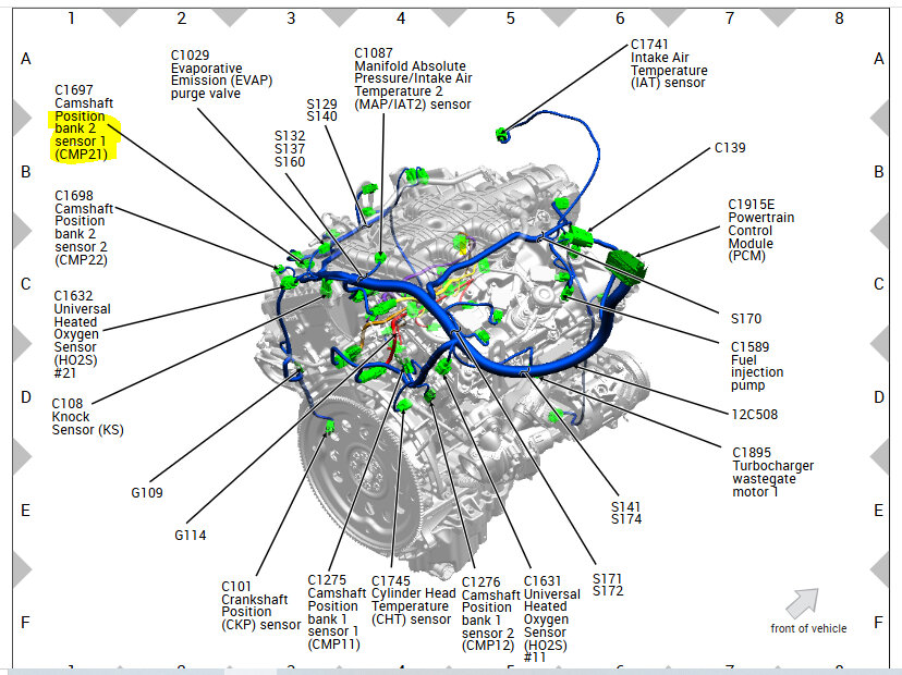

I am getting code P0345 and P0349. The code indicates Camshaft Position Sensor “A” Circuit (Bank 2). I believe there are 4 of them, I'm just not sure which one is sensor a bank 2.
Dec 14, 2024 at 4:13 PM
  • 110,194 POSTS

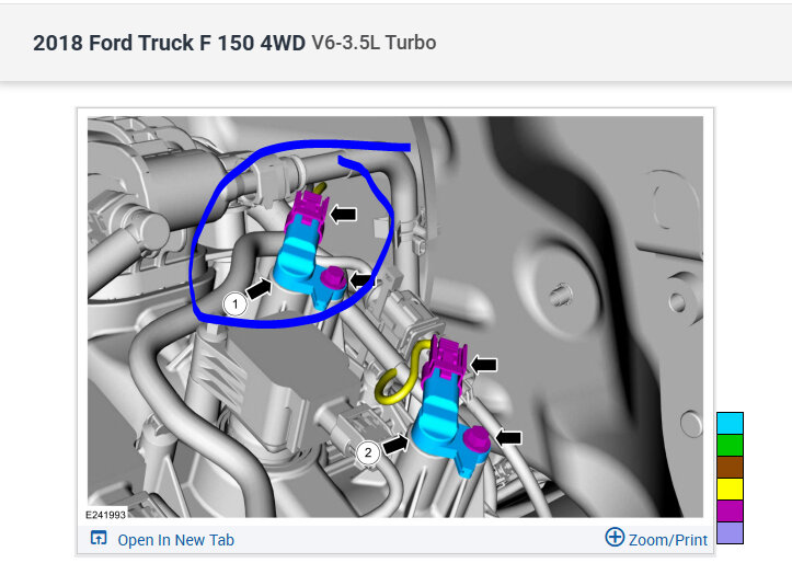

Bank 2 is on the driver's side of the vehicle. I attached two pics below. Bank 2 sensor A (1), is highlighted in picture 2 below.

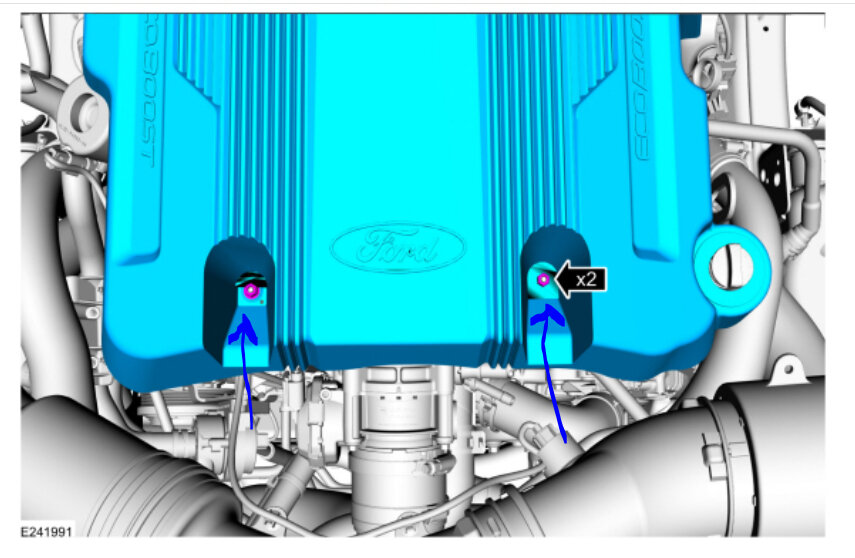

To access these, remove the cover at the top of the engine. It's held on with two nuts. See pic 3 below.
