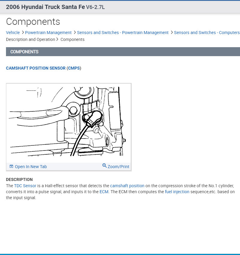

Where is the Camshaft Position Sensor A Circuit Bank 1 located?
156,000 MILES
MANAUGLE50
I need to locate the Camshaft Position Sensor.
Dec 6, 2021 at 12:04 PM
SQM
  • 6,383 POSTS

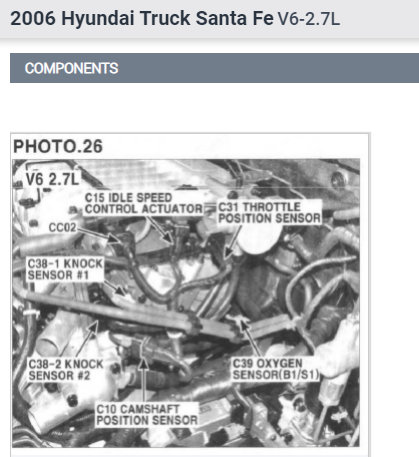

What engine does your Santa Fe have? 2.4L, 2.7L or 3.5L.
The cam sensor is located at the end of the cylinder head. I have attached diagrams for the 2.7L engine below.
https://www.2carpros.com/articles/camshaft-angle-sensor-replacement
I am assuming you have the check engine light illuminated. If so, what is the code that you are getting?
Let me know of any questions.
