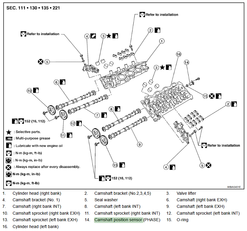

How many Camshaft Position Sensors are there?

There is one camshaft position sensor on the 2004 Nissan Titan 5.6L VK56DE. Here is the location in the image below. Can I ask what kind of problem are you having? Here is a guide that can help.

I have seen conflicting information, hence my question. Example for TWO required, with One per cylinder bank "https://www.go-parts.com/garage/ps-2004-2016-nissan-titan-engine-camshaft-position-sensor" which may generate P0340 for Bank 1 and P0345 for Bank 2.

Nope, that is incorrect, there is only one, here is the wiring diagrams for the 2004 Nissan Titan so you can see for yourself.

Thank you! I appreciate the wiring diagram confirmation. This is for my son’s pickup and I have not had a chance to physically inspect it. This will allow me to order the ONE camshaft sensor.

FOLLOWUP: I finally located a copy of the 2004 Nissan Titan Service Manual ‘Engine Mechanical Section’ diagram. This diagram confirms that there is only ONE Camshaft Position Sensor. It is located at the REAR of the engine on the left bank (driver’s side) and annotated “14” on page EM-43.

Yep, that matches the diagram I provided above, nice to have confirmation. Thanks for letting us know.
