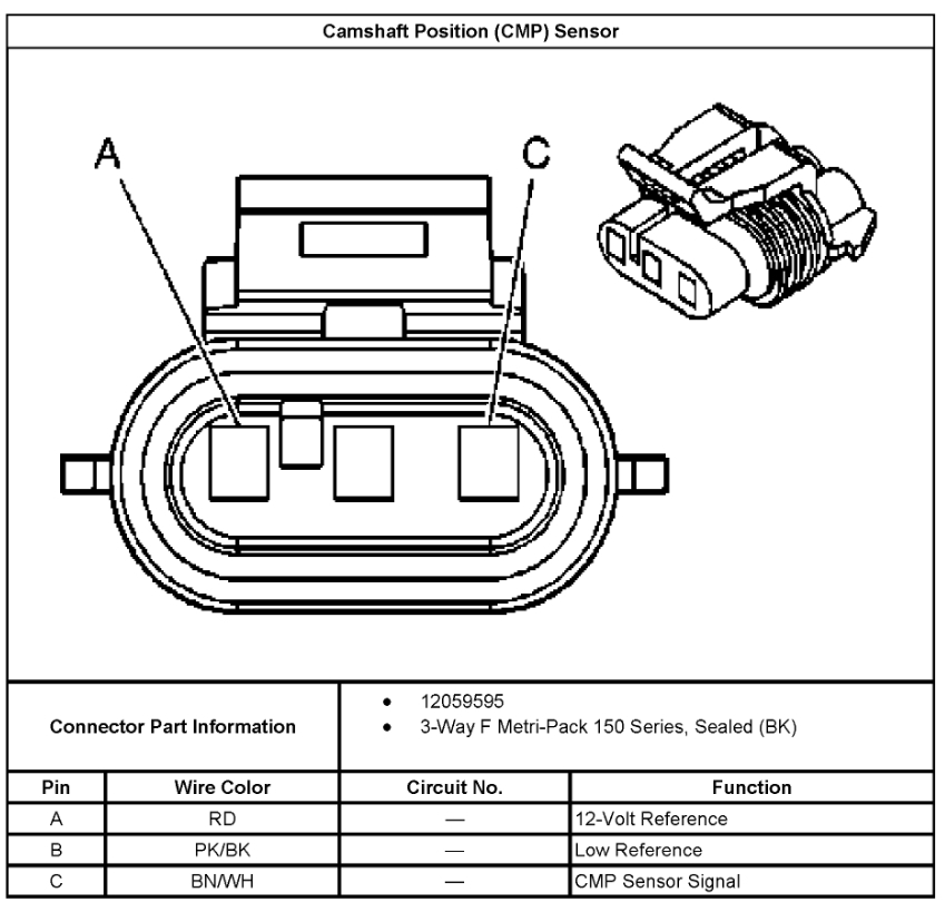

My pigtail for my camshaft is completely missing. I've been trying to find out how to wire one in, so I don't have to buy a new harness.

Sure, here is the pigtail for the camshaft position sensor for $8.00 and how to wire it up:
https://amzn.to/3YbZ285
Check out the images (below). Let us know if you need anything else.
