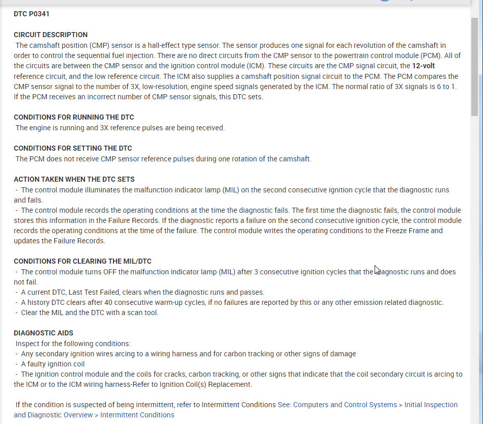

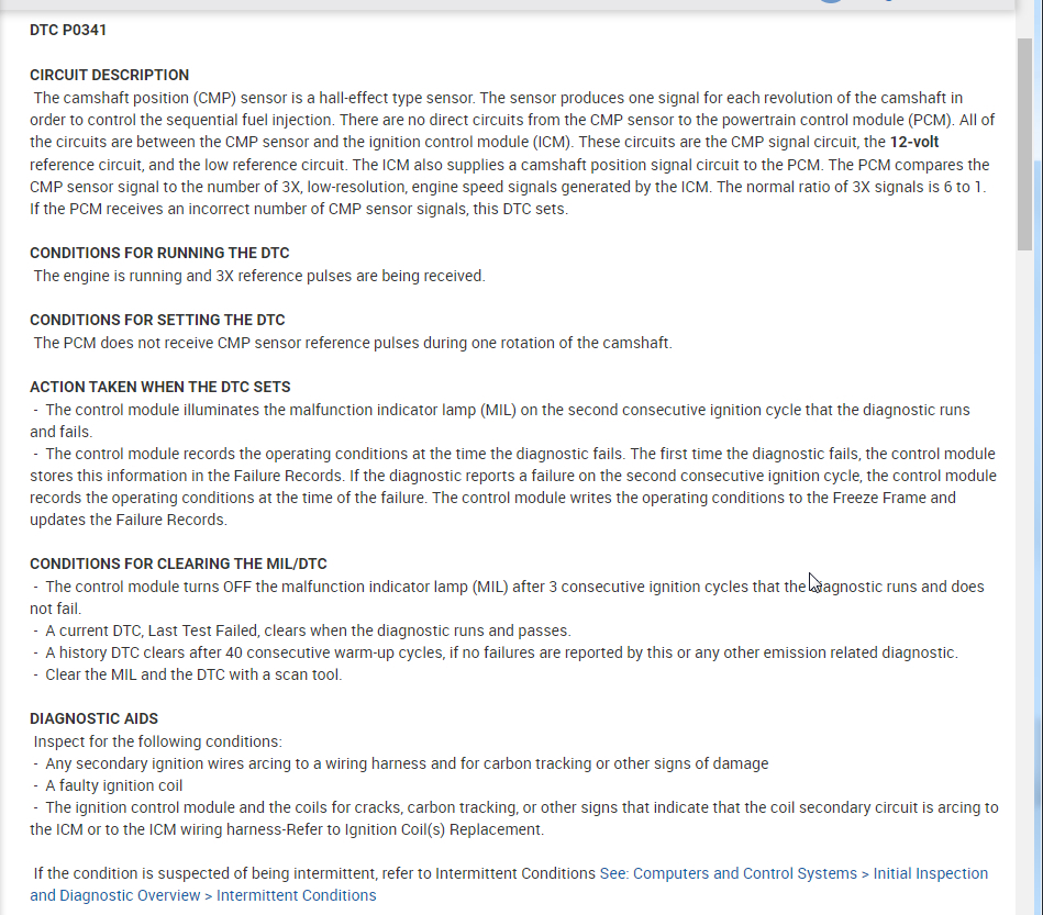

I have replaced my camshaft position sensor 5 times in 5 days. I changed the wires and it still goes out. what could be the problem?
Dec 23, 2020 at 8:48 PM

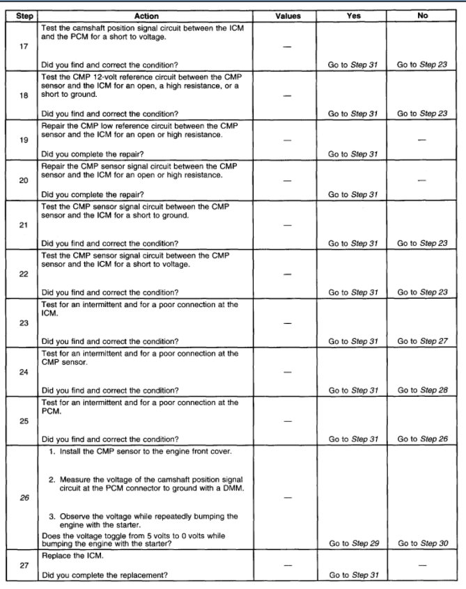

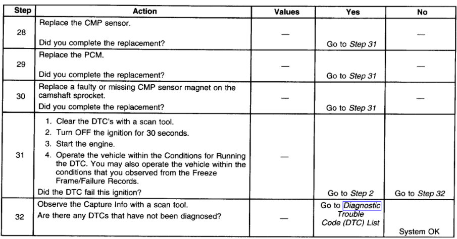

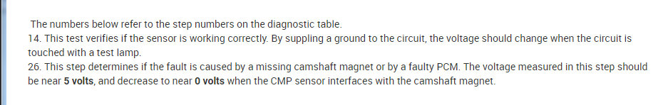

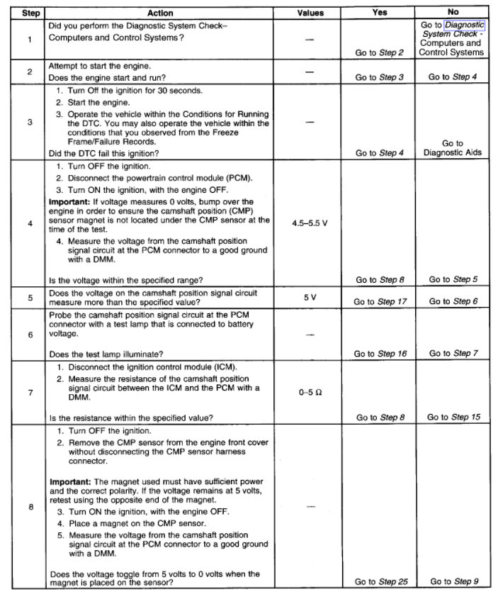

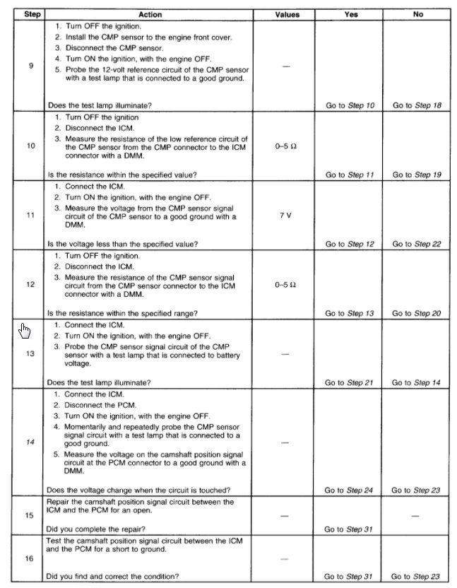

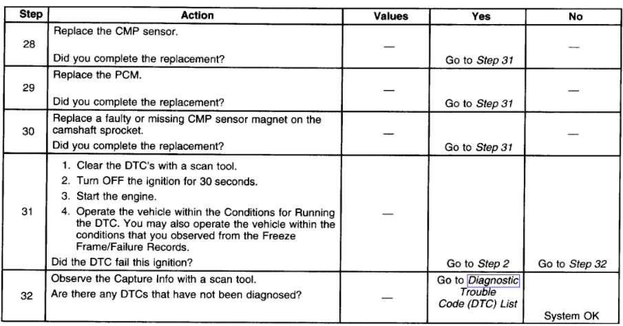

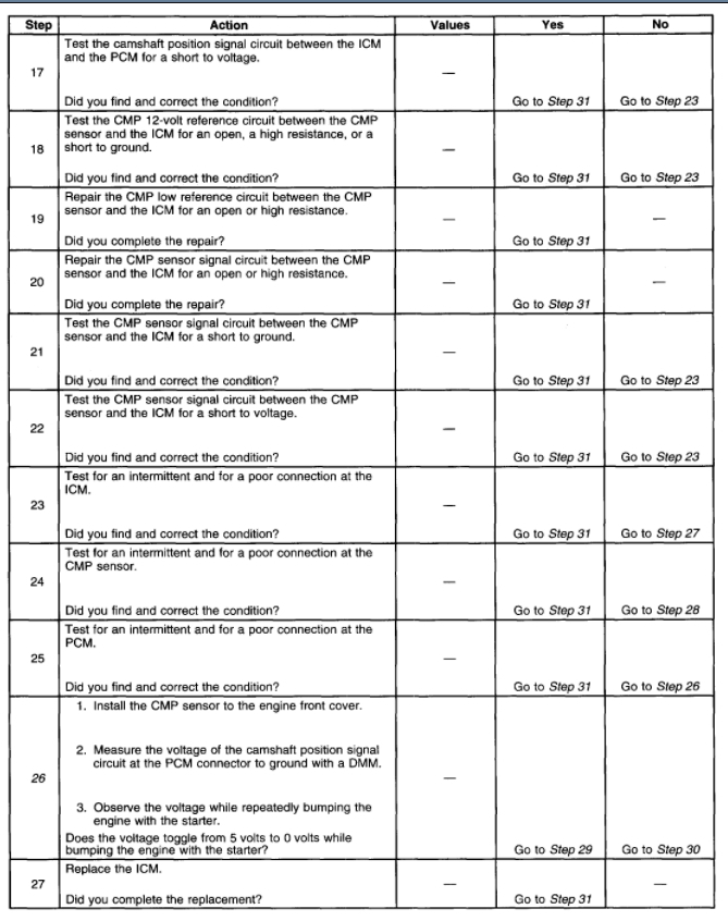

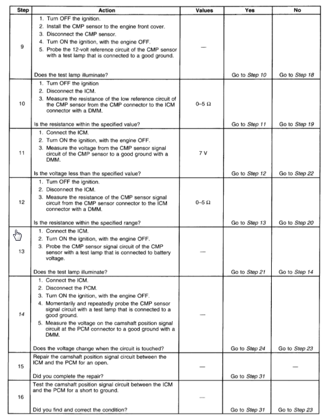

Is there a code that you are getting that is pointing you to replace the cam sensor? Clearly I assume it is the P0341 and if it is, I attached the testing below for this code. We need to run through this and find out what the issue is.
Here is a guide that will help with this type of testing:
Let's run through this testing and that will tell us what the issue is. Let us know if you have questions. Thanks
