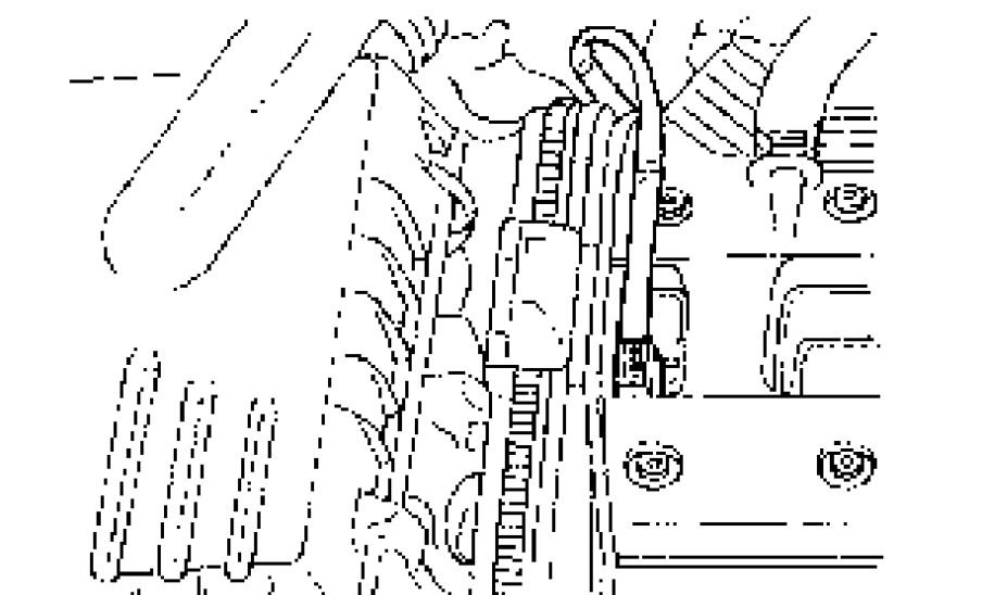

Where is the camshaft position sensor located on the car listed above? Is there a diagram? I cannot find any YouTube vidoes, etc. that will teach me how to replace it?

The cam sensor is on the top of the motor towards the passenger side of the valve cover. it is accessible once you remove the top plastic cover.
Attached is a picture for you to view. it is a little grainny but it is the only sensor there.
