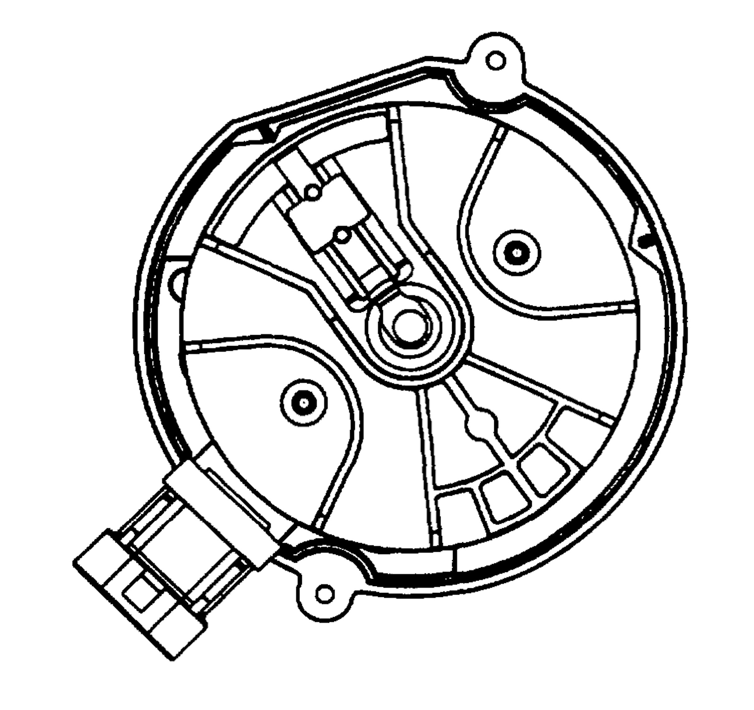

I'm chasing a random misfire issue and need to replace the entire distributor. Perhaps my question is better asked as what relearn is required after a complete distributor replacement?

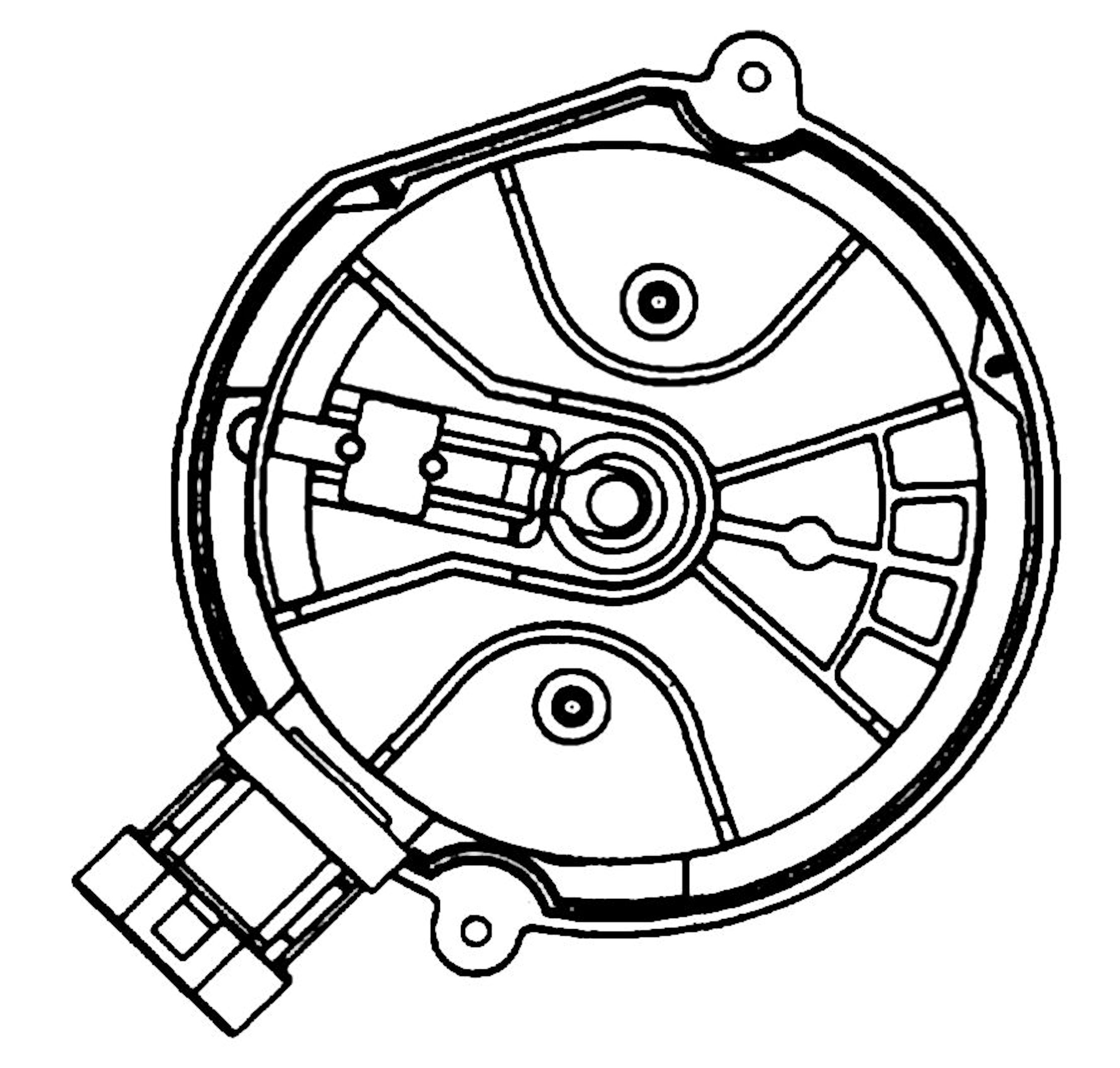

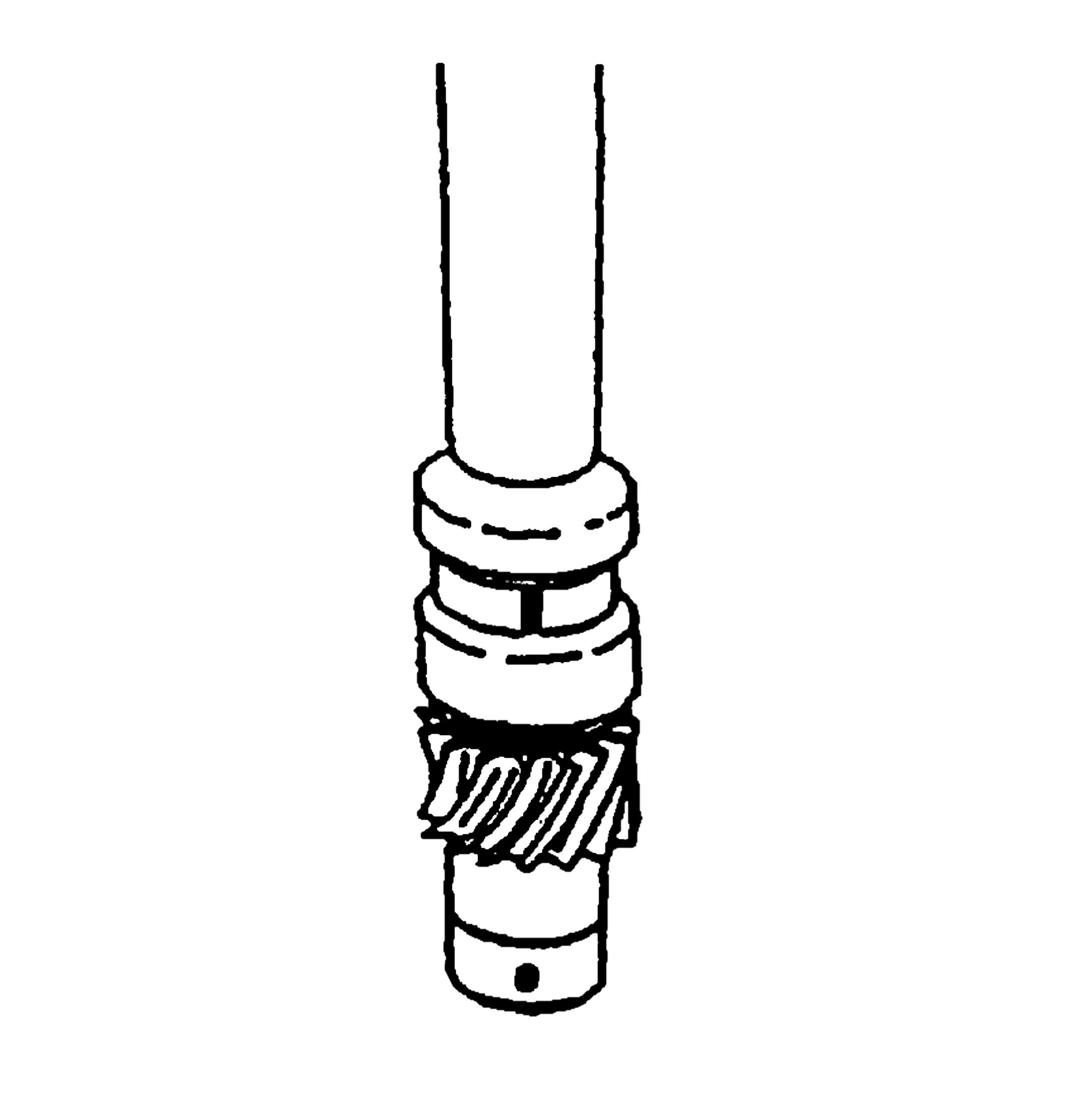

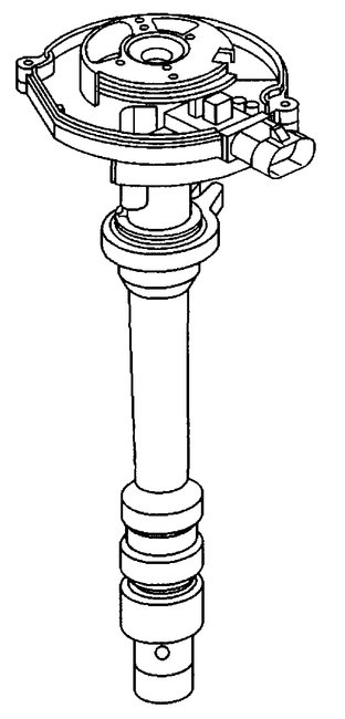

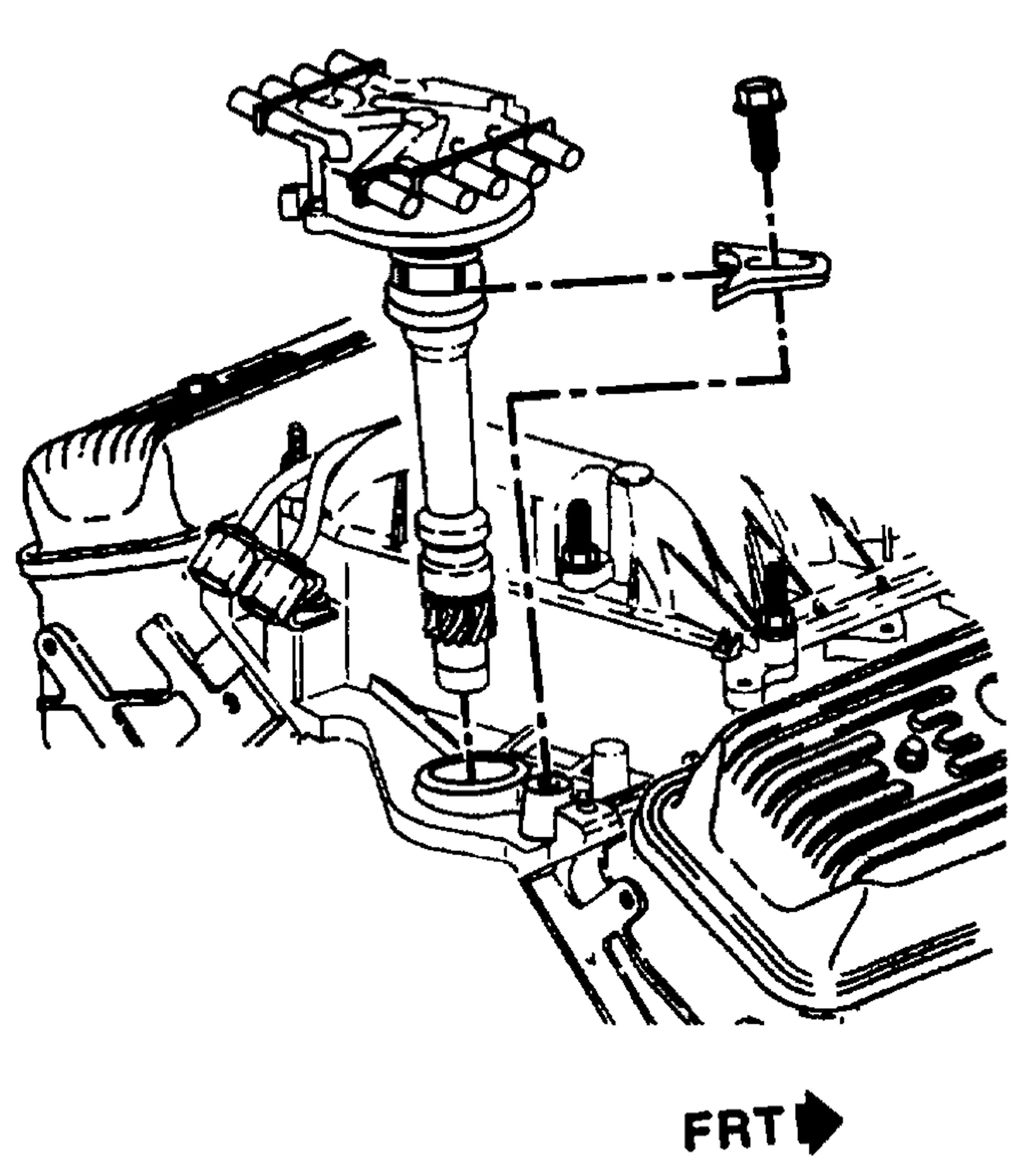

There really isn't a relearn. Here are the directions for removal and replacement of the distributor. The attached pics correlate with the directions.

pic 1
Remove or Disconnect
- Make sure the ignition switch is "OFF".
NOTICE: If the distributor is removed from the engine, it can be re-installed using "procedure A" as long as the crankshaft has not rotated from its initial position. If the intake manifold, cylinder head, crankshaft, camshaft, timing sprocket or complete engine was removed or replaced, "procedure B" must be followed to correctly install the distributor. A DTC code may also indicate an incorrectly installed distributor and engine or distributor damage may occur. Procedure B must then be used.
Procedure A
1. Spark plug and coil leads from the distributor cap.
2. Three wire hall effect switch connector from the base of the distributor.
3. Two screws holding the distributor cap to the housing.
4. Distributor cap.
a. Use a grease pencil to note the position of the rotor segment in relation to the distributor housing. Identify the mark with a 1.
b. The distributor housing and intake manifold should also be marked with a grease pencil for proper alignment when reinstalling.
5. Mounting clamp hold down bolt.
6. Distributor.
- As the distributor is being removed from the engine, you will notice the rotor move in a counter-clockwise direction, 42 degrees. This will appear as slightly more than one clock position. Noting the position of the rotor segment, by placing a second mark on the base of the distributor, will aid in achieving proper rotor alignment during distributor installation. Be sure to identify the second mark on the base with the number 2.
Distributor Installation And Removal (5.0L And 5.7L)
pic 2
Rotor Position (5.0L, 5.7L And 7.4L)
pic 3
Installed Rotor Position
pic 4
Distributor Alignment Indicator
pic 5
Install or Connect
A. If the original distributor is to be replaced, rather than repaired, remove the new distributor cap. Using a grease pencil, place two marks on the new distributor housing in the same location as the two marks on the original housing.
B. When installing the distributor, align the rotor segment with the number 2 mark on the base of the distributor. Guide the distributor into place, making sure the grease pencil marks on the distributor housing and the intake manifold are in line. As the the distributor is being installed, you will notice the rotor will move in a clockwise direction, 42 degrees. ONCE THE DISTRIBUTOR IS COMPLETELY SEATED, the rotor segment should be aligned with the number 1 mark on the base. If the rotor segment is not aligned with the number 1 mark, the gear teeth of the distributor and camshaft have meshed one or more teeth out of time. To correct this condition, remove the distributor and re-install it following the procedure at step B.
