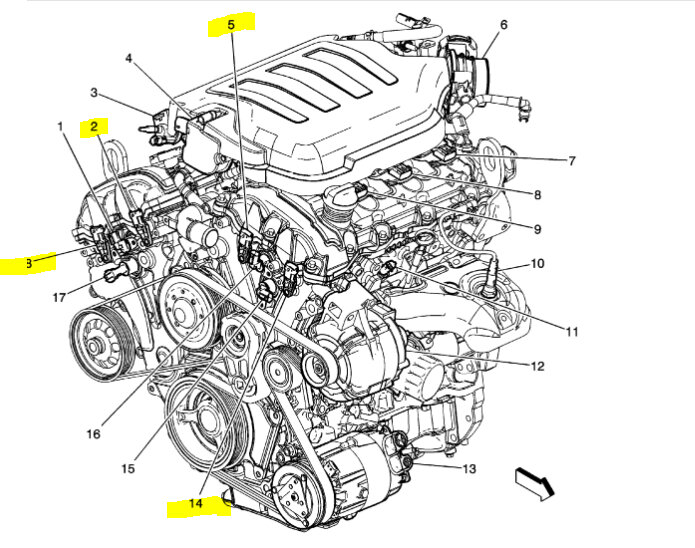

Codes p0390, P0365,P0345,P0341,P0340.
I have the car listed above LTZ, can you please help with diagram of location? And let me know what fuses to check or what to do first.

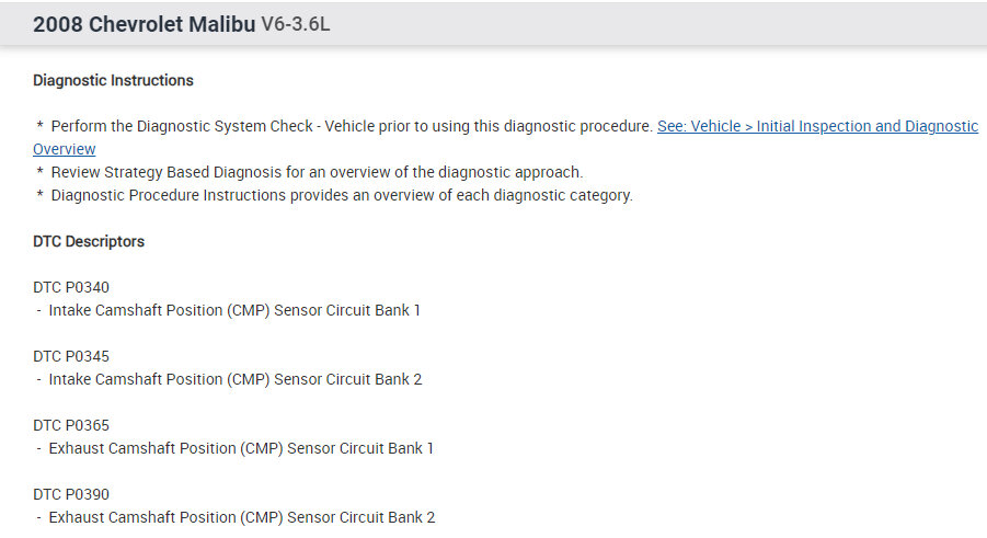

The codes indicate a problem with each of the four camshaft position sensors (see pic below). Did these all set at once? How is the engine presently running? Is the engine oil clean and full?
Also, has anything ever been done with the timing chains? This vehicle has three of them. There is a primary and two secondary chains. If these all set at the same time, there is a chance the primary is off.
Pic 2 shows the locations of the 4 sensors.
