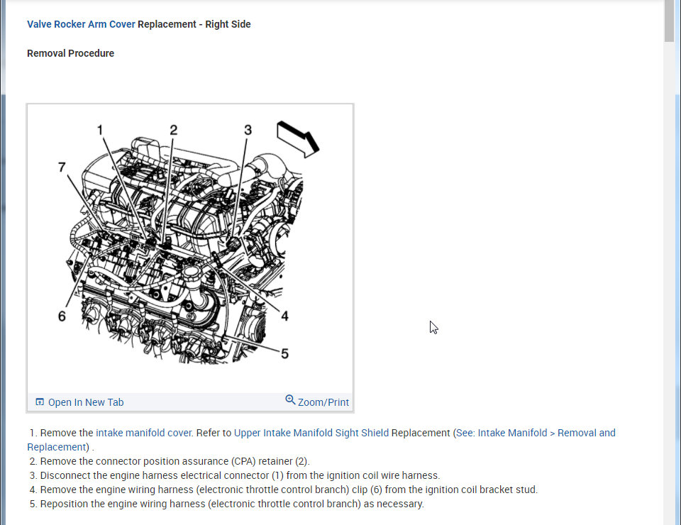

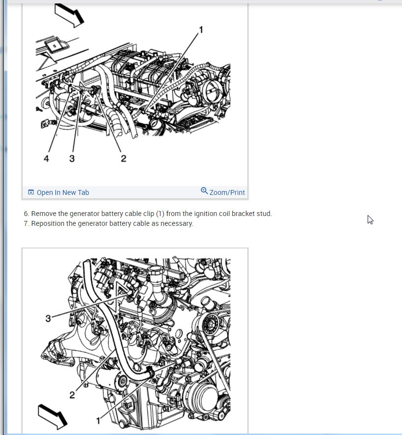

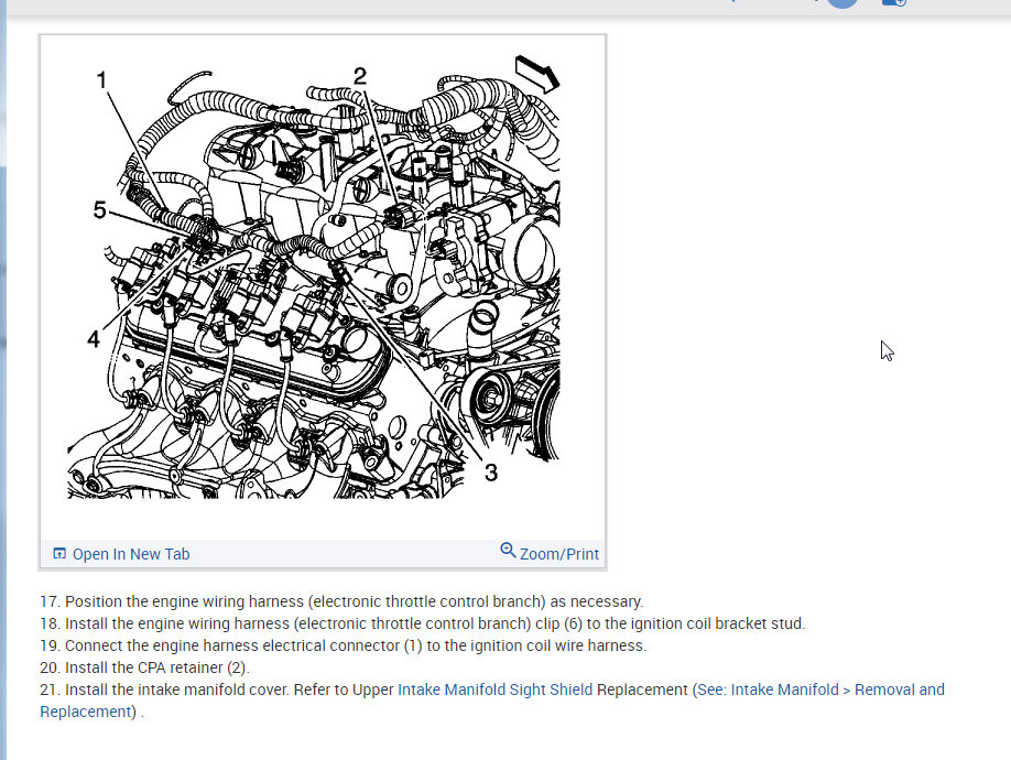

The back end of the sensor broke off and pieces are inside. What do I do?
Mar 21, 2021 at 10:08 AM

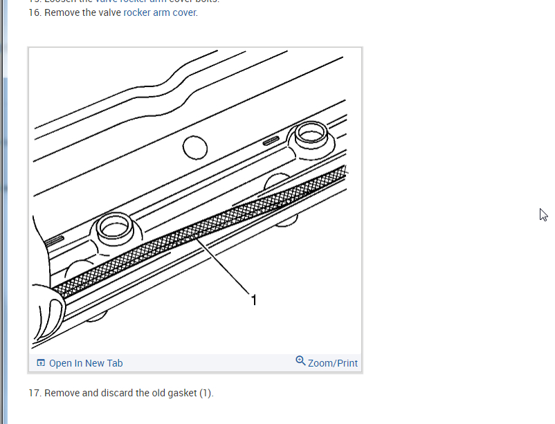

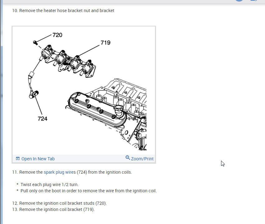

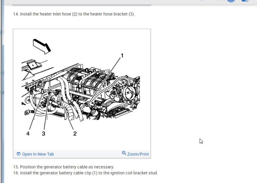

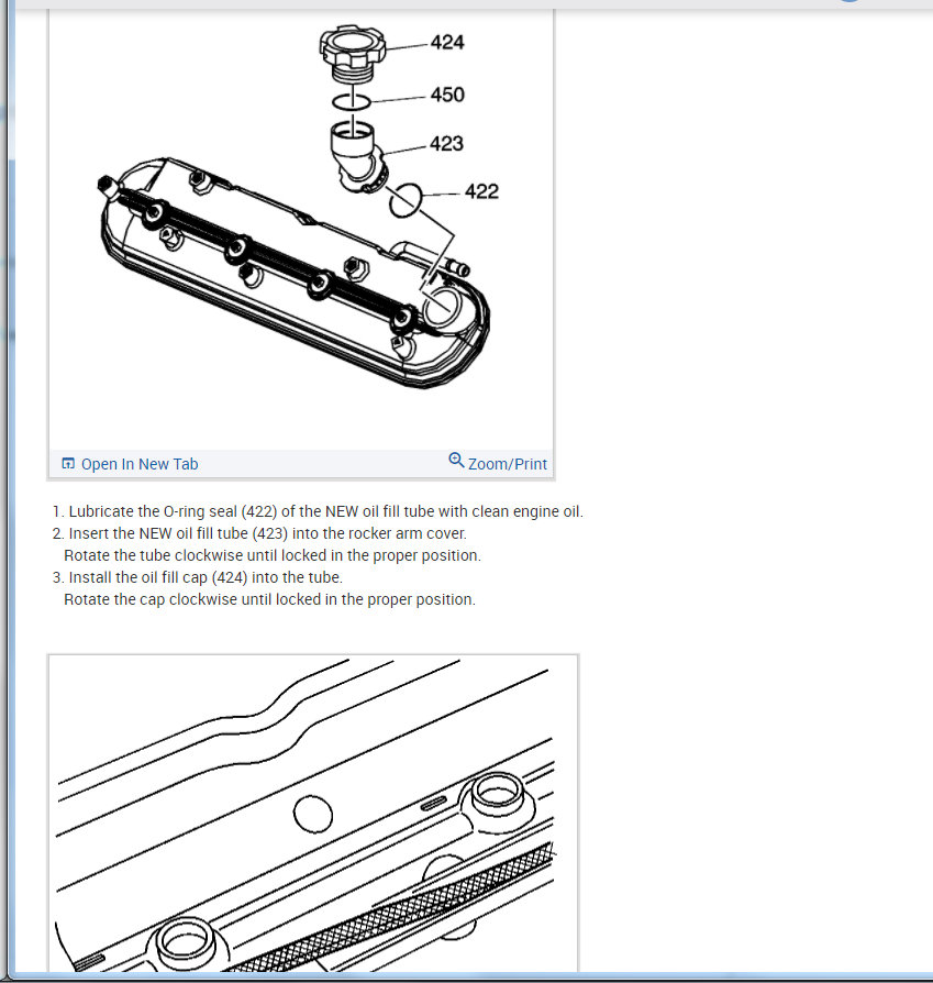

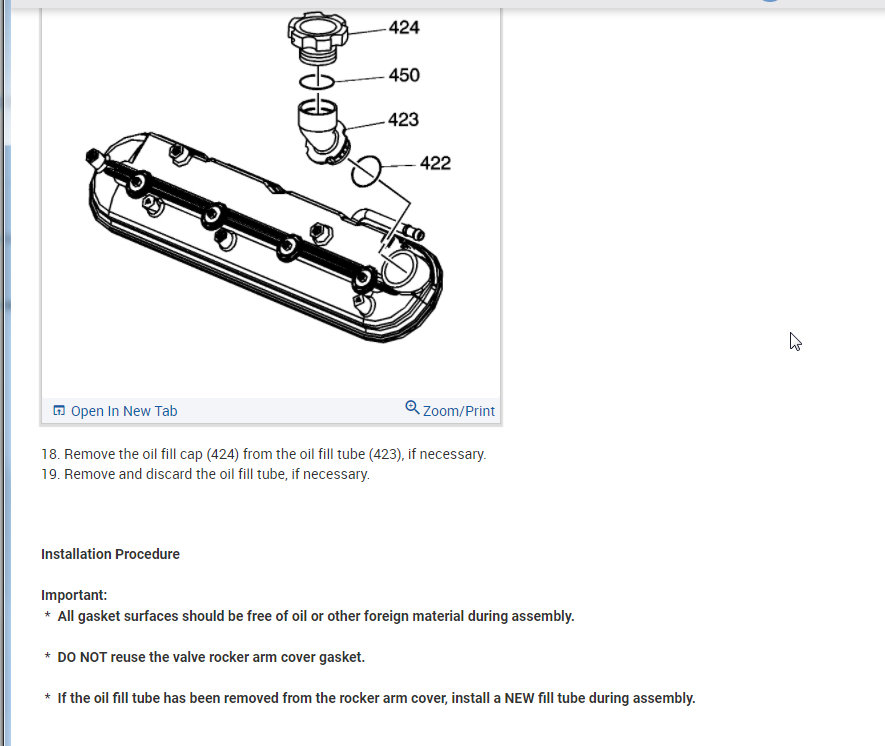

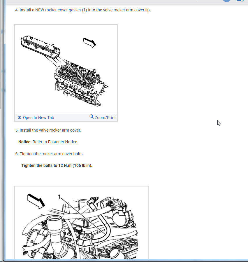

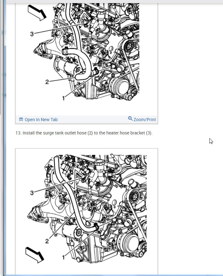

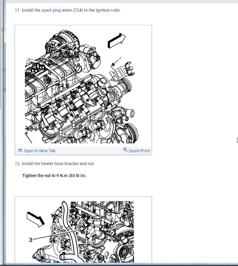

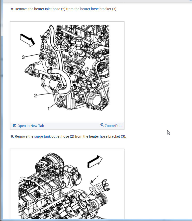

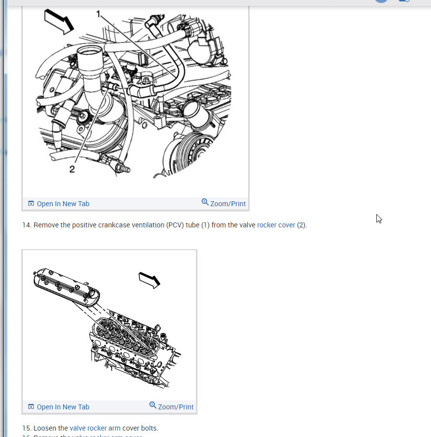

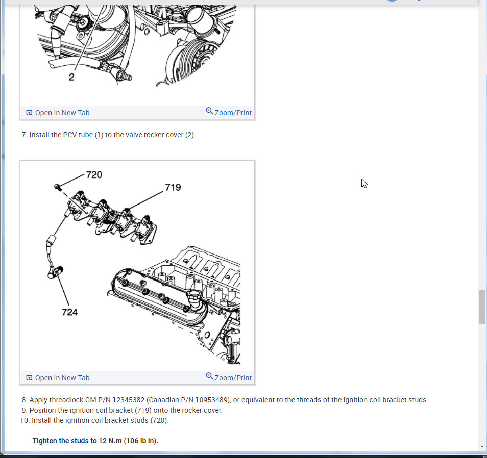

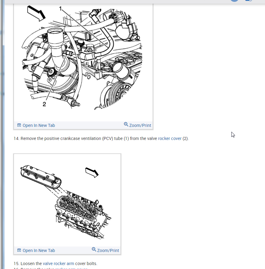

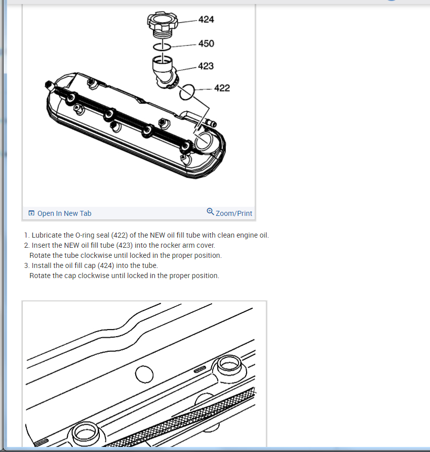

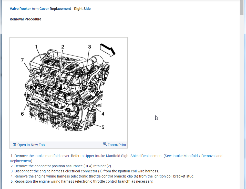

If you are not able to get them out with needle nose pliers then you are going to have to remove the valve cover and retrieve them. There is a chance that they will settle into a place in the top of the head that does not cause an issue but I would not leave them as the result could be damage to the engine.
Let me know if you have questions. I attached the process below for the right cover. Thanks
