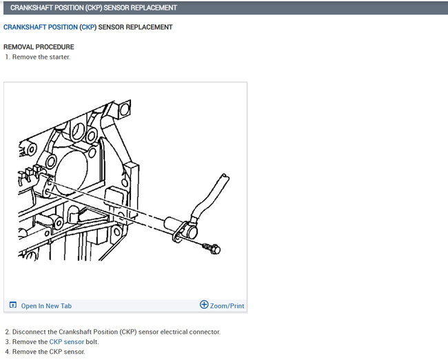

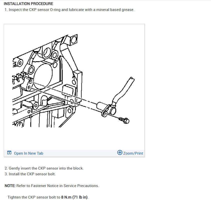

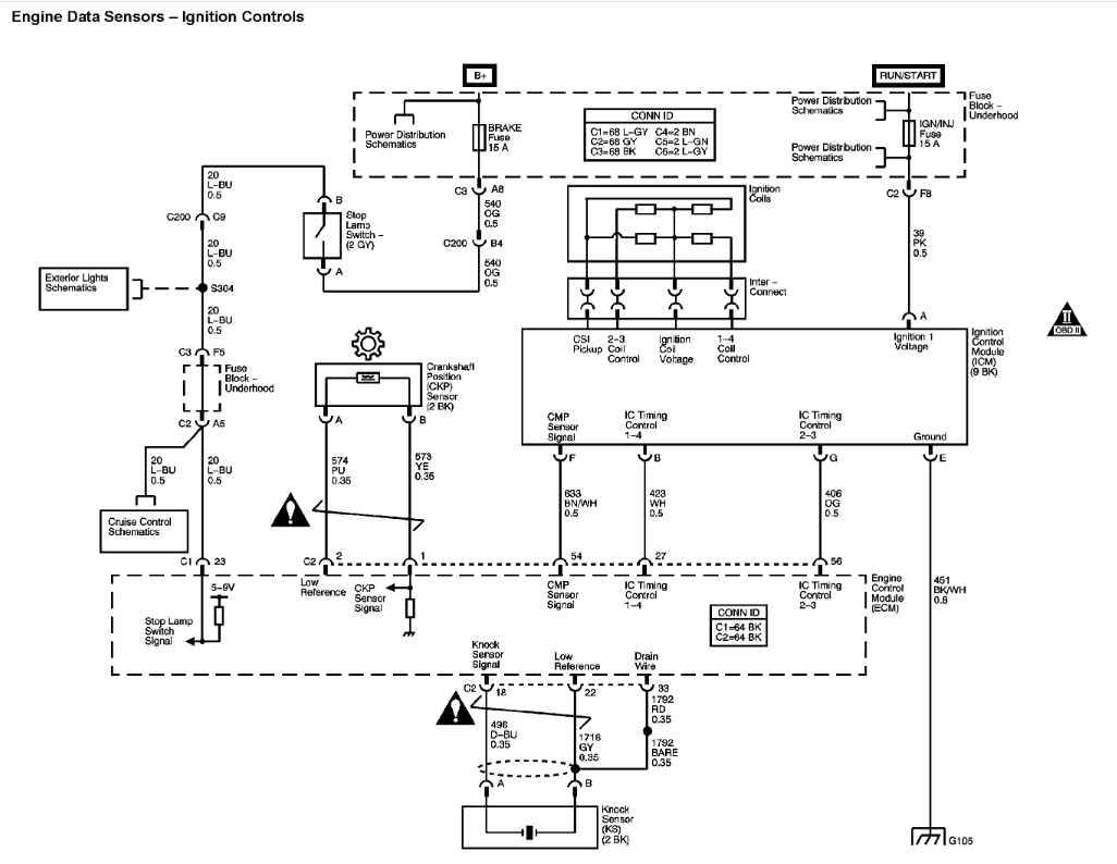

Cannot find the location of camshaft sensor and crank shaft sensor.
May 18, 2024 at 7:40 AM
AL514
  • 5,587 POSTS

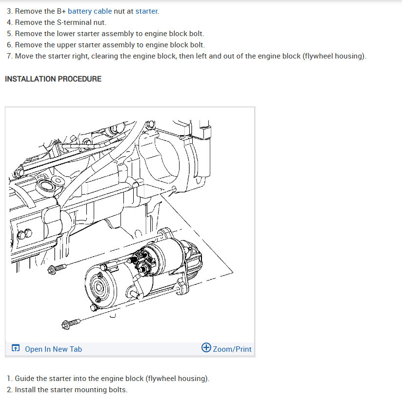

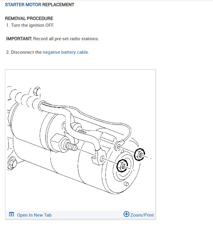

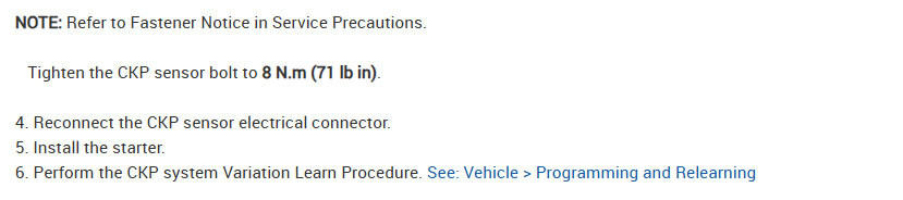

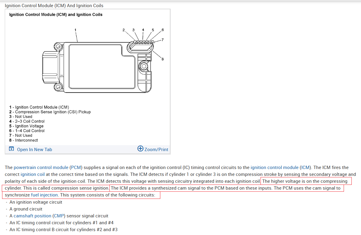

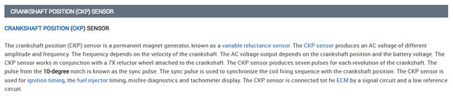

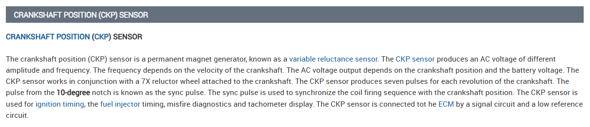

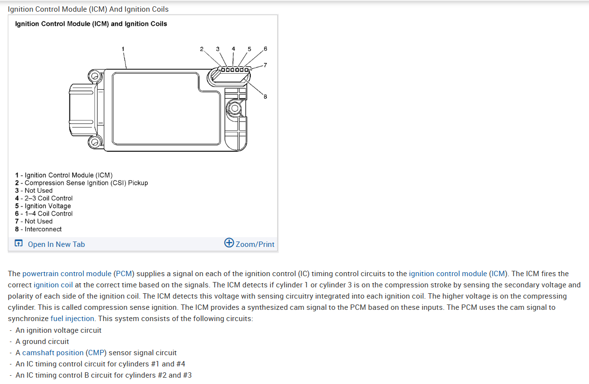

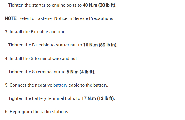

Hello, it looks like you need to remove the Starter motor to replace the crankshaft position sensor, unless you can sneak it out somehow. Diagrams 4,5,6 are the crank and camshaft position operations, surprisingly it looks like it doesn't have a cam sensor, notice the info in diagram 7, It describes the operations of how the PCM detects a cam signal. Definitely a different design. I had to look twice at it.

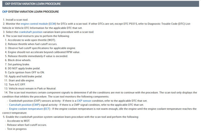

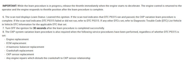

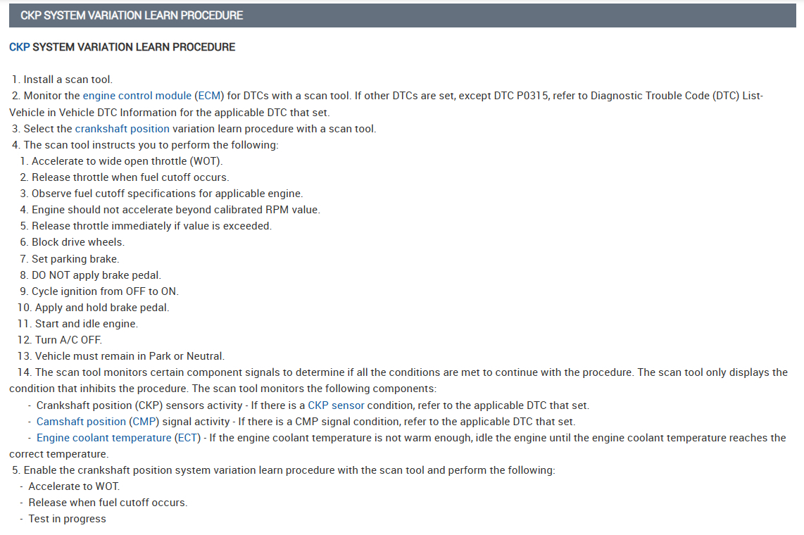

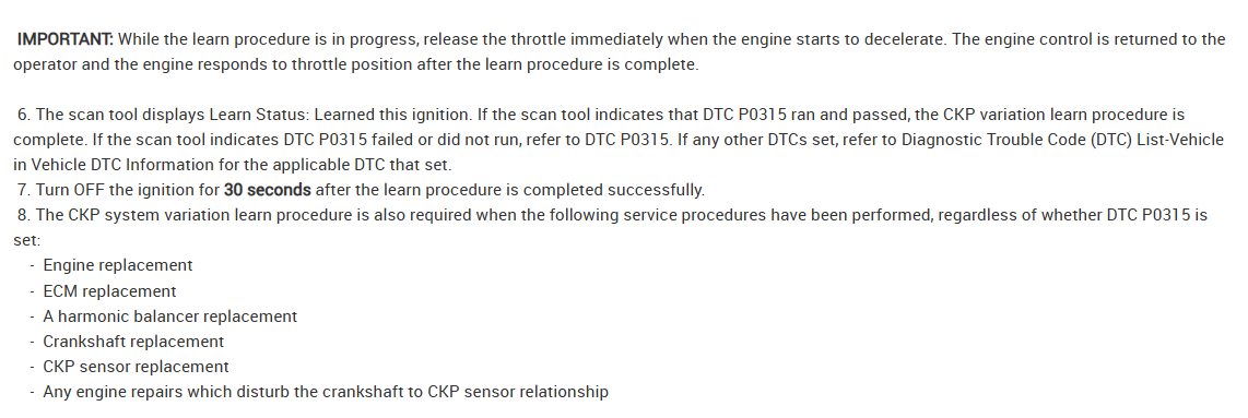

Here is the crank relearn procedure, after the sensor is replaced.
