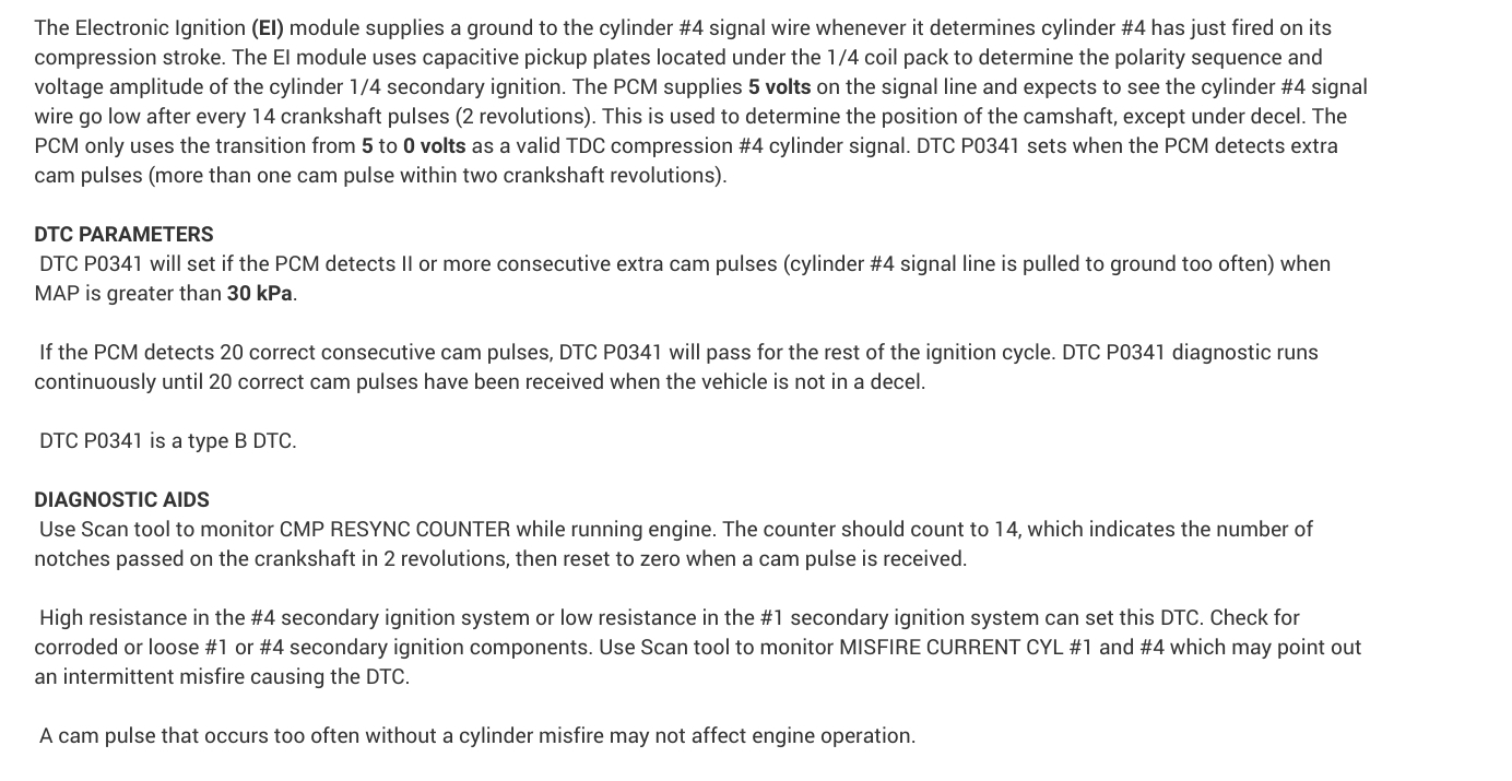

Does my car have a camshaft position sensor? I am getting a P0341 code.
Feb 25, 2020 at 11:55 AM
SCGRANTURISMO
  • 4,897 POSTS

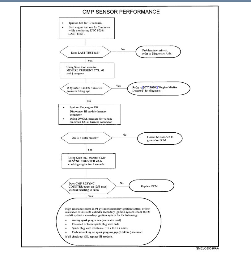

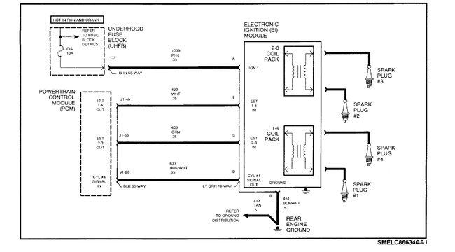

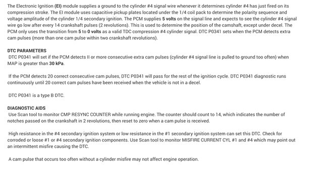

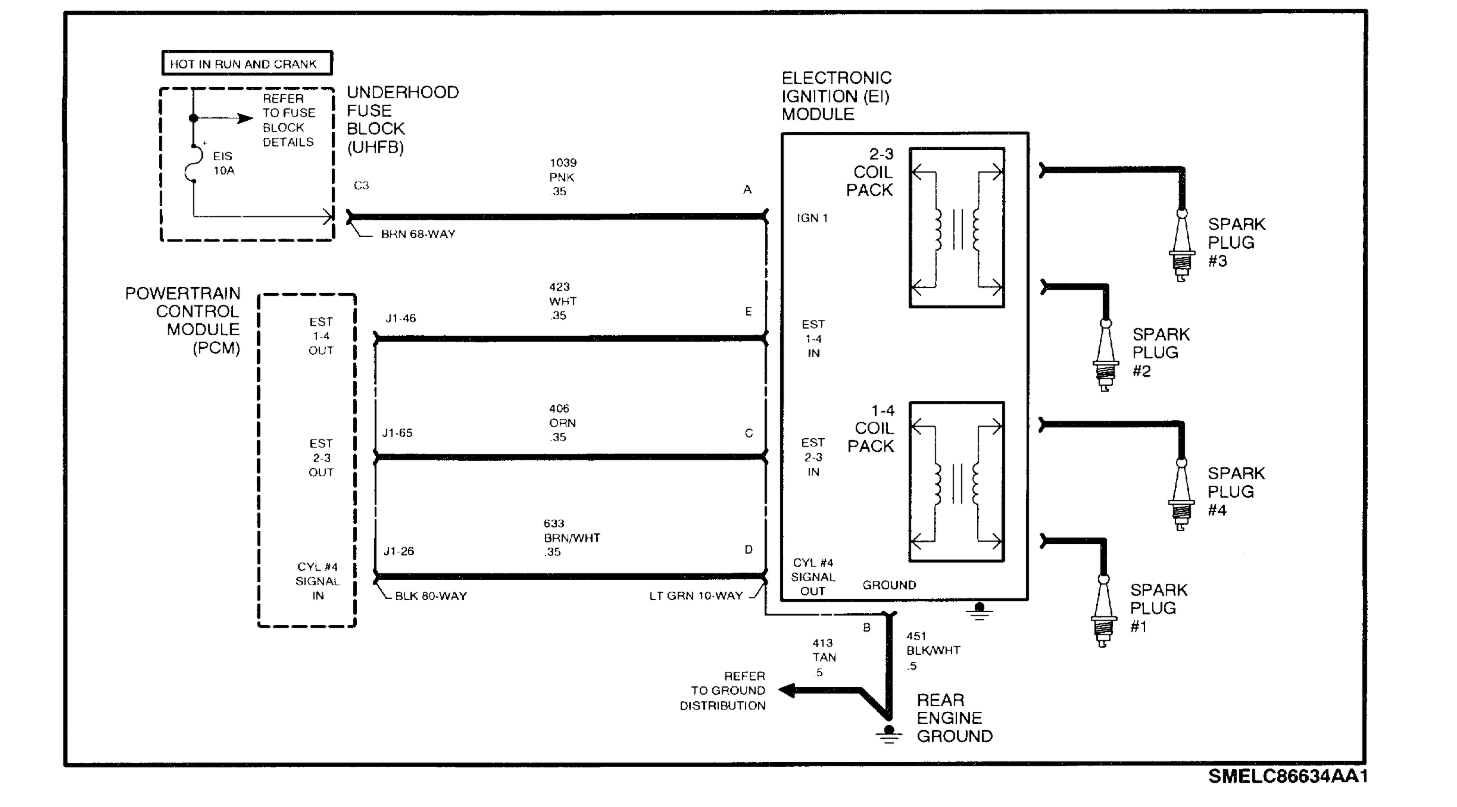

No, it does not. It has conductive plates under the 1 and 4 coil packs. In the diagrams down below I have included the diagnostic guide from the vehicle manufacturer for Direct Trouble Code[DTC] P0341 for your vehicle. Please go through this guide and get back to us with what you find out.
