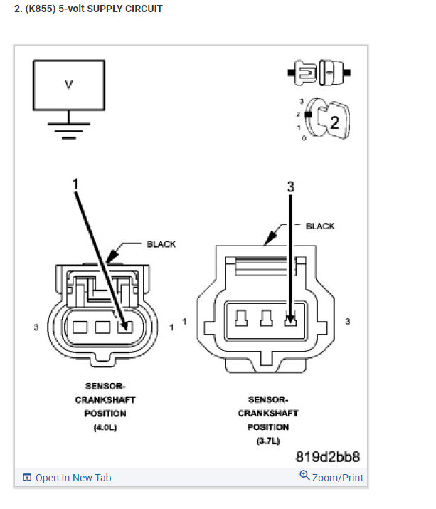

I removed camshaft sensor then turned over motor while it was removed now when new one installed won't start. did I throw off timing by turning motor over?

hard start cranks 3 to 5 seconds. check engine light on first said crankshaft sensor then multi cylinder misfire main 2 bank. changed plugs, coil packs, still hard start check engine light still on will not erase. motor seems to run great. next scan says o2 sensor changed, check engine light still on still hard start. next scan says fuel injector and coil packs, spark plugs 02 sensor, again my fuel pump comes on i can hear it even sitting for days. go out push valve on fuel rail gas comes out haven't tested for pressure yet. have seen on net it could be camshaft sensor,temperature sensor or mass flow sensor. so i got those on the way here. also bought injectors it also has new throttle body.Any suggestions. thanks for your help.

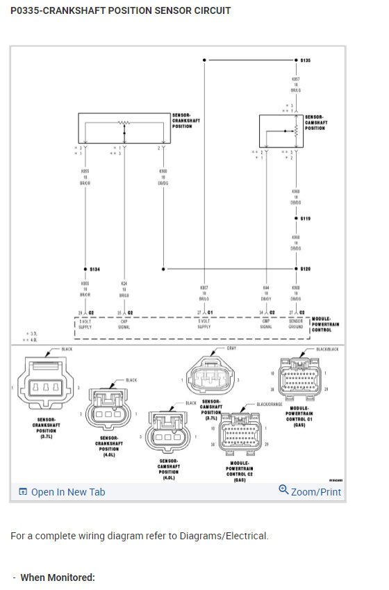

yeah, already did. i have scanned about twenty times always something different. it was po300 as primary fix done crank sensorpo335 done got it but can't erases codes. crazy po300 random misfire already replaced fuel pump. maybe it runs great but light is annoying after do repairs.

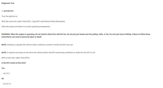

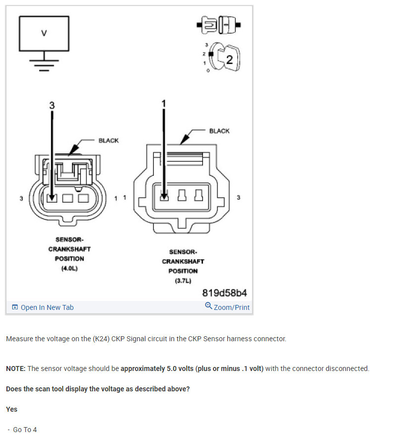

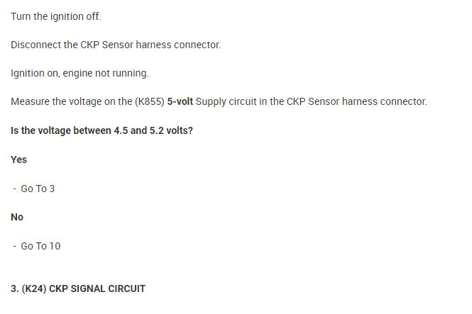

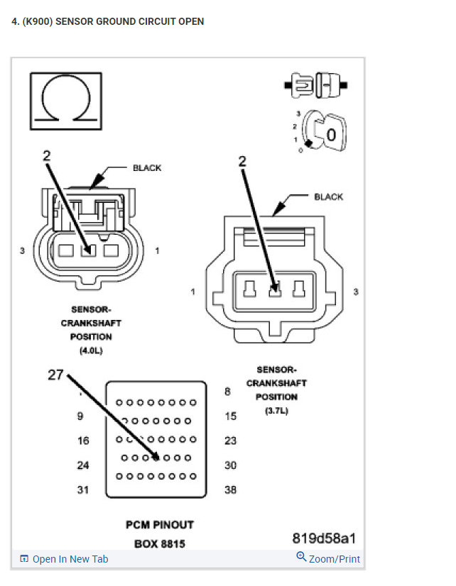

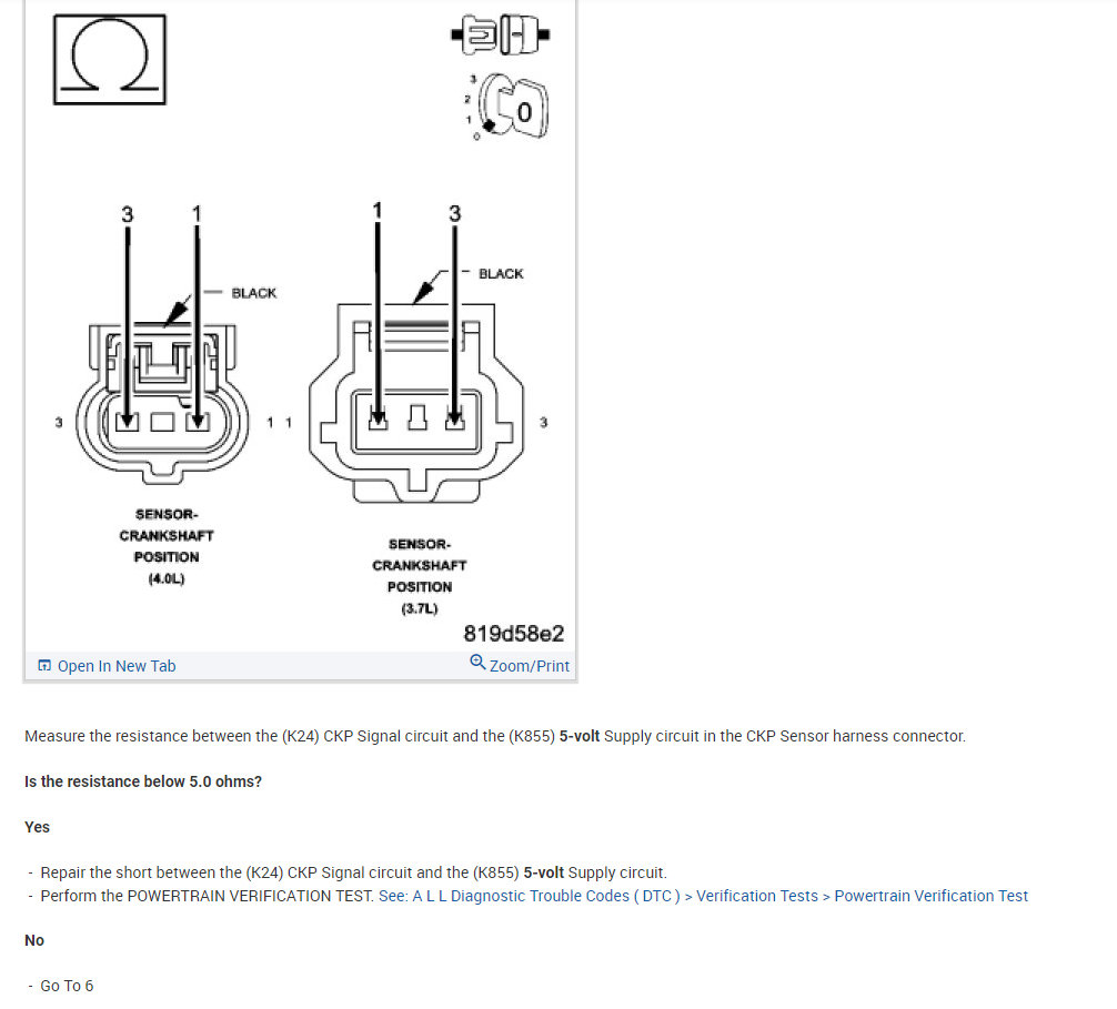

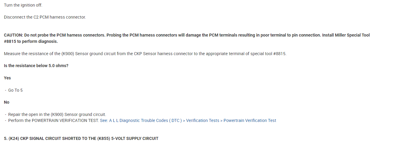

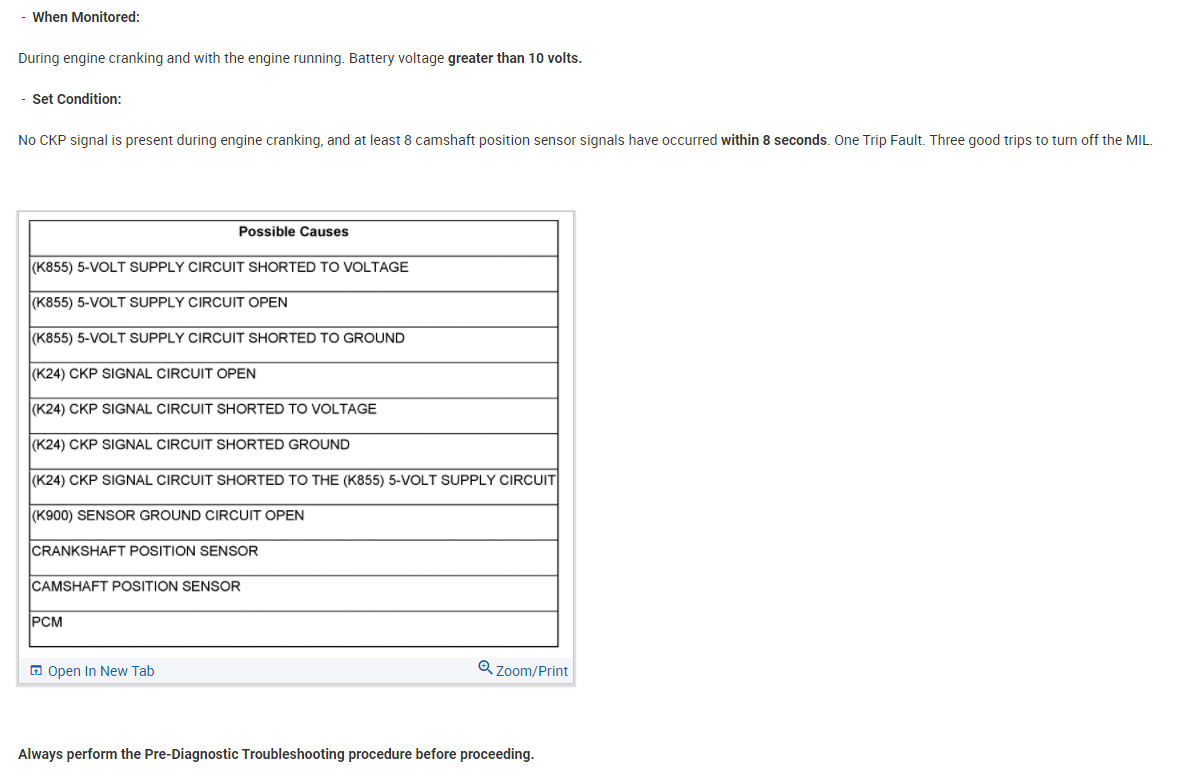

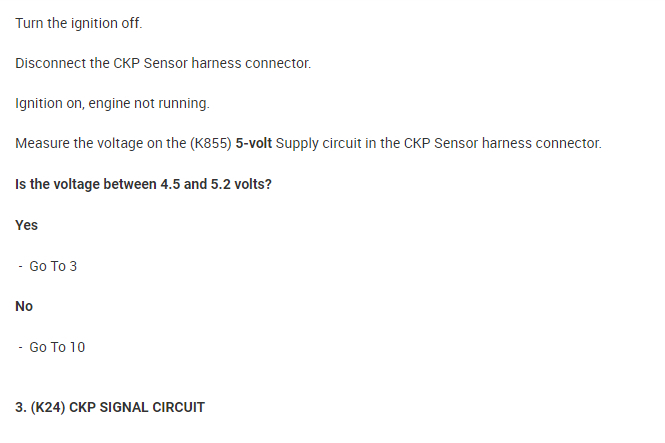

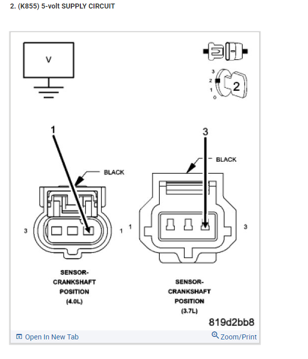

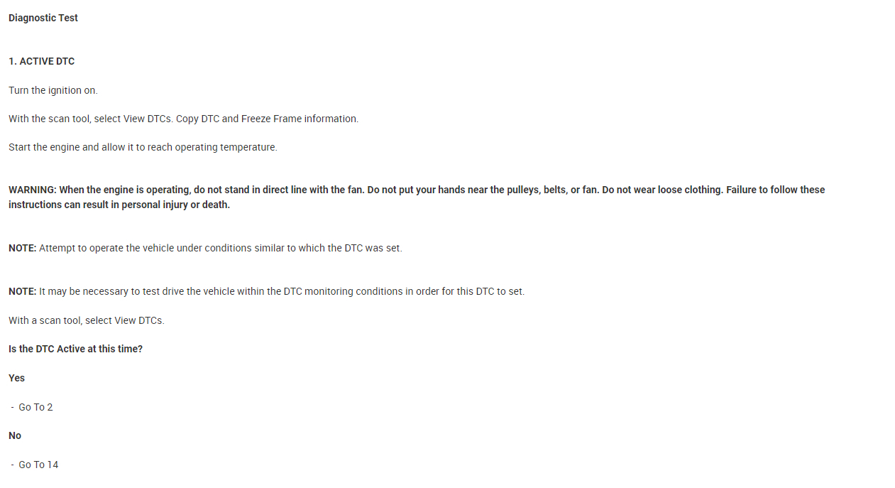

I have send some. Check out the diagrams (below).
it sounds like you have a issue with your PCM (power control module).
Please run down these guide and report back.
