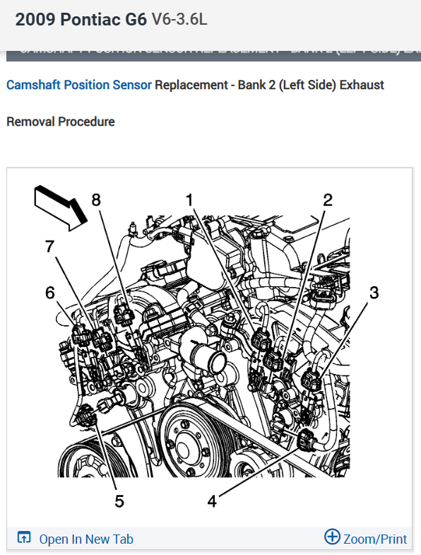

Where is the Camshaft position sensor located?
2009 PONTIAC G6
73,000 MILES • 3.4L • V6 • 2WD
TRAVONHERRIOTTE
Where is it? In dummy terms, please.

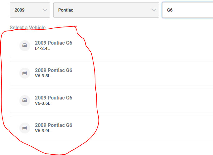

I would be happy to help, but a 3.4L isn't indicated as an option in 2009. If you look below, I attached what my manual indicates as options.
Take a look and let me know if you see the correct one.
See pic below.

TRAVONHERRIOTTE
It’s the 3.6L V6.

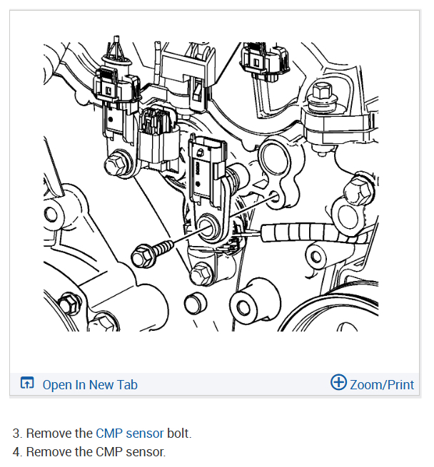

Sure, there are 4 camshaft position sensors on this engine which one do you need to replace? Check out the images (below). Let us know if you need anything else.
