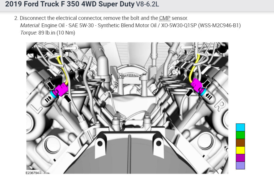

Where is the camshaft position sensor b circuit bank 2 located?
25,000 MILES • 6.2L • V8 • 4WD • AUTOMATIC
BARK613

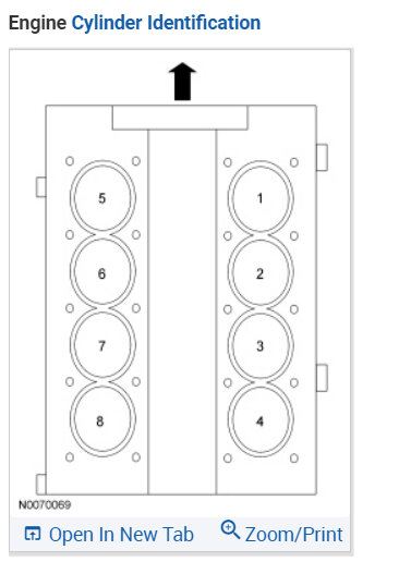

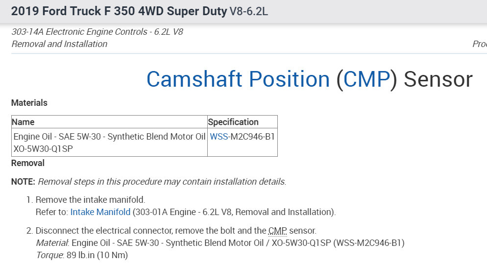

need to know location of camshaft position sensor b circuit bank 2.
Jun 15, 2023 at 4:20 AM
  • 55,721 POSTS
Here are the camshaft position sensor locations, sensor B is on the driver's side. Check out the images (below). Please let us know if you need anything else to get the problem fixed.
