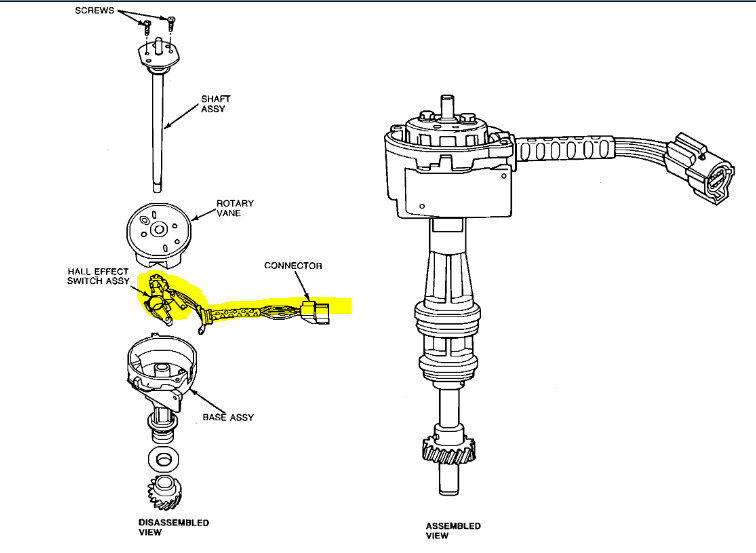

I can't seem to locate the camshaft position sensor. Help
Jun 23, 2023 at 8:20 PM
  • 110,194 POSTS
The camshaft position sensor isn't mounted on the engine. Actually, the sensor is located within the distributor and is comprised of a hall effect switch and a camshaft driven 6 bladed shutter plate. I attached a pic below showing the hall effect switch.
Let me know if that helps. Note, if you check at a parts store, they may refer to it as a pick-up coil/sensor.
See pic below.
