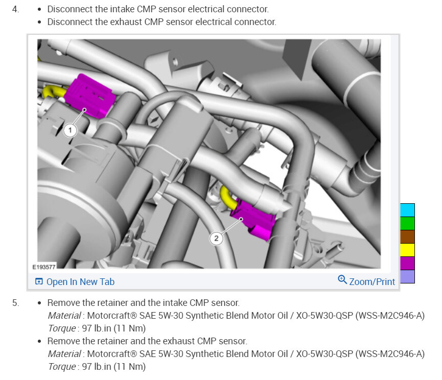

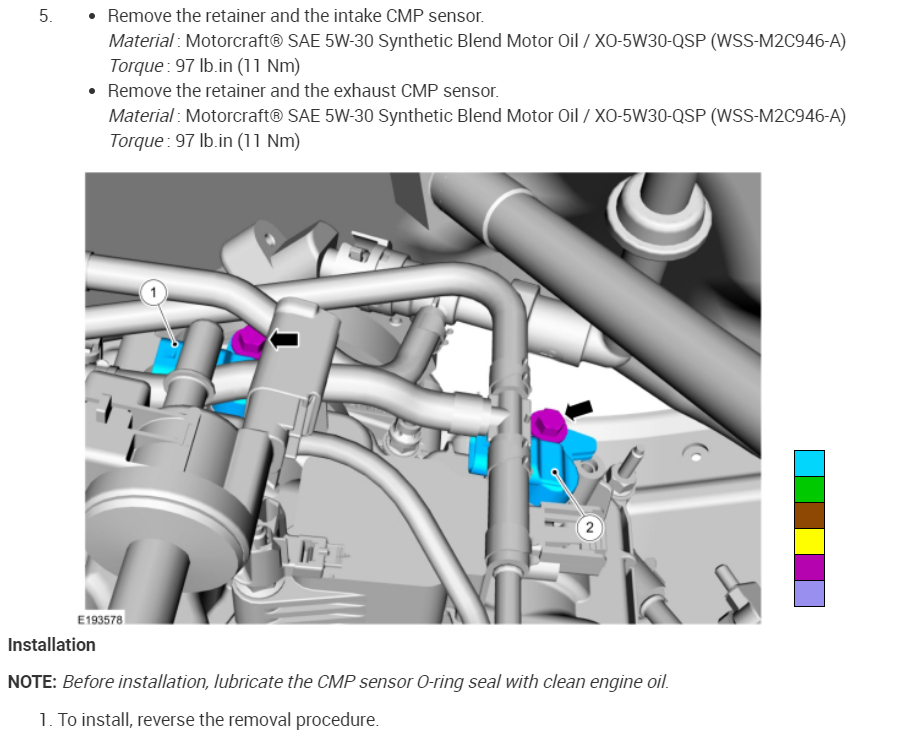

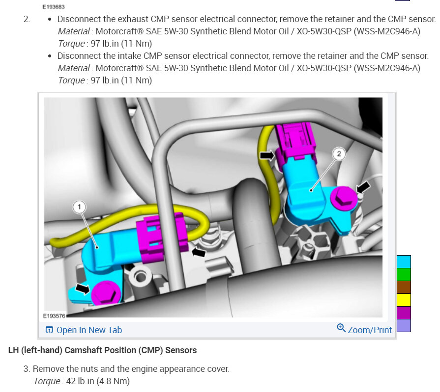

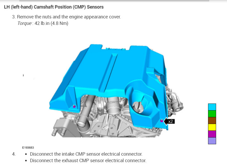

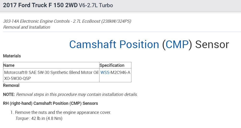

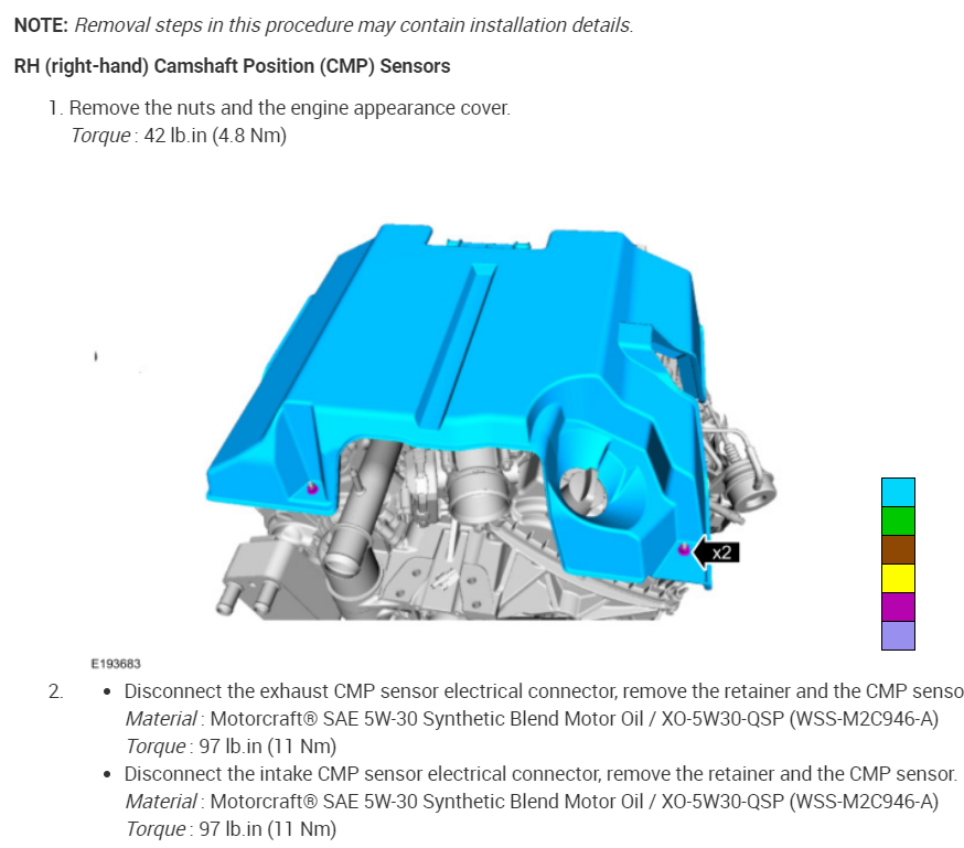

Need to know location of camshaft position sensor and number of sensors. Think it's bank 1 and 2?

So, there are four sensors two for each bank, intake and exhaust, you must remove the engine cover to see them, here are the instructions and location of the camshaft sensors so you can replace them. Check out the images (below). Please let us know if you need anything else to get the problem fixed.

Okay, thanks. Going to check it out. already got parts just need the locations. Miss the old school motors! It is so much easier when they would talk to you! Thanks again.
