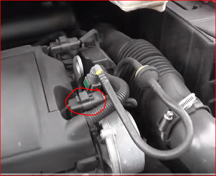

My diagnostic machine cam up with fault p1340 which is camshaft position sensor. I brought a new one but do not know which sensor to change! One at front of engine or the back?

I have attached a tutorial showing how to replace and a picture of its location (circled in red) Hope this helps and thanks for using 2Carpros.
Danny-
https://www.2carpros.com/articles/camshaft-angle-sensor-replacement

Thank you for you help. Unfortunately I have changed this and does not seem to be the problem after all.

Did you clear the codes once the sensor was replaced?
