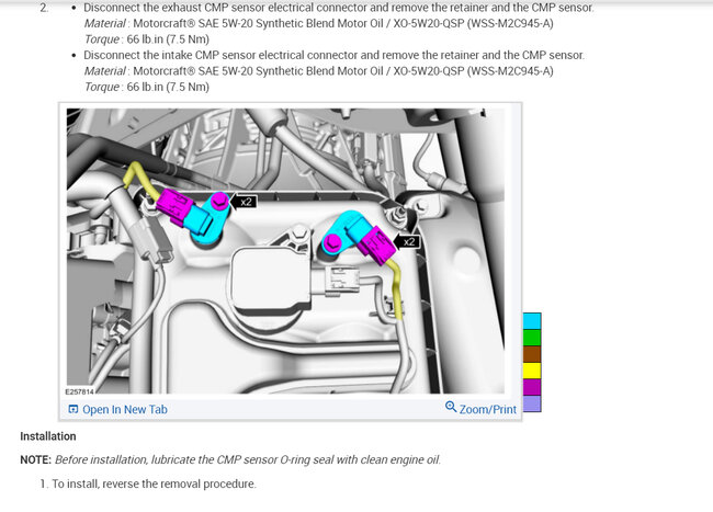

Code P0390, where is the camshaft Position Sensor located?
77,000 MILES • 5.0L • V8 • 4WD • AUTOMATIC
MRSDEBISMITH
The way it was acting, I thought it was possibly the transmission. I took it by an auto parts store, and they checked it out and it came back as a bad camshaft position sensor (P0390, Bank 2). The sensor came in this morning, and I cannot figure out where it is located on the motor. Can someone help me out with this? Thank you.
May 29, 2023 at 4:39 AM
  • 55,732 POSTS

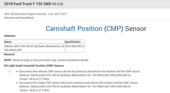

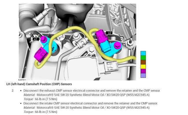

Here are the camshaft position sensors in the images below and more information on the code featured.
The code P0390 is a diagnostic trouble code (DTC) that signifies a problem with the "Camshaft Position Sensor "B" Circuit (Bank 2)".
Check out the images (below). Please let us know if you need anything else to get the problem fixed.
