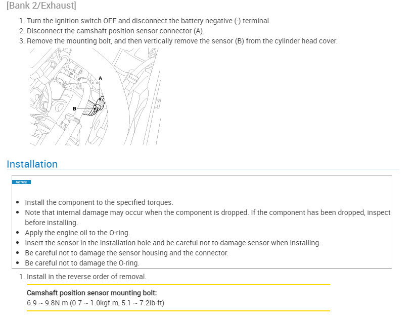

Hello, I have an engine light on and OBD code came back as camshaft position sensor exhaust side. I ordered a new camshaft position sensor and plan to install it this weekend. My question is, do I have to do a camshaft position sensor relearn procedure afterwards? I searched everywhere and did not see anything saying it will need a relearn done, but I did see some cars do.
Jul 20, 2022 at 7:48 PM
SQM
  • 6,383 POSTS

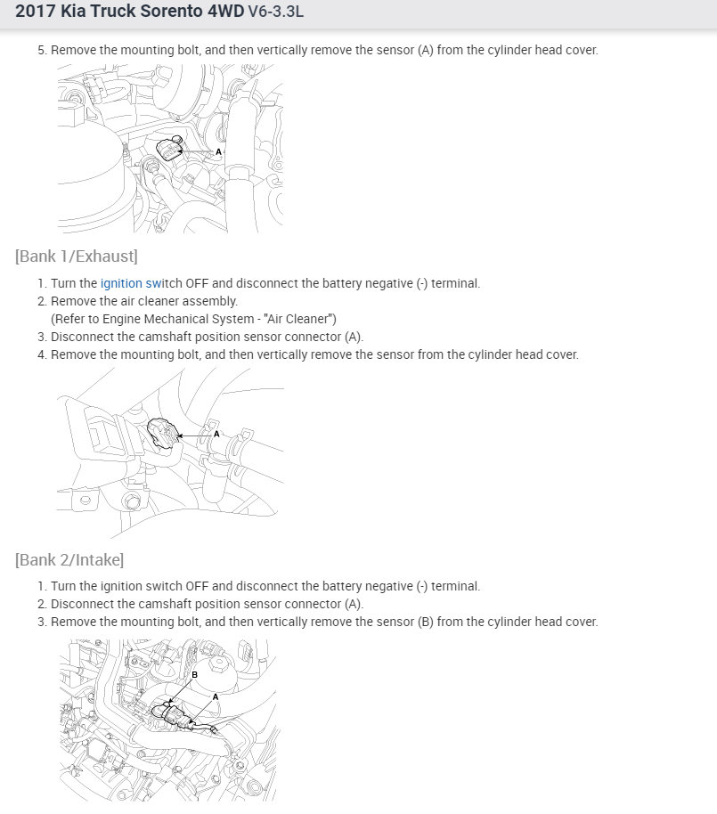

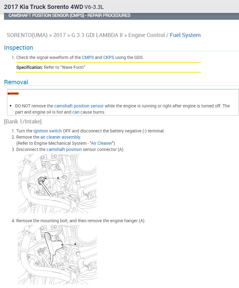

See attached for the replacement procedure.
The manual does not call for relearning of the cam sensor for this vehicle.
https://www.2carpros.com/articles/camshaft-angle-sensor-replacement
Let me know of any questions.
