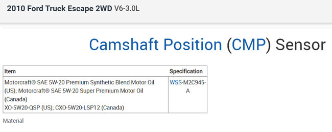

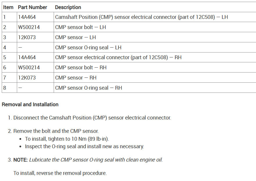

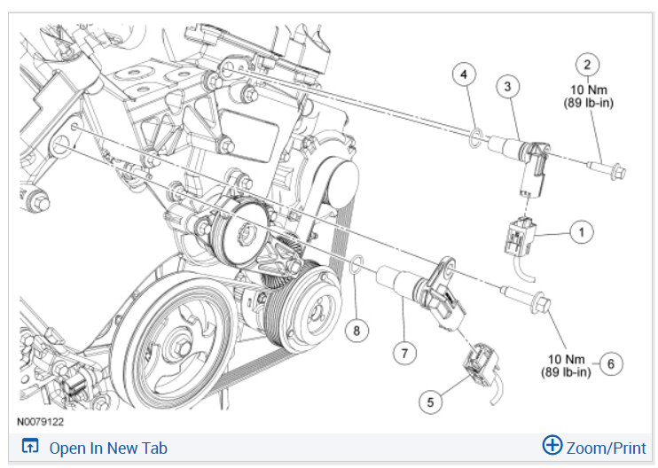

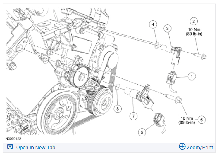

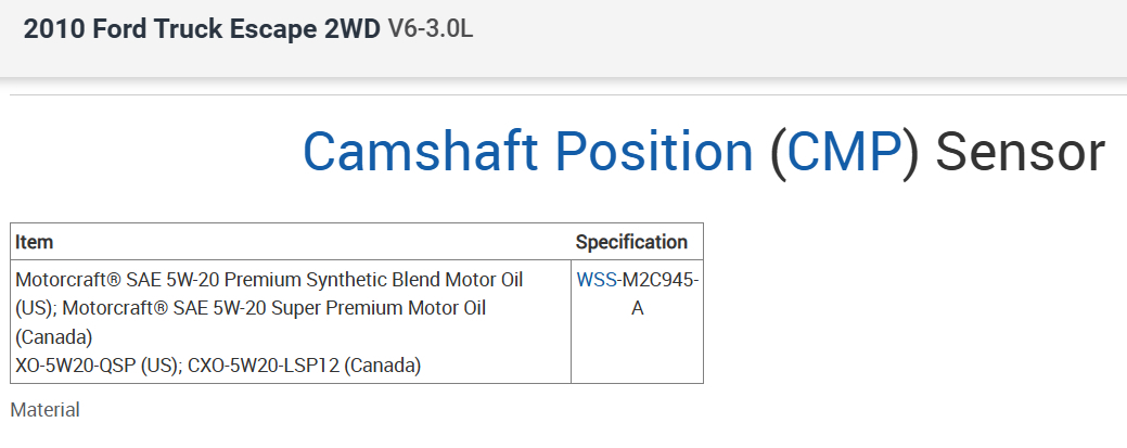

I need to know where the camshaft position sensor and 1 sensor b are located to replace it.
Nov 12, 2024 at 7:03 AM
  • 55,433 POSTS
If you have a circuit low code the problem is probably mechanical but here is the camshaft position sensor location which is at the front of the engine so you can change it out. Check out the images (below). Please let us know what happens.
