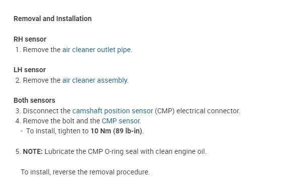

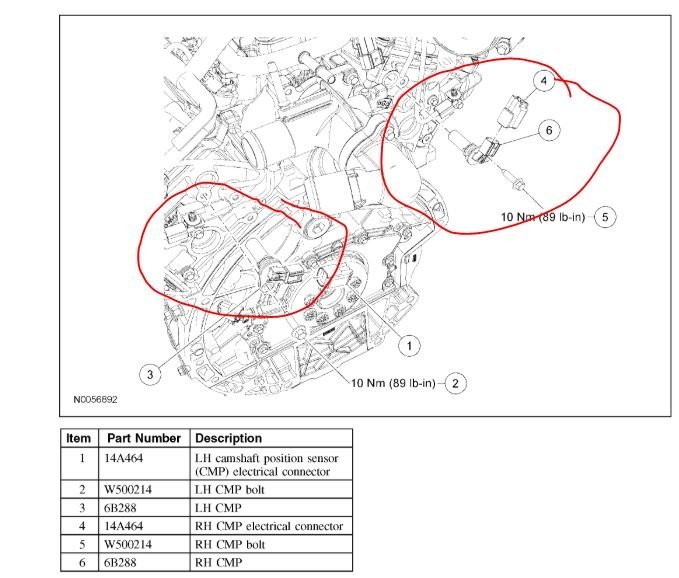

Where is the camshaft position sensor? How many camshaft sensors are there?
Jan 28, 2020 at 1:45 PM
Good afternoon,

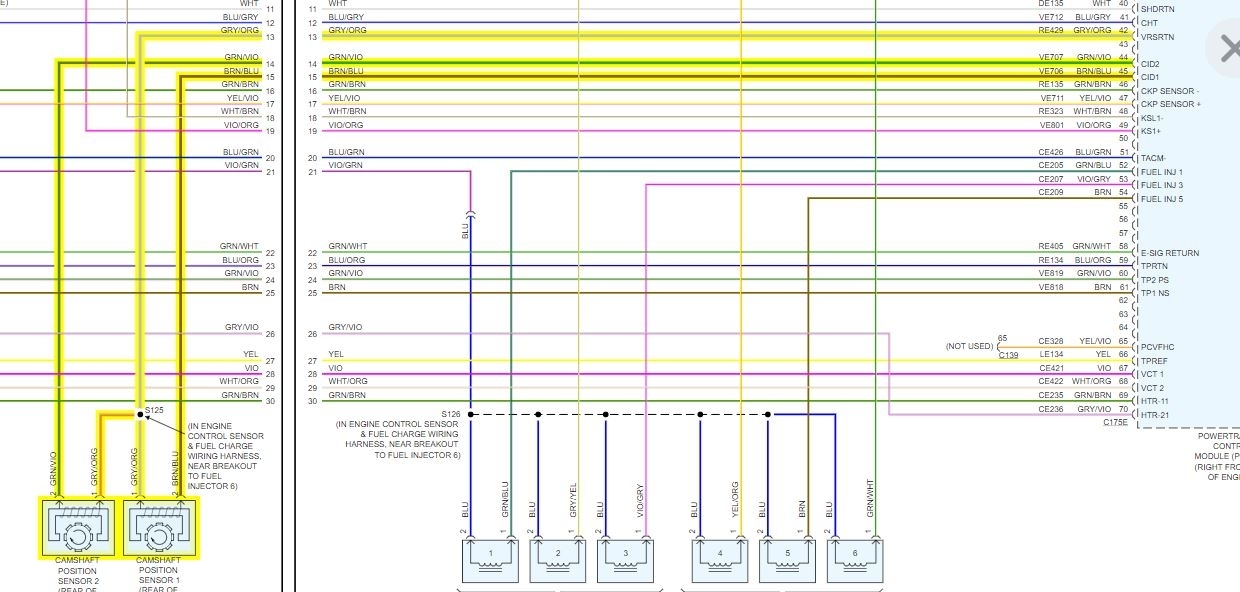

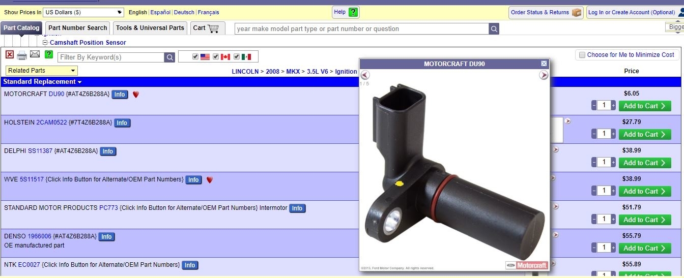

There are 2 sensors, one for each bank. I attached the picture of the location and the procedure. I also attached the parts information as well as the diagram.
Why are you replacing the sensors?
