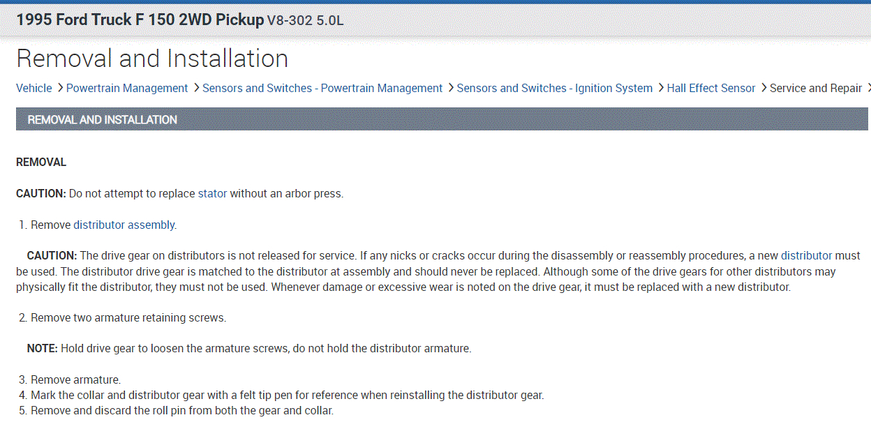

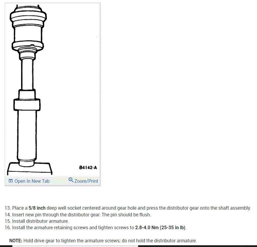

Please tell me where I can locate the Camshaft Position Sensor and how do I change it?
Aug 30, 2021 at 6:33 AM
  • 110,248 POSTS

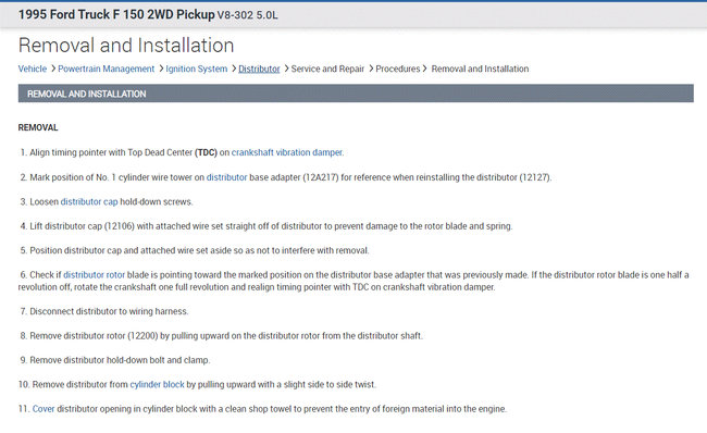

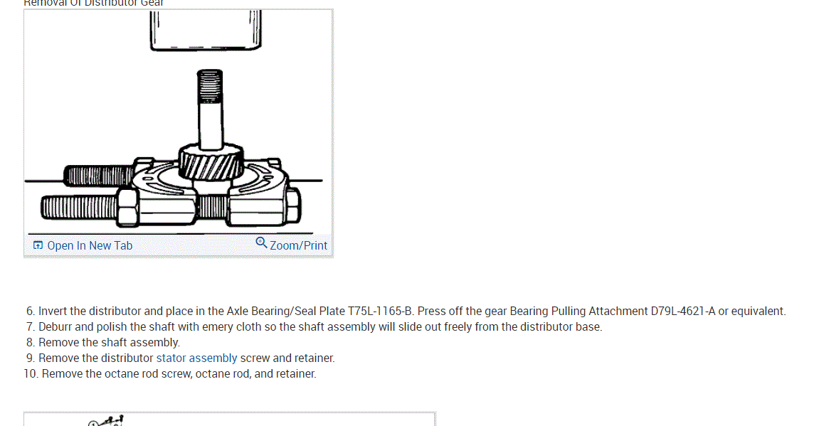

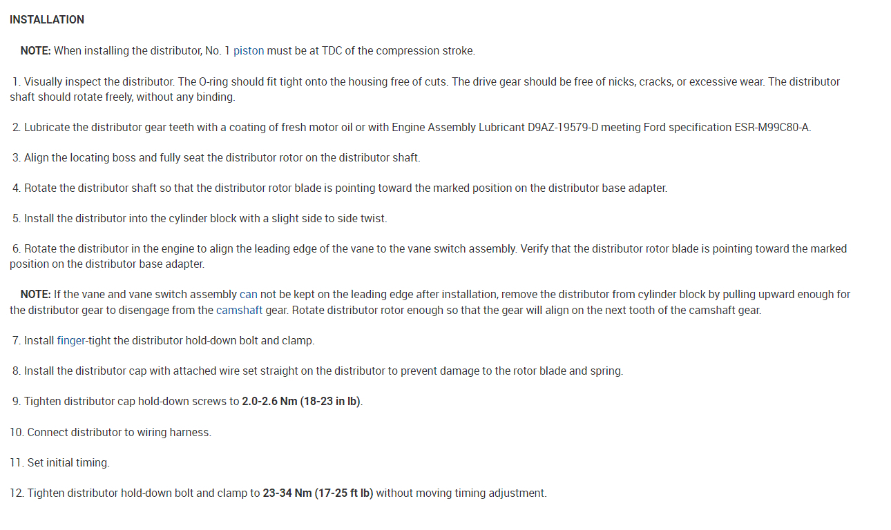

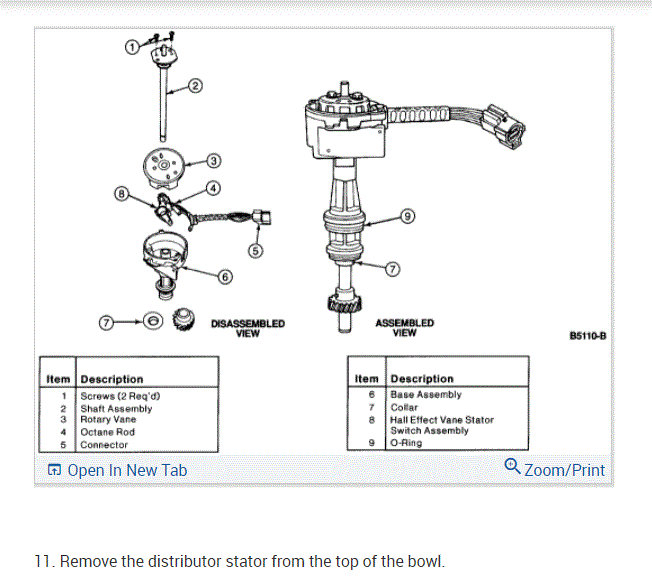

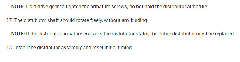

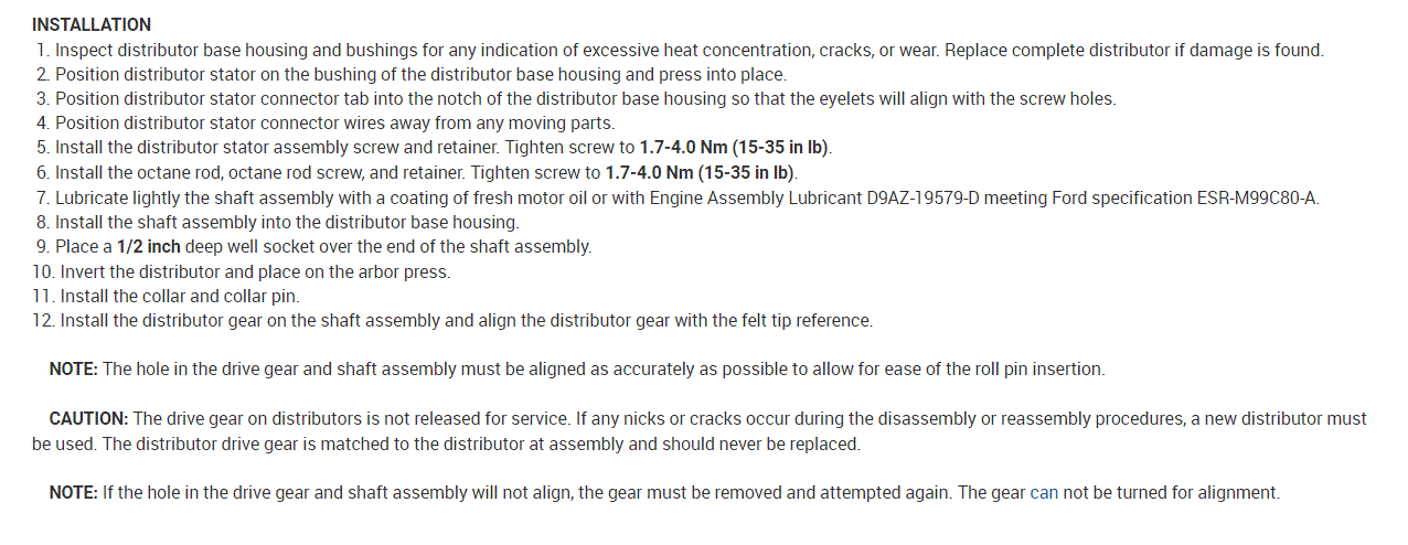

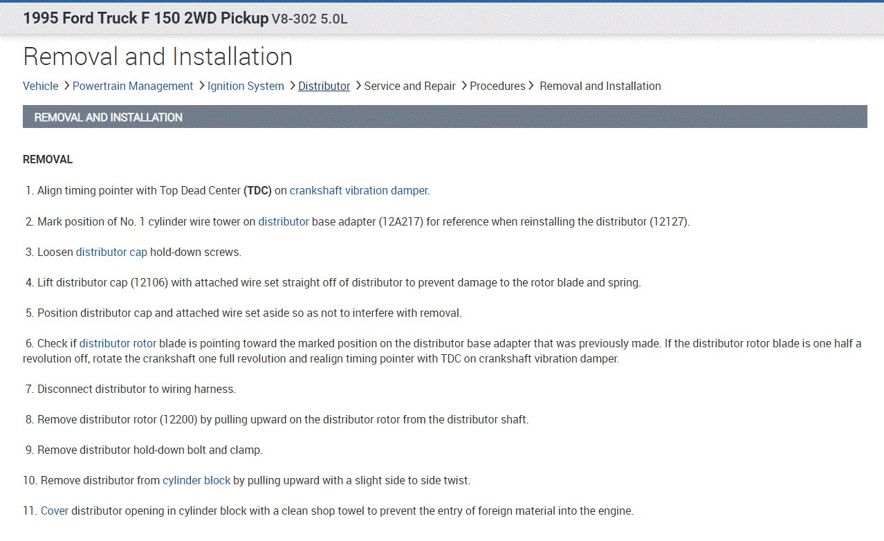

On this vehicle, there is a hall effect vane stator switch that functions as a camshaft position sensor. As far as replacement, the distributor needs removed and taken apart. This is a little bit of a project. Also, an arbor press will be needed to perform the replacement.
Keep in mind, the distributor will need to be reinstalled correctly. The last two pics below are the directions for the removal and replacement of the distributor.
