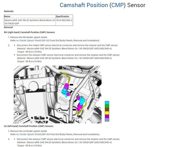

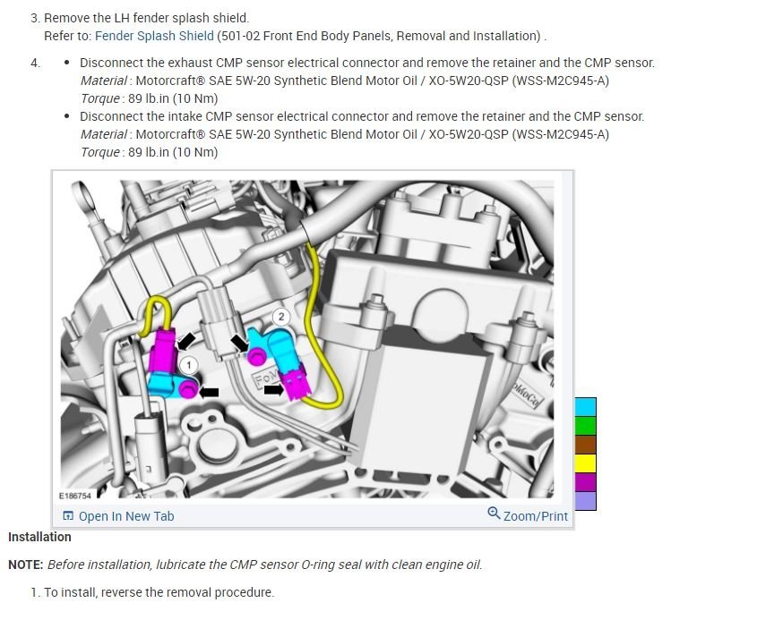

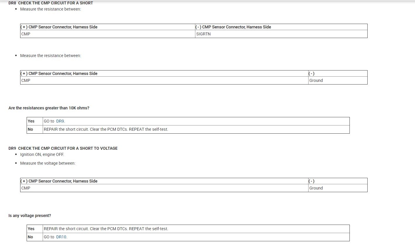

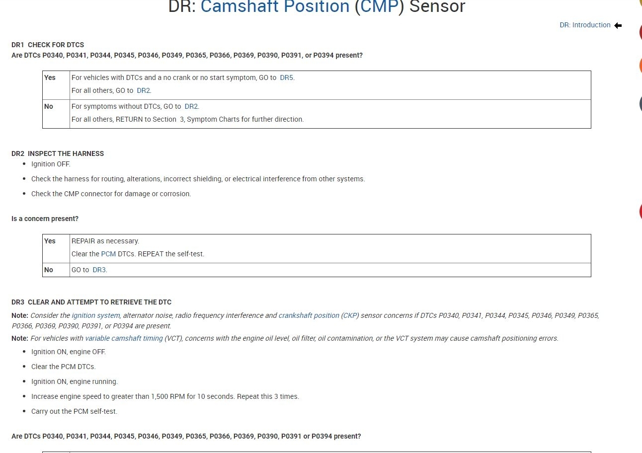

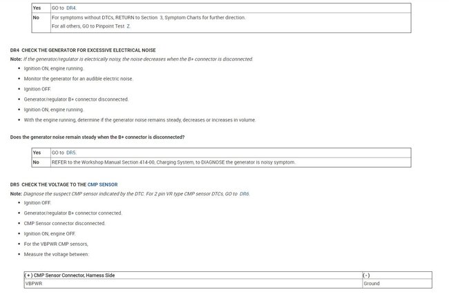

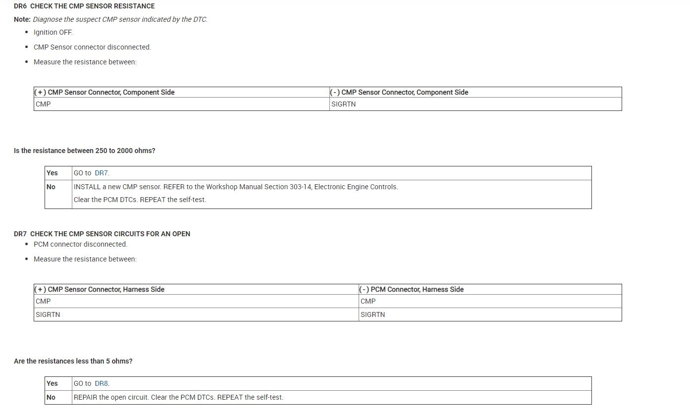

Having trouble find camshaft position sensor for a code P0365 in sensor B, bank 1. Any images helps. Thank you.

Good afternoon,

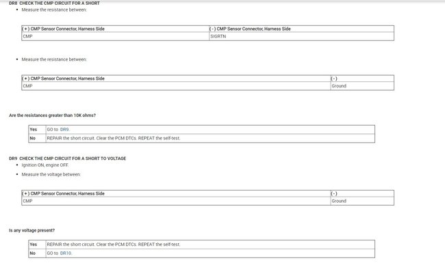

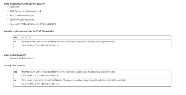

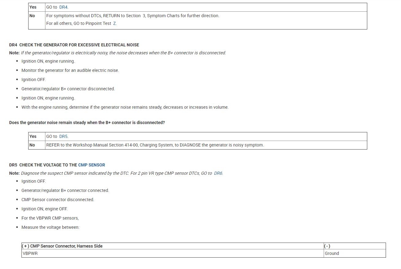

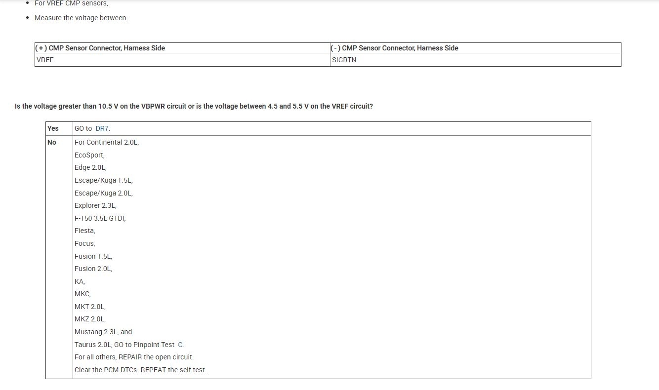

I attached the code description and possible failures.
It is for bank1 sensor 2 exhaust which is the one closest to the exhaust manifold. Bank 1 is the passenger side of the engine.
https://www.2carpros.com/articles/camshaft-angle-sensor-replacement
I also attached the connector diagram for you to test to be sure there is a reference voltage to the sensor.
