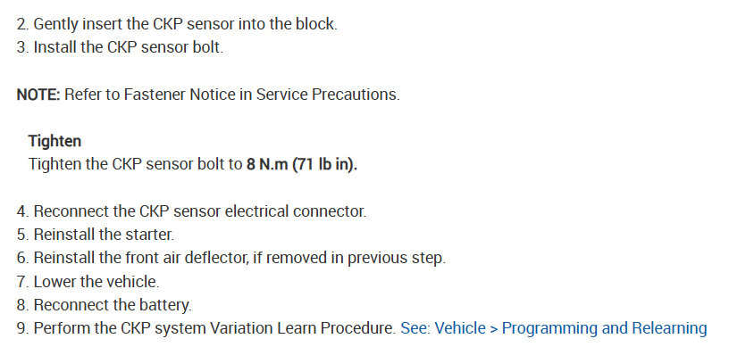

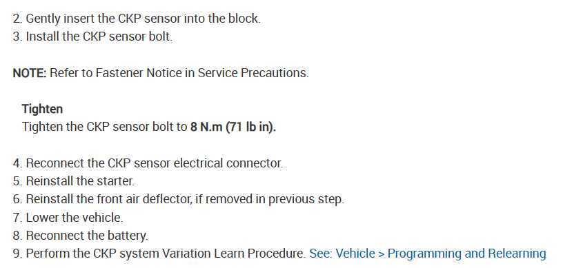

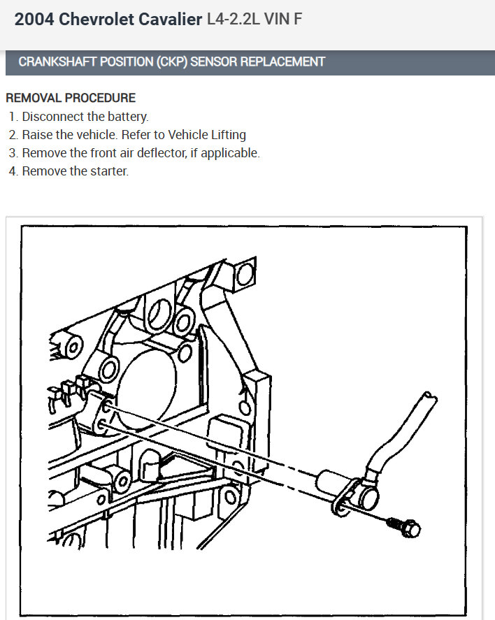

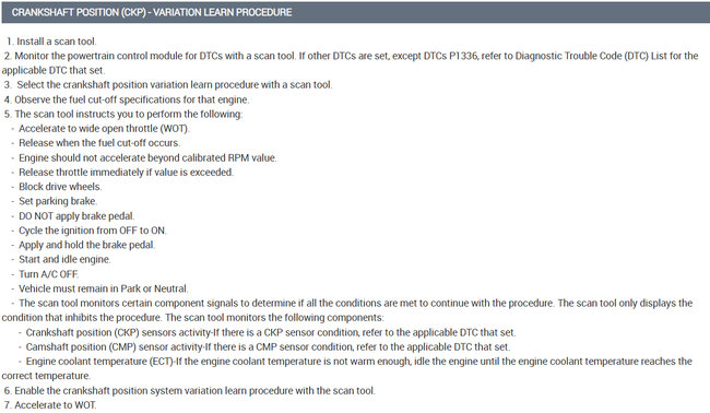

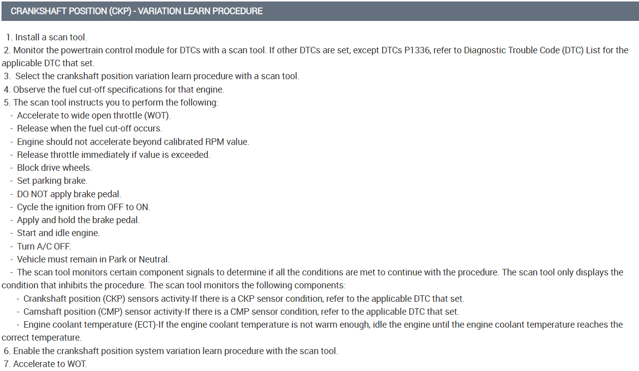

So this is a misfire code not the camshaft sensor, by change do you mean the crankshaft sensor?
"The 2004 Chevrolet Cavalier with the 2.2L Ecotec 4-cylinder engine does not have a traditional camshaft position sensor (CMP)".
A P0300 diagnostic trouble code (DTC) detected a random or multiple cylinder misfire.
There is no camshaft sensor, I double checked. Here is the location of the crankshaft sensor which will take a 10mm socket to replace. Check out the images (below). Please let us know what happens.

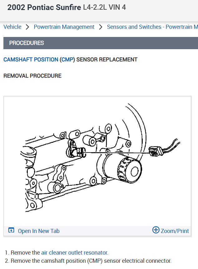

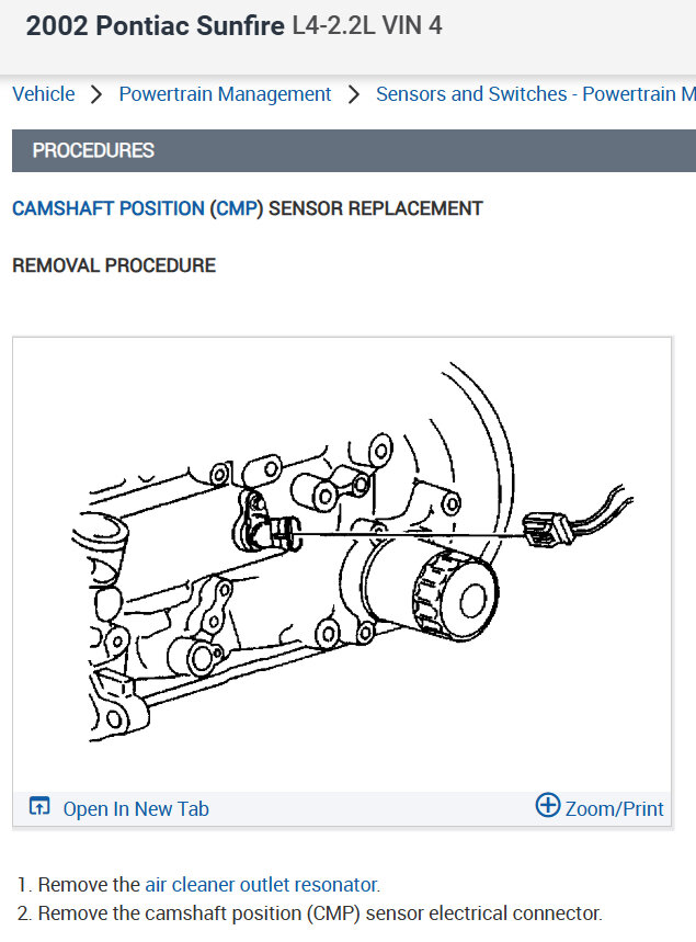

No sir, I ordered a camshaft sensor and that is what I put in this engine. I was talking to my brother in Michigan. He said the engine had been changed. and he thinks it might be a 2002 sunbird engine 2.2L Ecotec 4-cylinder J engine is there a camshaft sensor in that engine. Also, When I put the camshaft sensor in. I noticed that in the very bottom middle of the motor the 2 bolts were not in the motor mount. They were a 1/4 inch off of being aligned with the hole's and 3/16 inch's up from sitting flat on the mount. If it would not have been like this, I would have put some bolts in. It didn't seem like the engine was moving. But I am not 100% sure. Are those 2 bolts a must to be bolted down? Now I know when I first got the car, I know it had the original engine in the car. And that was a 2004 Ecotec engine 2.2L 4-cylinder J engine now that engine is supposed to be a harder engine to find. I thought this was very important to tell you about what I just found out. So, I would think that you are right that in the original engine that was in the car there is not a camshaft sensor in that engine. So that is why I asked you the question about if there is a camshaft sensor in a 2002 engine from a sunbird body. And like I said the J engine is supposed to be a rarer engine to fine. I thank you for your help. I hope you can tell me more about this whole situation. Thanks again, William Mees.
Dec 7, 2024 at 5:16 PM
  • 55,433 POSTS
Yep, you are correct, here is the location of the camshaft sensor for the 2.2 2002 engine. Check out the images (below). Let us know if you need anything else.
