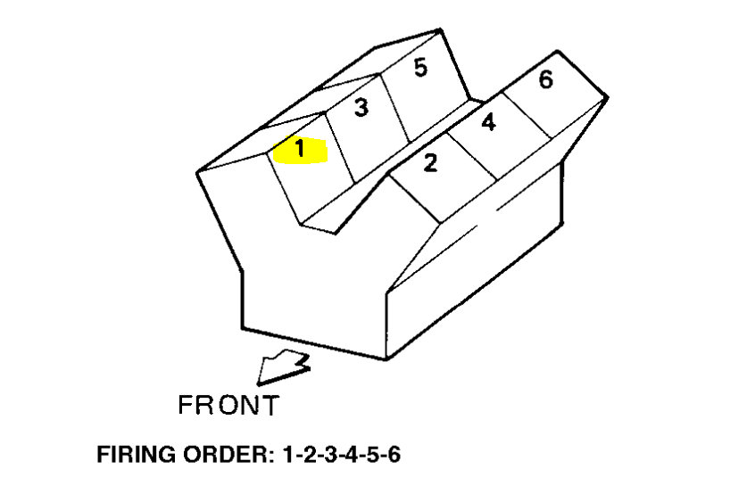

I have a P0340 error code. I need the Bank 1 censor replaced but, all of the parts listed are for left and right. Which bank is left and which one is right?

Standing at the front of your vehicle looking towards the trunk, it will be the left hand side or if sitting in the car the passenger side bank. The 1 bank in a vehicle is always to bank with the #1 cylinder in it. I have included a diagram for you below in the diagrams.
