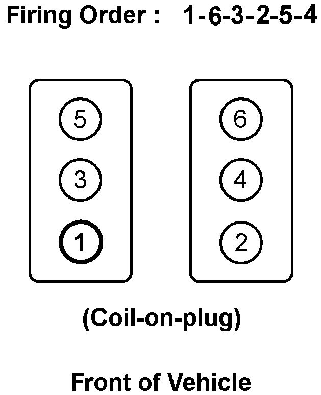

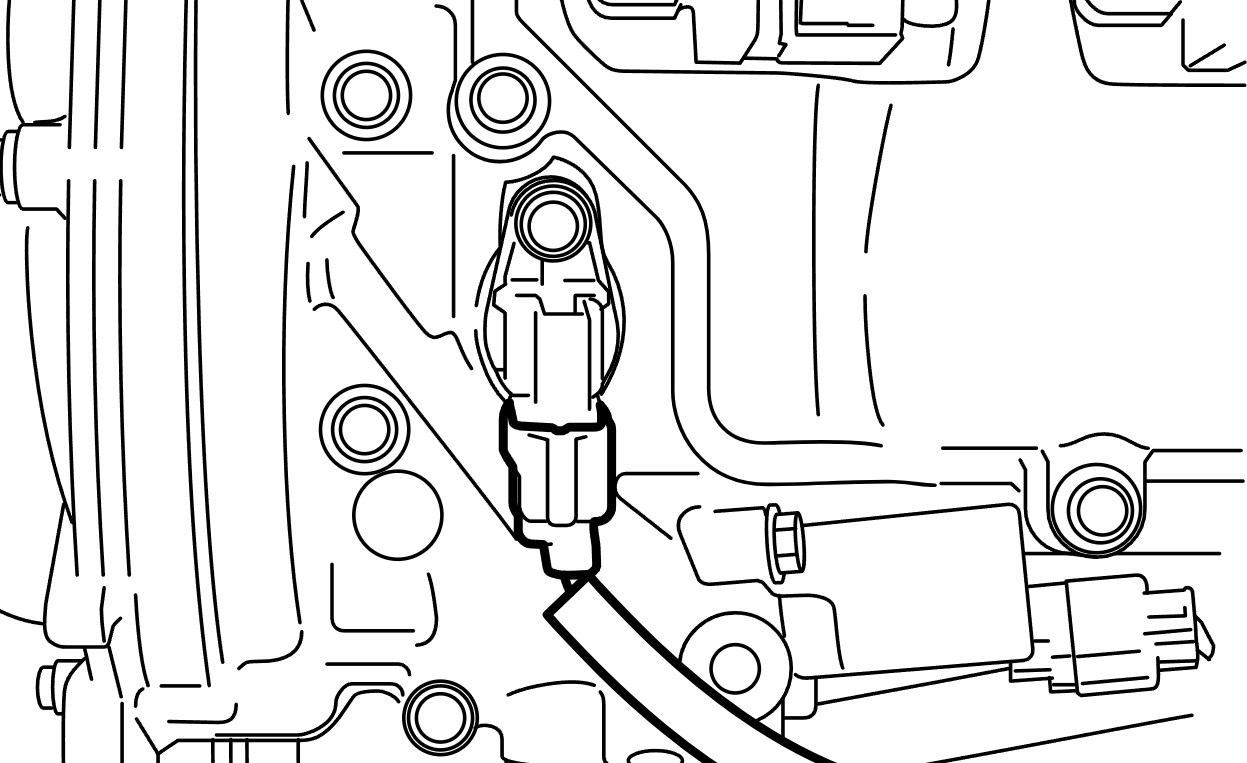

Where is the location for lower bank 1?
Mar 17, 2025 at 8:23 AM
STEVE W.
  • 15,345 POSTS
Those are reached from under the car. You remove the lower engine cover. Then you can access both sides of the exhaust cam sensors. Bank one is the right-hand side of the engine when underneath looking forward. The bolts get torqued to 5 ft lb.
Mar 17, 2025 at 11:03 AM
BBULL07
So driver side?
Mar 19, 2025 at 7:22 AM
STEVE W.
  • 15,345 POSTS
Passenger side. Right and left are determined from setting in the drivers seat. That way it doesn't matter if the vehicle is a left hand or right hand drive. Left is still left.
