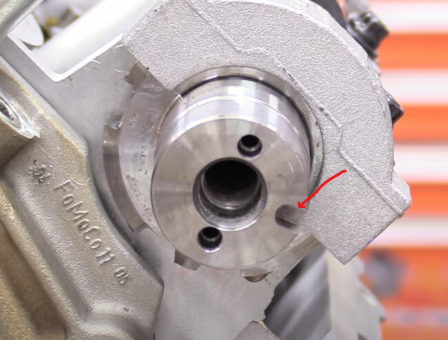

He might be okay but I need to see the damage, can you upload an images of the problem? This what it should look like. Check out the images (below). Please upload pictures or videos in your response

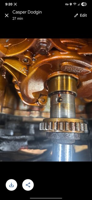

Here is the camshaft with the pin (key) removed, screenshot from phone.

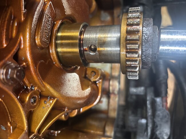

Here is a higher resolution pic...

So that is the crankshaft locating pin. Yep you can see it is wallard out, this is not good, one side of me is install the new pin and run it, but you can see the timing gear will move over time, tough call. Come on Ford!! what ever happen to the "woodruff key" it must have worked to well. Sorry but you will need a new crankshaft or risk a check engine light for crankshaft correlation codes.

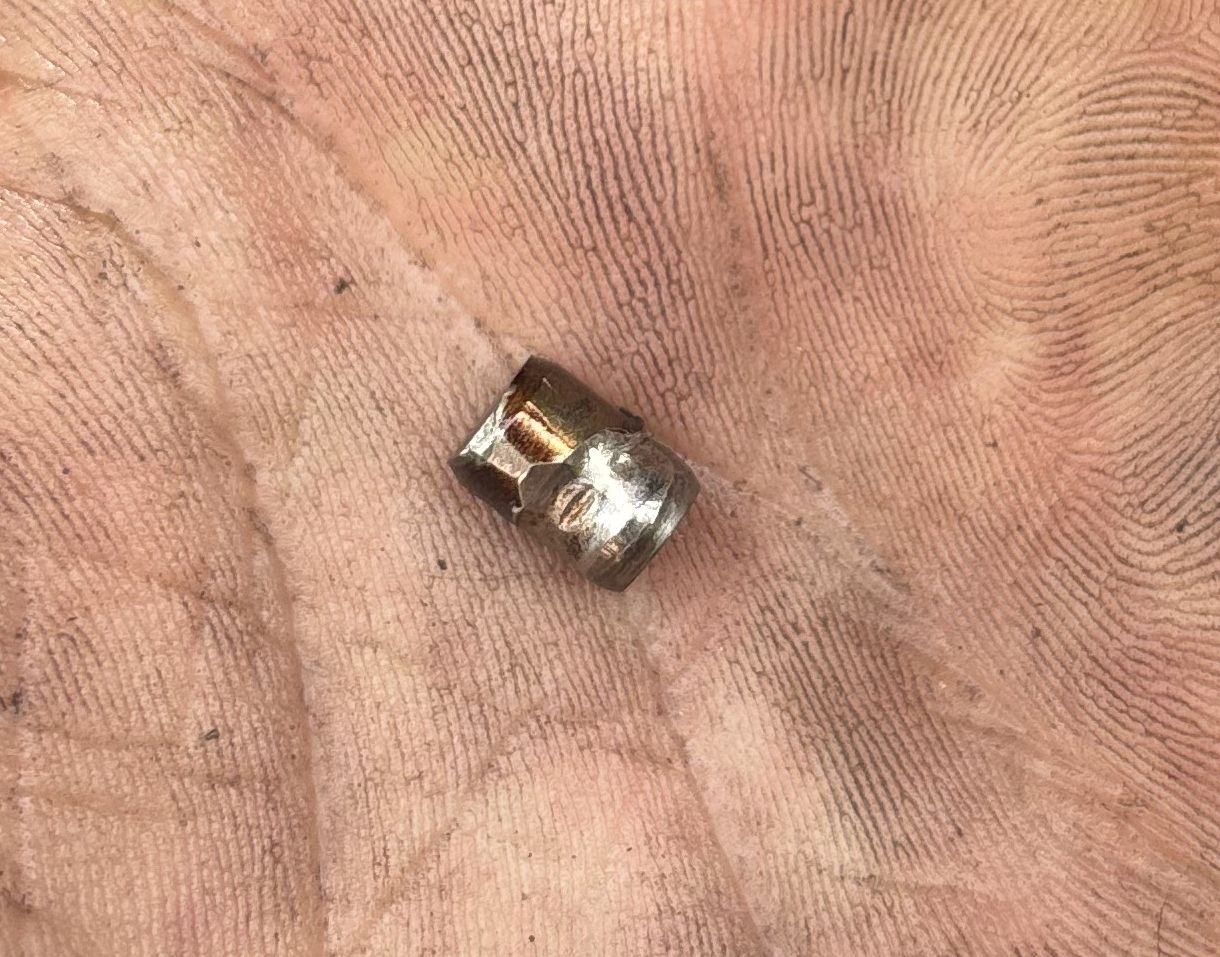

Thanks Ken for your input above, I have forwarded it to my stepson. This is exactly what he was was concerned about, and could actually be the cause of the timing-related codes his truck was throwing. He does feel like when he gets the new pin(s) it will fit tight in the hole as the hole is not too badly worn at the bottom. The old pin shown here is fairly worn.

Update... My stepson used some extreme temperature epoxy to fill in the small (wallard) gap in the crankshaft hole that holds the pin, not sure how permanent this will be. The new pin fit very tight. He got the engine back together and after all the work including the new timing chain and guides etc. he fired it up and test drove it for an hour, he stated it ran perfect!
He will not attempt replacing the crankshaft if ultimately that is needed so hopefully the engine will run good for at least a while. He gained tremendous experience doing this job so regardless it was not without value. Ken, Thanks for your insights about the problem, it was very helpful.
