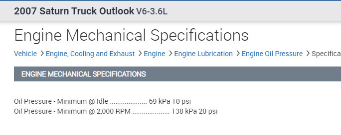

What led to having the person replace rockers and lifters? Also, were any of these codes present prior to the repairs?
The codes you have are for both engine banks and not only the one that was originally repaired.
Is there any indication that the oil pressure is low? Have you checked it? I attached a pic below showing the minimum pressures required.
Let me know. Also, if you could record the noise and upload it for me to hear, it may help.

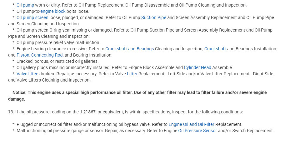

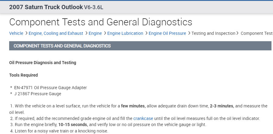

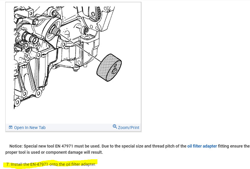

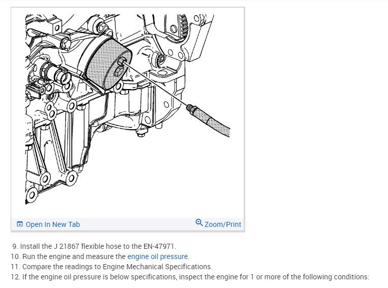

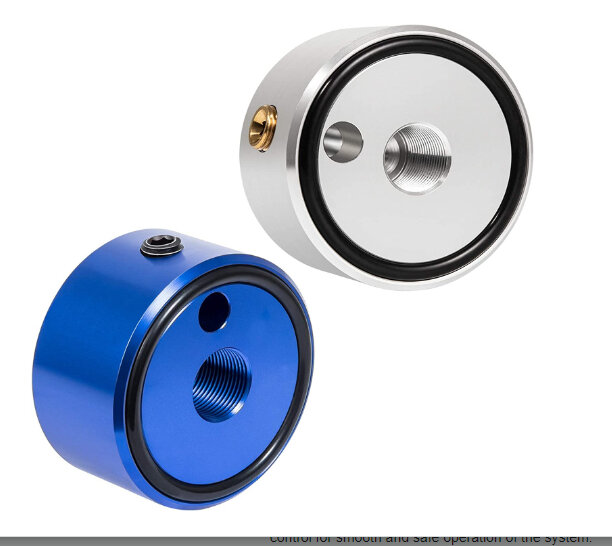

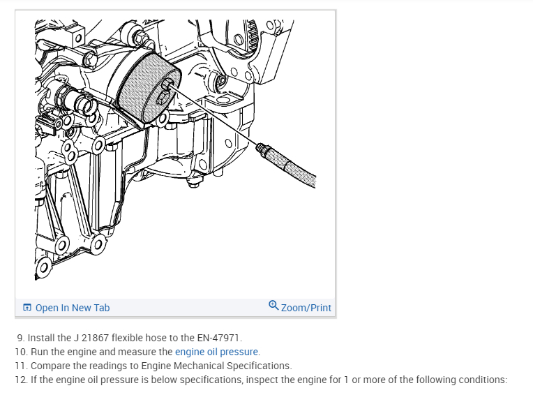

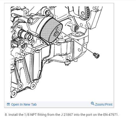

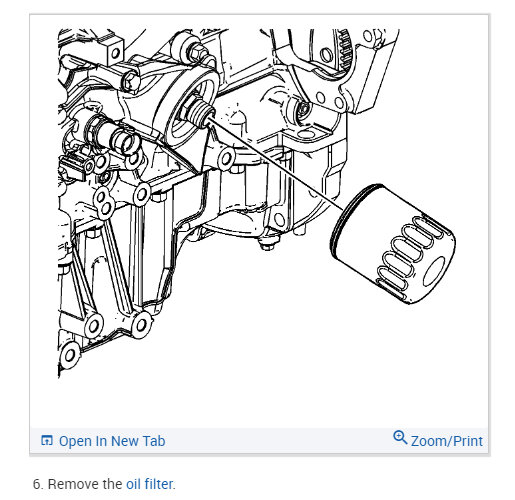

As far as checking oil pressure, there is an adapter that goes in place of the oil filter. See pic 1 below.
In addition, you need an oil pressure gauge. It's actually an easier one to do if you have the tools.
I attached the directions below for you to review.
Let me know if you have questions.,
