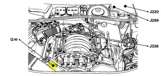

I changed the timing belt and the car starts fine for about five minutes then it starts running rough and the engine light comes on and starts to flash. so I turned the car off I changed the camshaft position sensor, but still the same results. the code i am getting is p1347. help please because I have to move my son's car like three miles so it wont get towed.

First, are you sure you replaced the correct sensor? I attached picture below if its location. Also, confirm the wiring to the sensor is good and not corroded.
The code is for bank 2/incorrect correlation. So I'm wondering of you have a wiring issue or something plugged in wrong.
