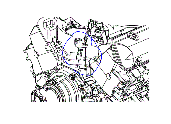

Camshaft location
2011 CHEVROLET IMPALA
189,000 MILES • 3.5L • 6 CYL • 2WD • AUTOMATIC
JOHN GREER
Coded bad camshaft.
Oct 6, 2020 at 8:26 AM
Good afternoon,
Can I have the code number that was set? There is no code for a camshaft. There are codes for camshaft sensors.
https://www.2carpros.com/articles/camshaft-angle-sensor-replacement
Once I know the code, I can help guide you for the diagnostic.
1. Remove the power steering pump. Refer to Power Steering Pump Replacement (LZ4/LZE/LZ9) (See: Power Steering Pump > Removal and Replacement > Power Steering Pump Replacement).
2. Disconnect the camshaft position (CMP) sensor electrical connector.
3. Remove the CMP sensor bolt.
4. Remove the CMP sensor.
5. Inspect the sensor O-ring for wear, cracks, or leakage if the sensor is not being replaced.
