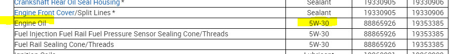

The P05CC is related to the camshaft position actuator. The most common cause of this code is dirty oil, low oil, or the wrong viscosity oil was used. By chance, have you removed the actuators to make sure there is no dirt restricting the oil flow to the
Is the oil clean, full, and 5w30 Dexo oil? (see pic below)
Let me know. Also, let me know if there are any drivability issues.
joe
See pic below.

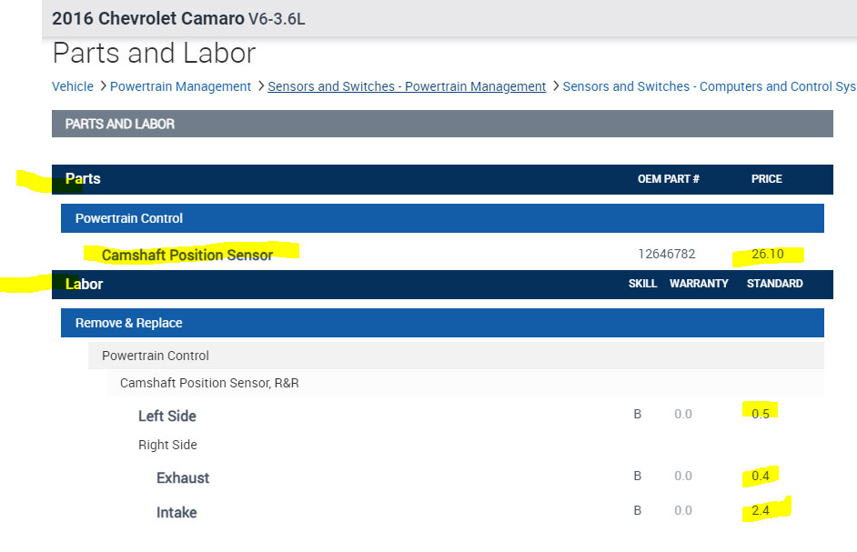

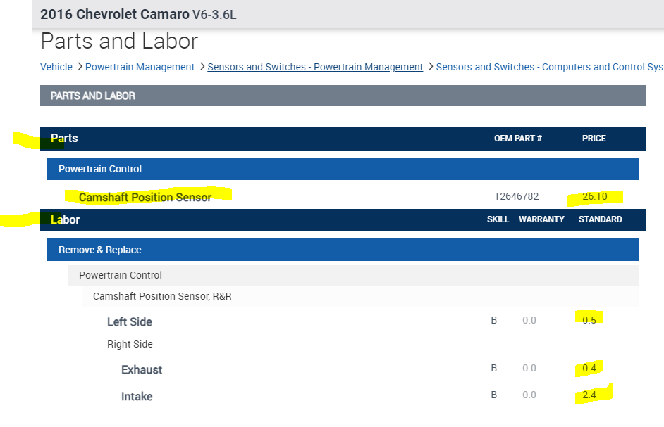

  • 110,244 POSTS
I'm not sure where you are located, but that is way too much. The OEM part is $26.10. There are a total of 4 of them.
Labor is based on which is being replaced. It ranges from 30 minutes up to 2.4 hours. I guess if they charge 300 dollars an hour, they could make it happen. LOL
I attached the parts and labor information for you below. Note: The labor times should be respected and provided by any shop.
Let me know,
joe
See pic below.
Nov 8, 2023 at 10:13 AM
