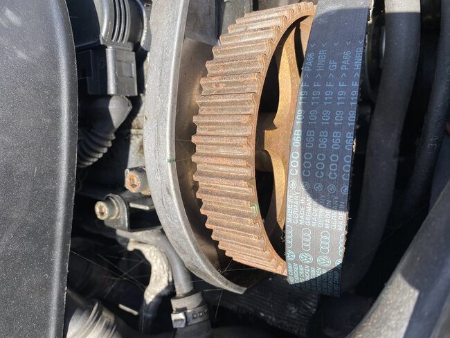

Camshaft is in correct position, but crankshaft is not?
2004 VOLKSWAGEN PASSAT
100,000 MILES • 4 CYL • TURBO • AUTOMATIC
JJ VW PASSAT
  • 5 POSTS

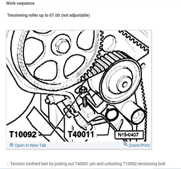

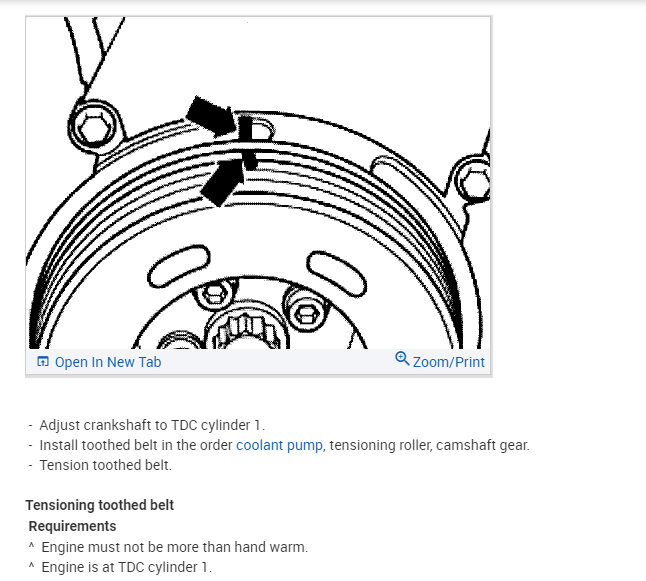

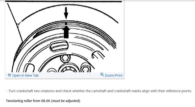

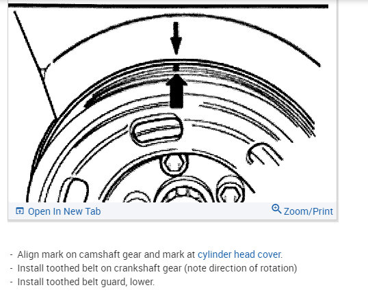

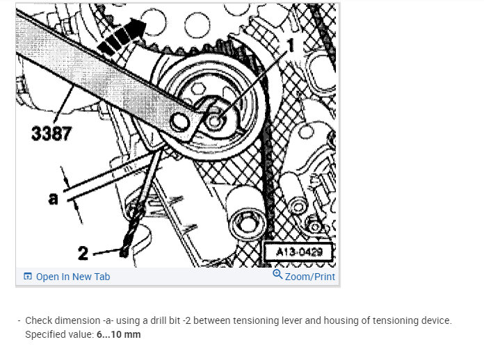

I have the vehicle listed above 1.8t.
The timing belt is partly on meaning, it’s on the crankshaft but not around the camshaft.
How can I correctly align the crankshaft with the camshaft before putting the timing belt on?
Mar 21, 2023 at 11:52 AM
  • 110,240 POSTS

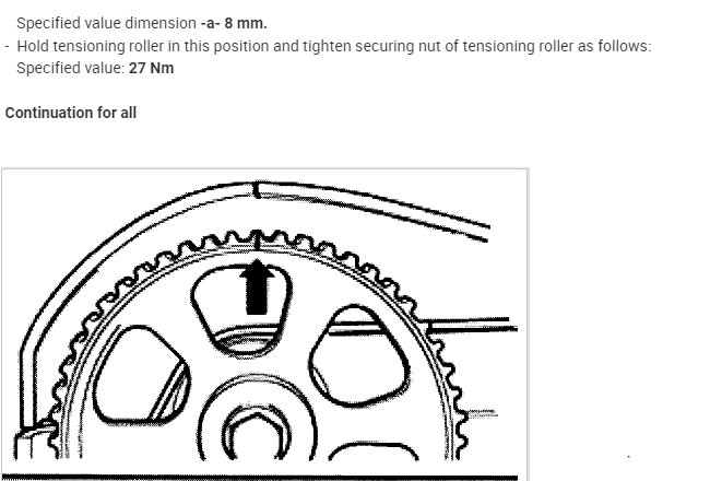

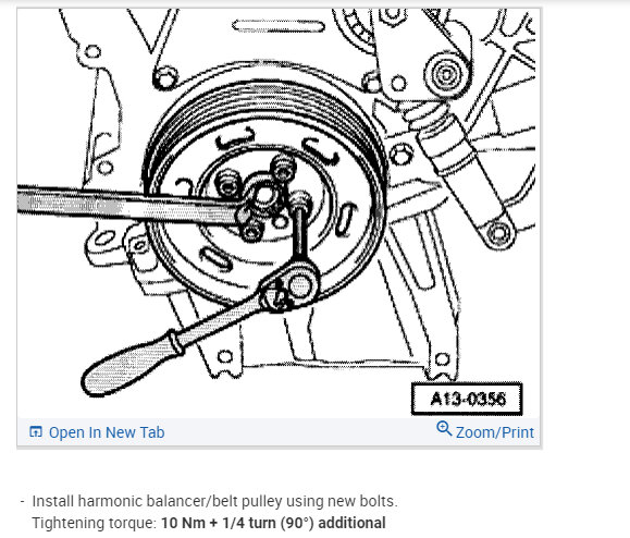

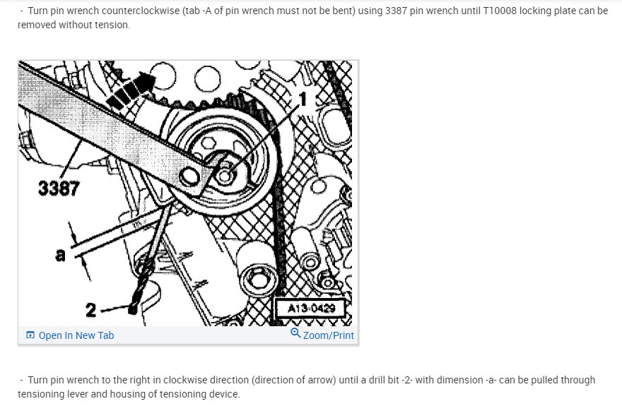

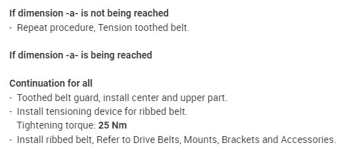

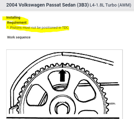

Installing the timing belt requires the following procedure. I attached the directions below. Note there are a few specialized tools shown.

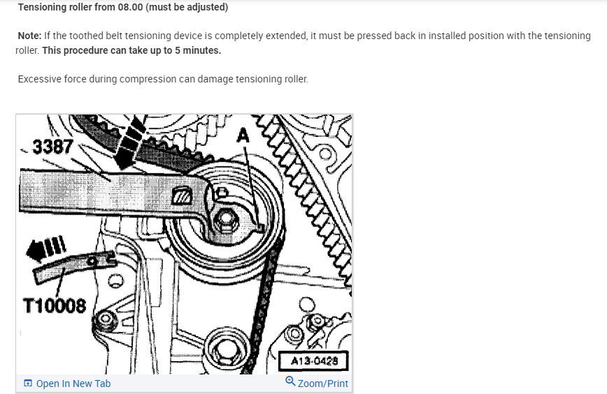

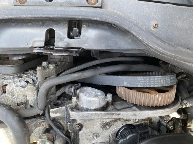

Thank you. This is an example of what I am talking about.
Mar 22, 2023 at 3:52 AM
  • 110,240 POSTS
Do you have the timing belt tensioner released? From what I see in the picture, which is normal unless the tensioner is released.
Take a look at pic 5 above.
Mar 22, 2023 at 11:04 AM
JJ VW PASSAT
  • 5 POSTS
No, the tensioner is not released. I never release the tensioner when I replaced the VVT.

No problem whatsoever and you are very welcome. Let me know if you are able to release the tensioner and get it together. I'm interested in knowing. Also, let me know if I can help in any way.
