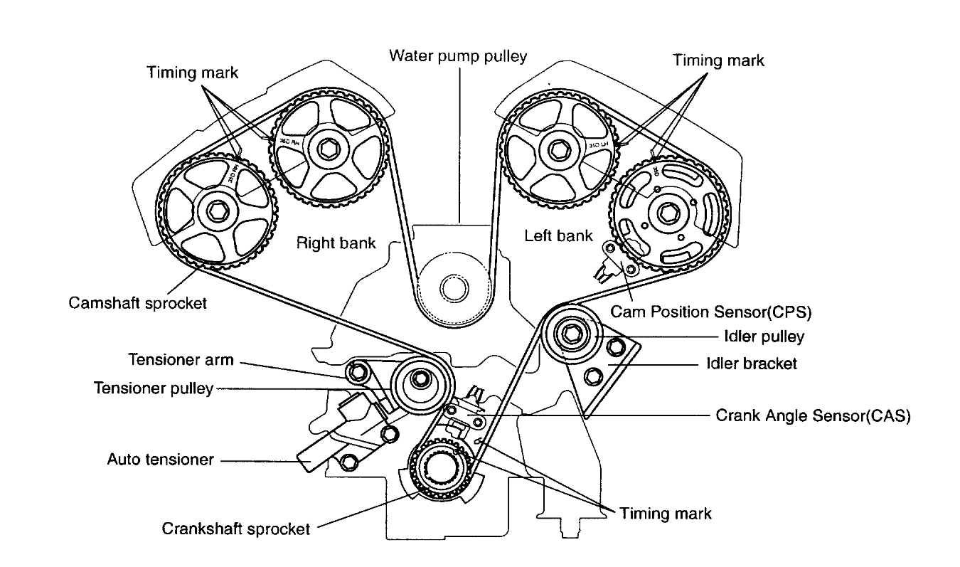

Put number 1 cylinder at TDC and the dow pins are in the wrong place. how do I fix? This will be on the right bank.

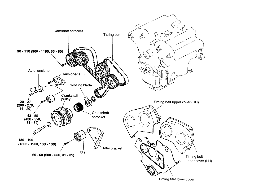

Are they 180 out? you turn the crankshaft one time, and they should line up. If this is not the case, I have found the camshaft and crankshaft timing marks in the diagrams below, also check out the link:
https://www.2carpros.com/diagrams/kia/sorento/2003
