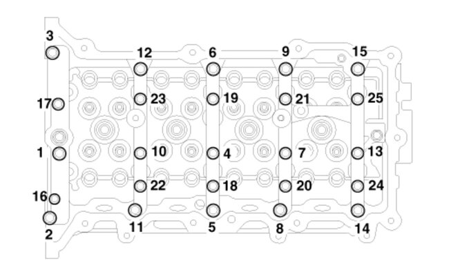

Camshaft cap bolts?

Placement of all the bolts in the carrier and cam caps.

The torque sequence of all the cam caps and the two that hold the carrier down

OK, this is the pattern for that cradle. The bolts get torqued in stages until you reach 10 lbft. on the M6 bolts and 16 lbft. on the M8 bolts. They don't specify the stages just "Torque in multiple passes" My SOP is to verify the cradle is in place then go just snug to be sure that the cradle is in position. Then go to half and then final in the last step.
You can see the bolt positions in the diagram.

There are two bolts besides the cap bolts. one on each end of the carrier what about those should I do them first at 16 lb
Jan 23, 2026 at 10:46 PM
BMCREYNOLDS389
  • 30 POSTS
Or should I get you as I'm doing the M8
Jan 23, 2026 at 10:54 PM
BMCREYNOLDS389
  • 30 POSTS
Should I get them in the same sequence that I'm doing the M8
Jan 23, 2026 at 10:55 PM
STEVE W.
  • 15,349 POSTS
Those don't really have a torque spec. They are supposed to hold the cradle in place during factory assembly. So 10-16 should be fine.

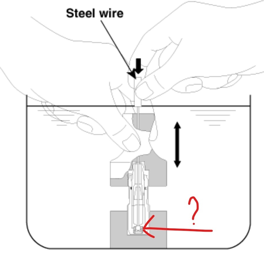

Okay I have to stop I went under the vehicle to check the jack and found a steel ball bearing about the size of a BB laying under. I had done a valve job and have the head already own and torque them was going to put the cam carrier on and cams then I found this steel ball bearing would you happen to know where that might have came from?
Jan 24, 2026 at 1:07 AM
BMCREYNOLDS389
  • 30 POSTS
I'll send you a picture if I can figure out how
Jan 24, 2026 at 1:10 AM
BMCREYNOLDS389
  • 30 POSTS
I can't go any further if I have to pull this head back off well I won't be a happy camper LOL
Jan 24, 2026 at 1:17 AM
STEVE W.
  • 15,349 POSTS
OK, you had the head off and the timing components off. The only internal item I can think of that uses a small bearing is a lash adjuster check ball. Or one of the external items that uses a ball bearing, like a tensioner or idler. What other work was done?

Don't suppose you have the broken rocker or a picture of it? I would say it came from one of the broken parts and just fell there. Like I said earlier there are not a lot of that style part in there so if you had a lifter and that you replaced that is likely where it came from. I would fill it with oil and see what it does. If it did come from a rocker it will be obvious as soon as it starts. That is a common failure on that design of lifter, happens in the GM, Chryslers and Fords as well as Kia and Hyundai that use the small roller rockers under the cam.

The rocker arm has a roller wheel on it it busted and the needle bearings came out of it I went out and had a look at the rocker arm and nothing else was broke but that little wheel. I pushed down on each lifter. And they were all solid I mean I could not push any of them down. I will go out tomorrow and pull them all out and expect each one individually I don't know what else to do all I find out is that there are three places in the head that a ball bearings were pressed in from the factory I can inspect them also and I don't know what else to do. But I think them three balls are bigger more like a quarter inch in diameter do you know of anywhere else a small bearing like that would be pressed in because all my components are intact and no bearing could come out of them it's either a lifter or somewhere else a little silver ball bearing was put in as a check valve somewhere

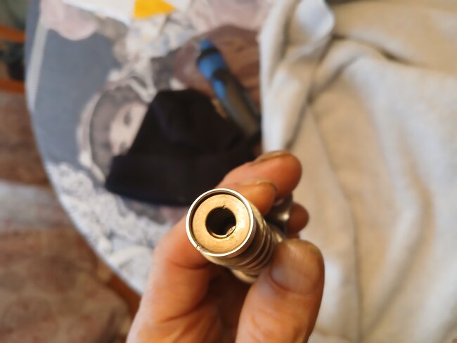

I'm going to send you a picture of the oil control valve can you tell me if it looks right there should be a cap on the end of this valve with a 1/8 still check valve behind it I don't know if that's right or not I'm asking you
Jan 25, 2026 at 3:34 AM
BMCREYNOLDS389
  • 30 POSTS
Is there supposed to be a steel ball in the end of that ocv valve a check valve
Jan 25, 2026 at 3:35 AM
STEVE W.
  • 15,349 POSTS
Should be an open hole with a spring up inside the bore, which it looks like it has. I doubt it is any of the gallery plugs, they are normally in there real good and then the bore gets peened so they cannot get out. I would fill it, prime it and continue on.

The problem is that tracking it down means taking it all apart and looking at every part. That is your call. But none of the pieces that you have checked had anything like that so far. None of the pieces I looked at in the parts listing has a ball like that in it. What surface are you working on? Concrete? clean shop floor? Look at the tools you used as well. Extensions and ratchets have locking balls in them. What color is it? Is it hardened steel? I would expect any type of check ball to have a retainer and spring or something that holds them in so where is that part? Take a look at the other pieces that you removed as well. Maybe it's something from one of the other external parts.
