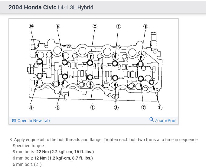

What are the Camshaft cap bolt torque specs?
179,000 MILES • 1.3L • 4 CYL • 2WD • MANUAL
MWEAVER76
Just need the cap torque specs for the camshaft and also rocker arms. please
May 23, 2023 at 9:09 AM
  • 110,246 POSTS
I attached the directions below for torquing the camshaft/rocker assembly. When you do this, make sure to follow the bolt sequence and do it in steps until you reach the required torque.
Let me know if this helps.
See pic below.
