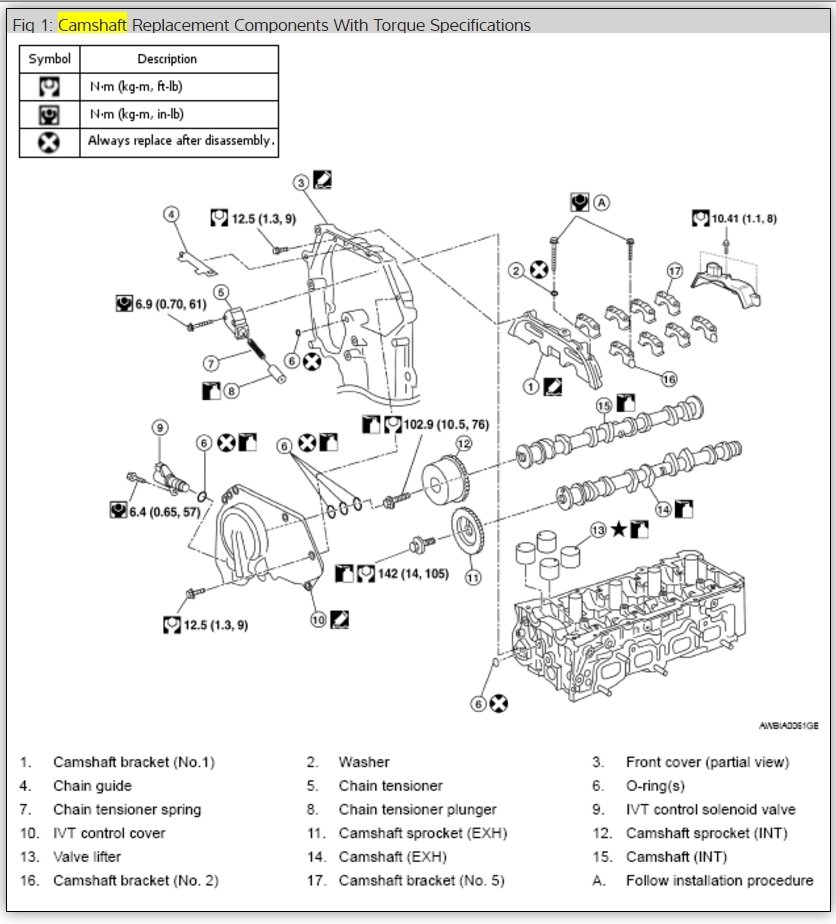

hello
I have removed the Camshaft brackets, and now i do not remember where to put them. Some Camshaft brackets are with numbers and some are with letters, which are on the exhaust side and which are on the intake side?

What are the identification numbers and letters? we do not have your model in the data base, can you advise the engine code for your model as well, cam caps are normally numbered one at the front of the engine two next and so on, inlet is often "I" and exhaust is often "E" do you have this?

It's Nissan Qashqai, with code engine code "H16DE". There are number : 2; 3; 4; 5. And letters : A; B; C; D.

Hi I found this for you, but we don't have the 1.6 liter, do you know the us model?
Please let me know
