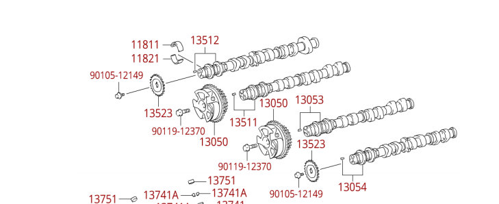

Which camshaft are the camshaft bearings on the truck listed above?

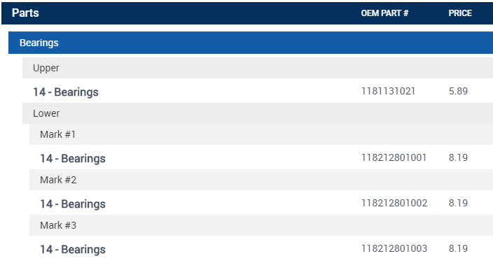

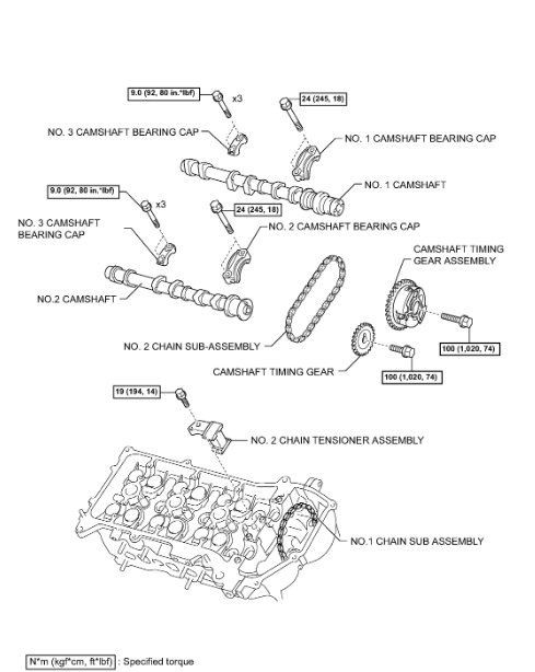

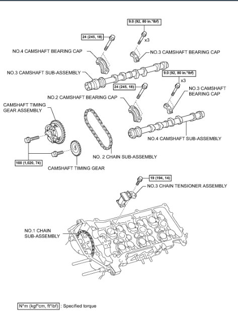

I've attached pictures below.The first picture is bank #1. Second picture is bank #2. Third picture is the Toyota factory camshaft bearing part number and price.Let me know if this is the information you were looking for. Hope this helps and thanks for using 2CarPros.

Hello Danny, hey brother I really appreciate the illustration but it doesn't show which cam on right side (passenger-side) INT OR EXH carries the bearings. Because only one of those does. Thank you

Yes, both the Intake and the exhaust camshafts are retained to the cylinder head with a bearing retainer cap and bearings. Here is another schematic provided by my local Toyota dealer... Hope this helps and thanks again for using 2CarPros.
