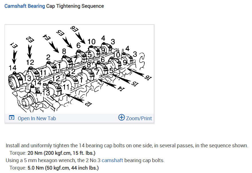

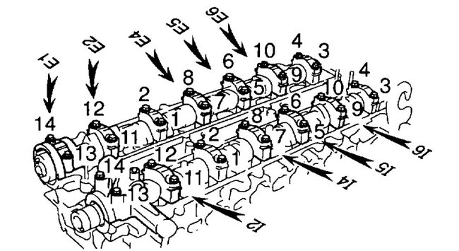

Hello, I want to know how to torque my bolts on my camshaft. Which one goes first and so on. I only loosen them but never took it out. Do I have to correct them before I tighten them. Please let me know? Thanks.
Jan 20, 2019 at 9:59 PM
Good morning,
I attached the procedure and the torque specs for you.
You will need an inch pound torque wrench as well as a foot pound torque wrench that will tighten low torque to 15 lbs.
install and uniformly tighten the 14 bearing cap bolts on one side, in several passes, in the sequence shown.
Torque: 20 Nm (200 kgf.cm, 15 ft. lbs.)
Using a 5 mm hexagon wrench, the 2 No.3 camshaft bearing cap bolts.
Torque: 5.0 Nm (50 kgf.cm, 44 inch lbs.)
Jan 21, 2019 at 1:33 AM
JESSETHEONE
I'm sorry but what are the numbers on the side are for? The E1,E2 etc., and 12,14,15 etc., what do I do with those?
Jan 31, 2019 at 1:04 AM
E is for exhaust and I is for intake.
Jan 31, 2019 at 1:44 AM

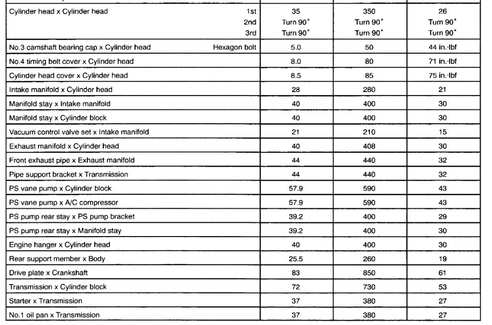

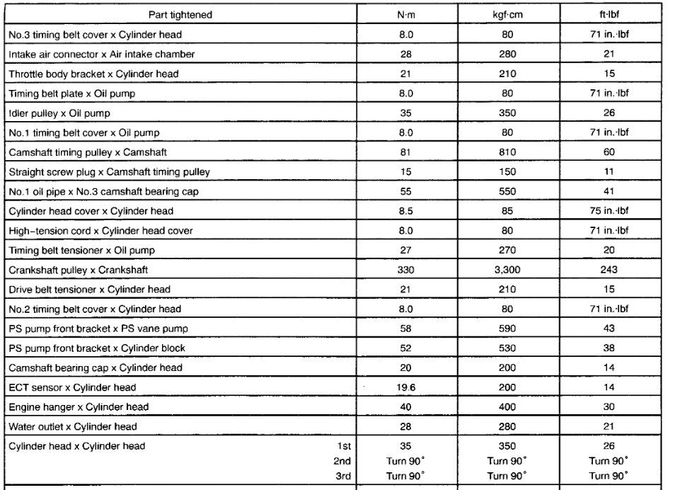

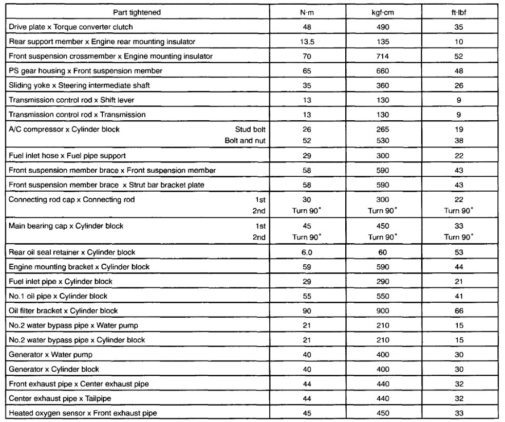

Great thanks a lot. By the chance do you know the torque specs and sequence on the covers for it? Plus I need the exhaust manifold bolts as well too? I'm a d.i.y. guy trying to not to use mechanic because i got ripped off three times for it boss. Thanks for your help.
Feb 11, 2019 at 7:41 AM
Lots of torque specs for you. Check out the images (below). Let us know if you need anything else.
Feb 11, 2019 at 8:35 AM
JESSETHEONE
What number will l use to torque the camshaft mounting bolts?
Apr 15, 2024 at 6:01 PM
  • 54,837 POSTS
Please use this spec sheet below. Check out the images (below).
Apr 16, 2024 at 9:08 AM
