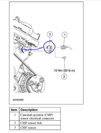

Camshaft bank a positions sensor location?
2007 MERCURY MONTEGO
175,424 MILES • 3.0L • 6 CYL • 2WD • AUTOMATIC
MDP8241
Can’t find bank a cam shaft position sensor in my car to replace
Feb 2, 2026 at 12:40 PM
  • 110,194 POSTS
Hi:

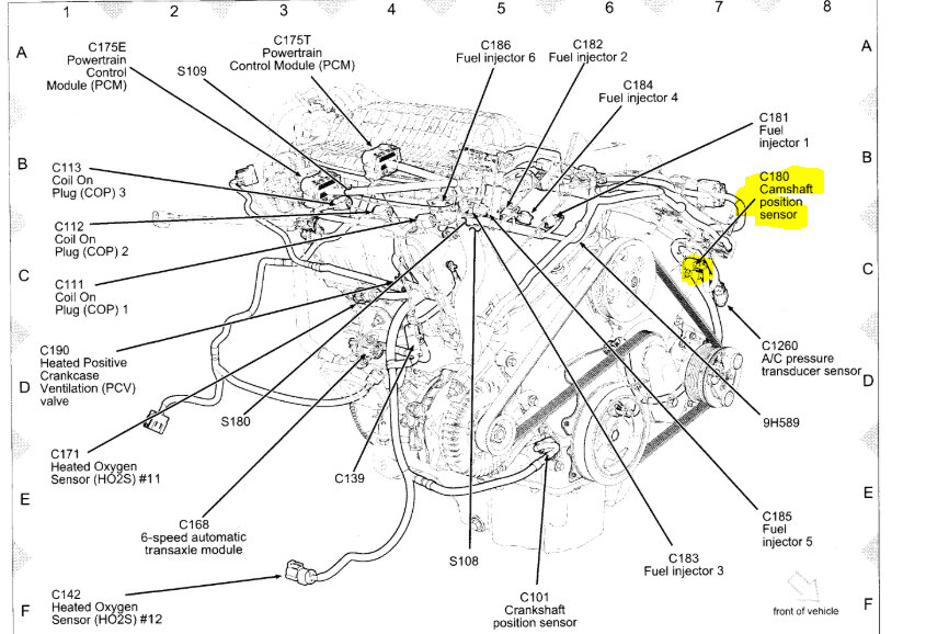

I believe there is only one sensor on this vehicle. It should be located on the front of the cylinder head.

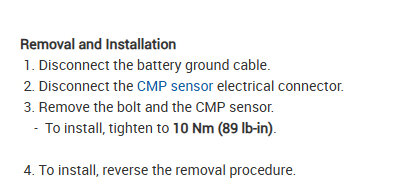

I attached a pic below to help you find it. The last two pics are the directions for replacement. Additionally, here is a link that shows, in general, how one is replaced. You may find it helpful.
https://www.2carpros.com/articles/camshaft-angle-sensor-replacement
Let us know if this helps or if you have other questions.
See pics below
