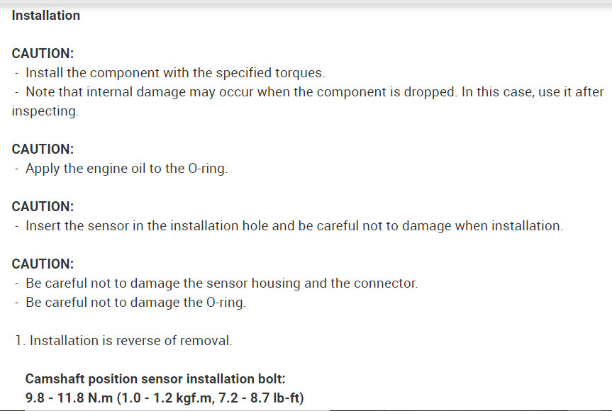

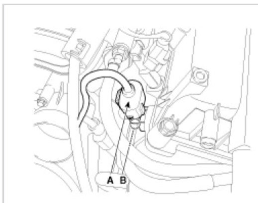

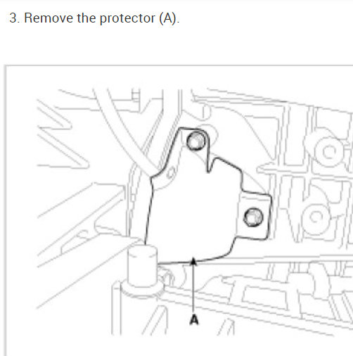

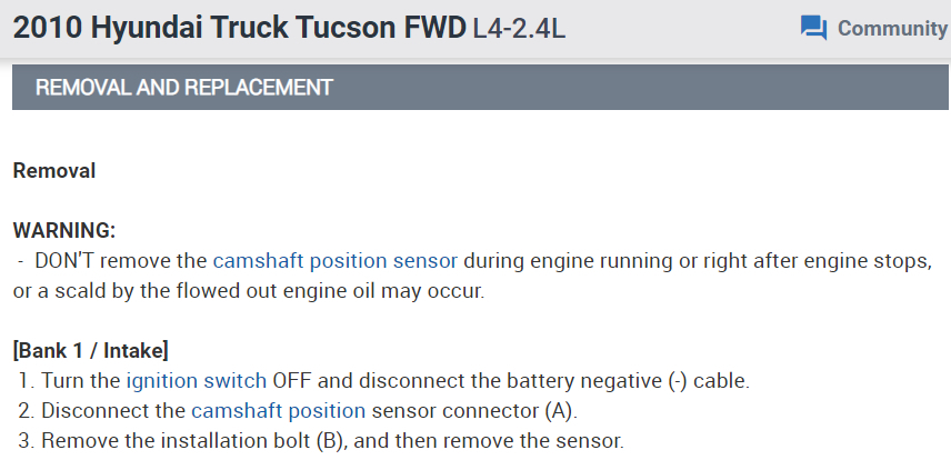

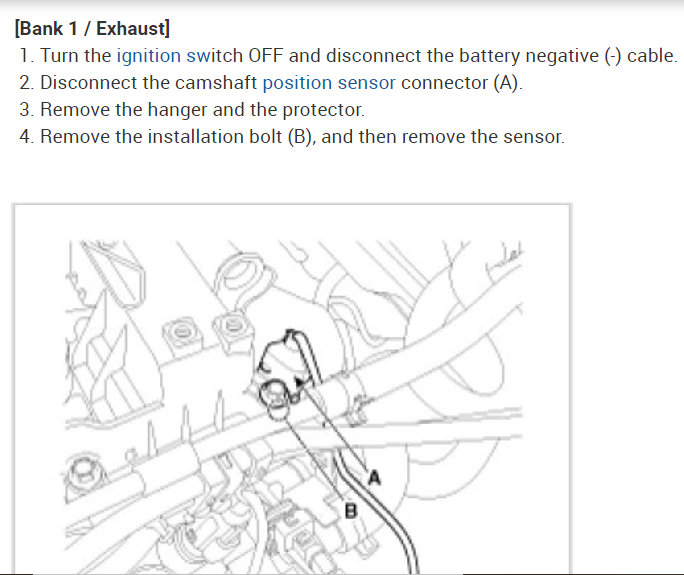

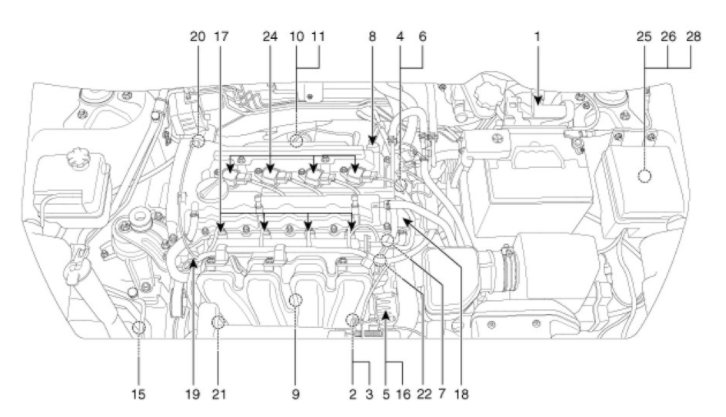

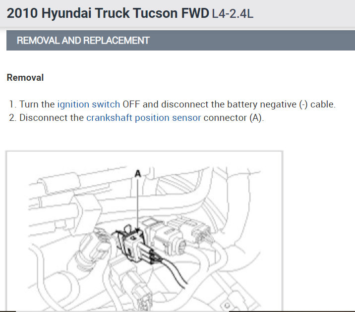

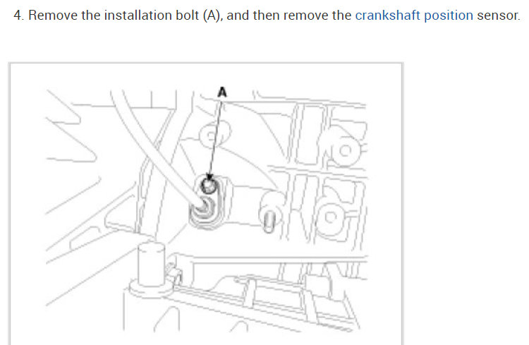

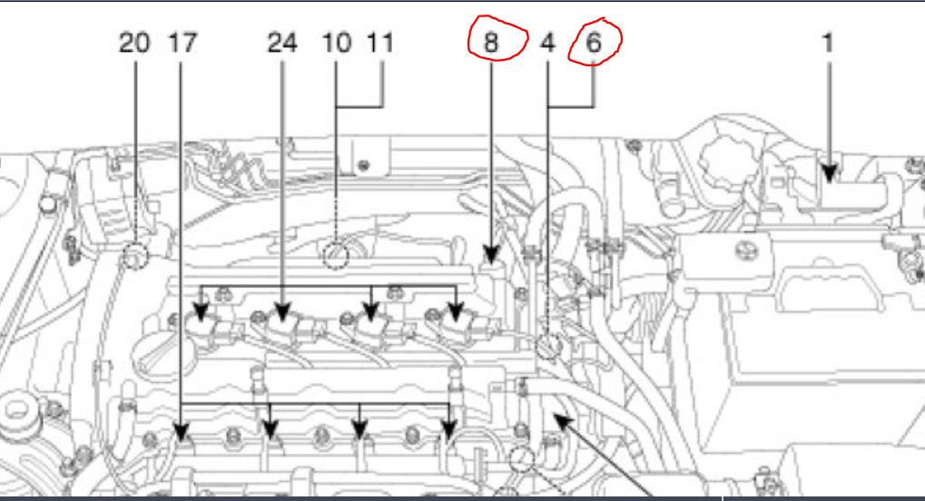

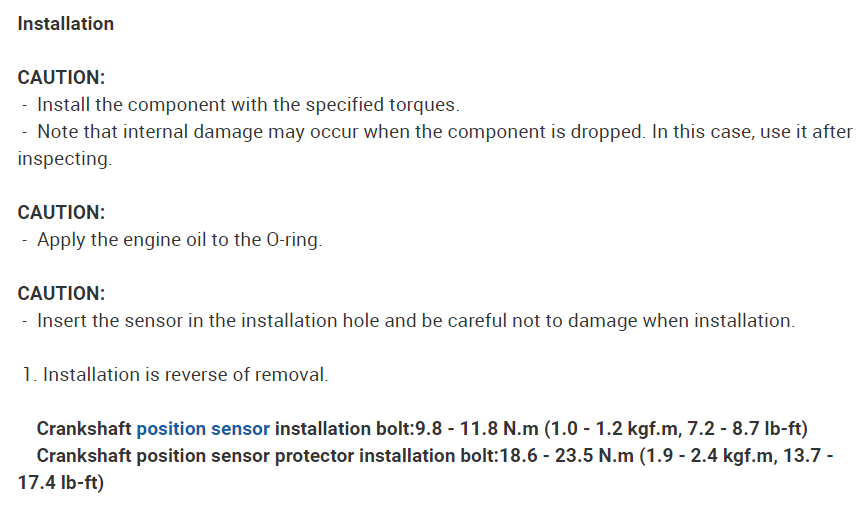

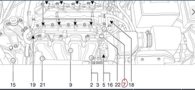

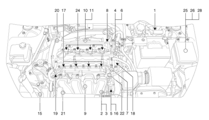

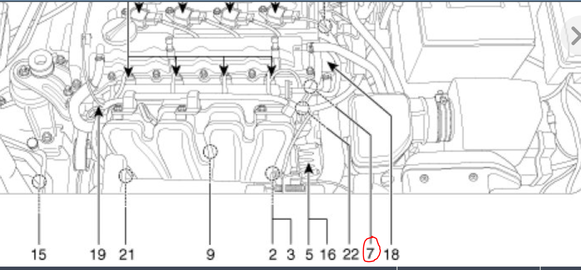

I am looking for the locations of the crankshaft sensor and camshaft sensor in my vehicle. I have been unable to locate accurate engine diagrams or videos that accurately depict the location.
Jan 8, 2021 at 1:03 AM
DANNY L
  • 5,648 POSTS
Hello, I'm Danny.

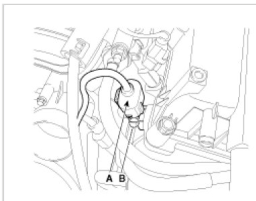

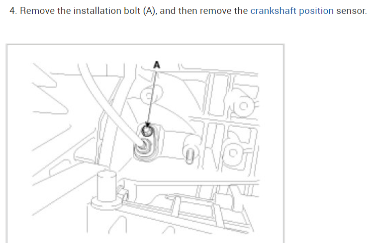

Here is the information you requested. Here are both tutorials for you to view on how to replace both the crankshaft position sensor and both camshaft position sensors:
https://www.2carpros.com/articles/camshaft-angle-sensor-replacement
I've attached picture steps below showing the locations and replacement steps for both camshaft sensors and the crankshaft sensor on your vehicle. Hope this helps and thanks for using 2CarPros.
